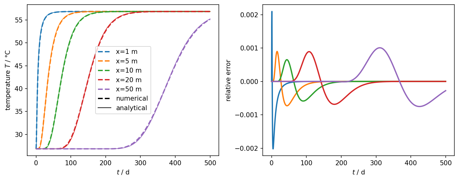

obs_pts = np.asarray([[x, 0, 0] for x in [1, 5, 10, 20, 50]])… (click to toggle)
num_values = ms.probe(obs_pts, "temperature").T
ref_values = [ogata_banks_analytical(ms.timevalues, x) for x in obs_pts[:, 0]]
ms = ms.scale(time=("s", "days"))
time = ms.timevalues
plot_results_errors(time, num_values, ref_values, leg_labels, "$t$ / d")

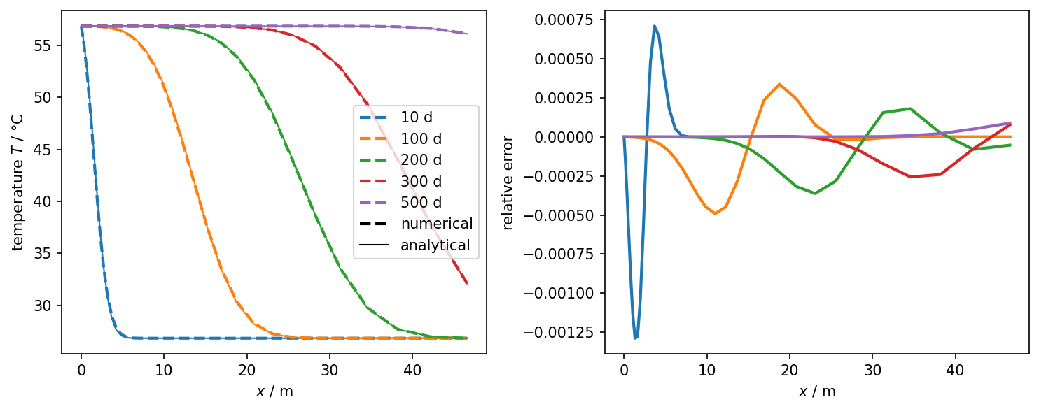

Temperature over x at different timesteps
timevalues = np.asarray([10, 100, 200, 300, 500])… (click to toggle)
all_pts = ms.mesh(0).points
pts = all_pts[(all_pts[:, 0] <= 50) & (all_pts[:, 1] == 0)]
line = pv.PointSet(pts)
num_values = [line.sample(ms.mesh(ts))["temperature"] for ts in timesteps]
ref_values = [ogata_banks_analytical(tv * 86400, pts[:, 0]) for tv in timevalues]
leg_labels = [f"{tv} d" for tv in timevalues]
plot_results_errors(pts[:, 0], num_values, ref_values, leg_labels, "$x$ / m")

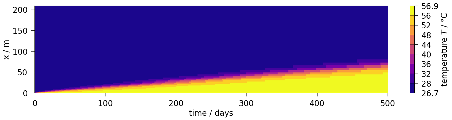

Temperature over time and space
fig = ms.plot_time_slice("time", "x", var, figsize=(20, 4), fontsize=20)
/var/lib/gitlab-runner/builds/vZ6vnZiU/0/ogs/build/release-all/.venv/lib/python3.13/site-packages/ogstools/meshlib/mesh_series.py:910: UserWarning: The input coordinates to pcolormesh are interpreted as cell centers, but are not monotonically increasing or decreasing. This may lead to incorrectly calculated cell edges, in which case, please supply explicit cell edges to pcolormesh.
  ax.pcolormesh(x_vals, y_vals, values, cmap=cmap, norm=norm)
For this discretisation, the numerical solution approximates well to the analytical one. Finer resolutions in the time discretisation reduce the deviations considerably. In this benchmark it is easy to see that too coarse resolutions (especially in the time discretisation) yield very plausible results, which can, however, deviate considerably from the exact solution. An analysis of the von Neumann stability criterion is worthwhile here. This criterium demands
