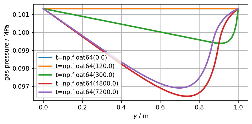

Gas Pressure
plot_sample(ot.variables.Scalar("gas_pressure", "Pa", "MPa"))

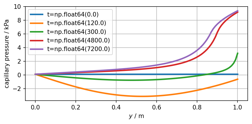

Capillary Pressure
plot_sample(ot.variables.Scalar("capillary_pressure", "Pa", "kPa"))

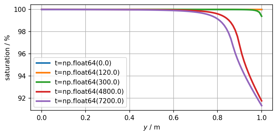

Saturation
plot_sample(ot.variables.Scalar("saturation", "", "%"))

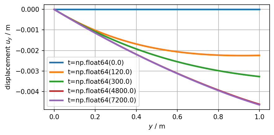

Vertical Displacement
plot_sample(ot.variables.displacement["y"])
