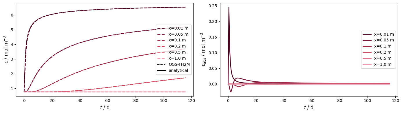

Concentration vs. time at different locations
obs_pts = np.asarray([(x, 0, 0) for x in [0.01, 0.05, 0.1, 0.2, 0.5, 1.0]])… (click to toggle)
num_values = concentration(ms.probe(obs_pts, "xmWL").T)
ref_values = [Diffusion(x, ms.timevalues) for x in obs_pts[:, 0]]
reds = ["#4a001e", "#731331", "#9f2945", "#cc415a", "#e06e85", "#ed9ab0"]
time = ms.timevalues / 3600 / 24
plot_results_errors(time, num_values, ref_values, leg_labels, "$t$ / d", reds)

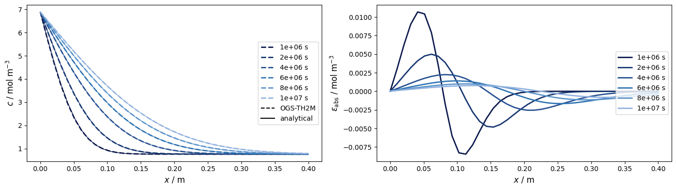

Concentration vs. location at different times
timevalues = np.asarray([1e6, 2e6, 4e6, 6e6, 8e6, 1e7])… (click to toggle)
xs = np.linspace(0, 0.4, 40)
line = pv.PointSet([(x, 0, 0) for x in xs])
num_values = [concentration(line.sample(ms[ts])["xmWL"]) for ts in timesteps]
ref_values = [Diffusion(xs, tv) for tv in timevalues]
leg_labels = [f"{tv:.0e} s" for tv in timevalues]
blues = ["#0b194c", "#163670", "#265191", "#2f74b3", "#5d94cb", "#92b2de"]
plot_results_errors(xs, num_values, ref_values, leg_labels, "$x$ / m", blues)
The numerical approximation approaches the exact solution quite well. Deviations can be reduced if the resolution of the temporal discretisation is increased.

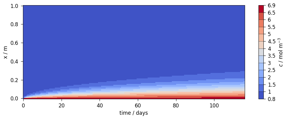

Concentration over time and space
pts = np.linspace([0.0, 0.0, 0.0], [0.3, 0.0, 0.0], 500)… (click to toggle)
var = ot.variables.Scalar("xmWL", func=concentration)
fig = ms.scale(time=("s", "days")).plot_time_slice(
    "time", "x", var, figsize=[10, 4], fontsize=12
fig.axes[1].set_ylabel("$c$ / mol m$^{-3}$")
/var/lib/gitlab-runner/builds/vZ6vnZiU/0/ogs/build/release-all/.venv/lib/python3.13/site-packages/ogstools/meshlib/mesh_series.py:910: UserWarning: The input coordinates to pcolormesh are interpreted as cell centers, but are not monotonically increasing or decreasing. This may lead to incorrectly calculated cell edges, in which case, please supply explicit cell edges to pcolormesh.
  ax.pcolormesh(x_vals, y_vals, values, cmap=cmap, norm=norm)
