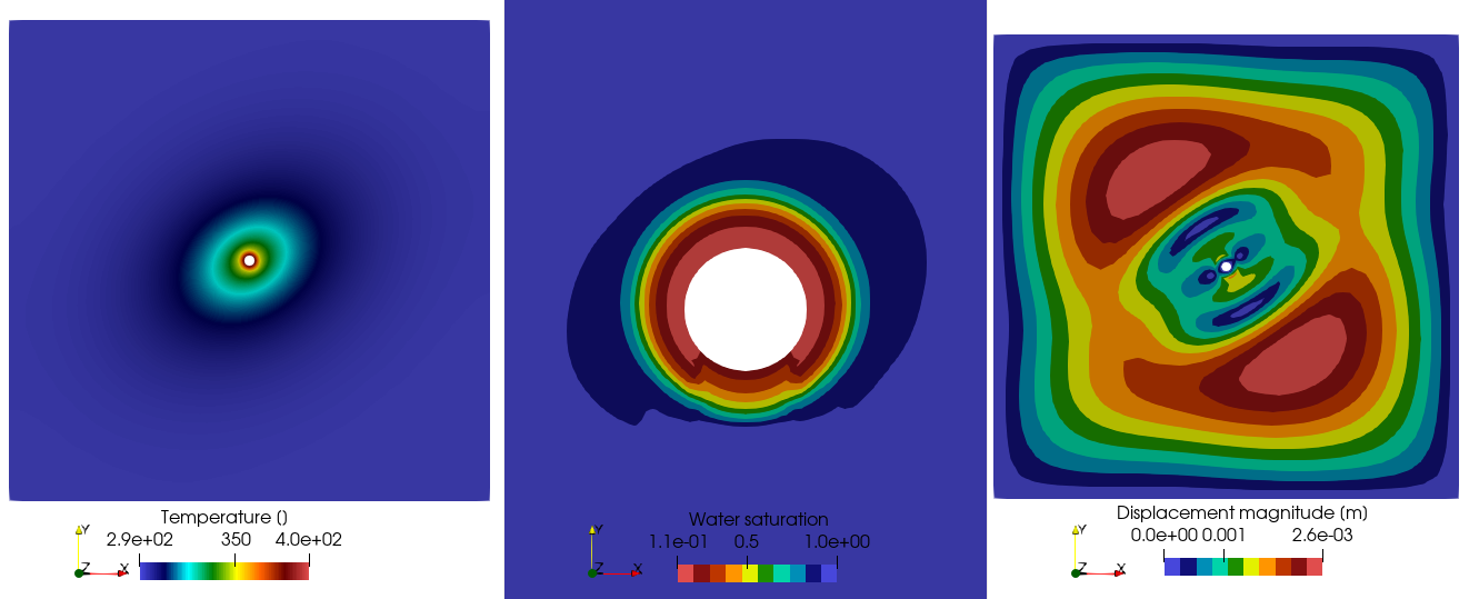

Task C. The following figure shows the distribution of temperature in the domain,
water saturation in the vicinity of the heater, and displacement magnitude
in the domain after nearly 3 years’ heating:

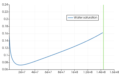

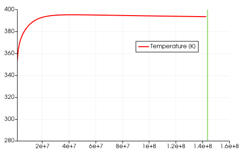

The following two figures show the temporal variations of temperature and water saturation, respectively, at a node near the heater:
As shown the water saturation variation curve, the de-saturation - re-saturation process is well captured by the numerical simulation.
