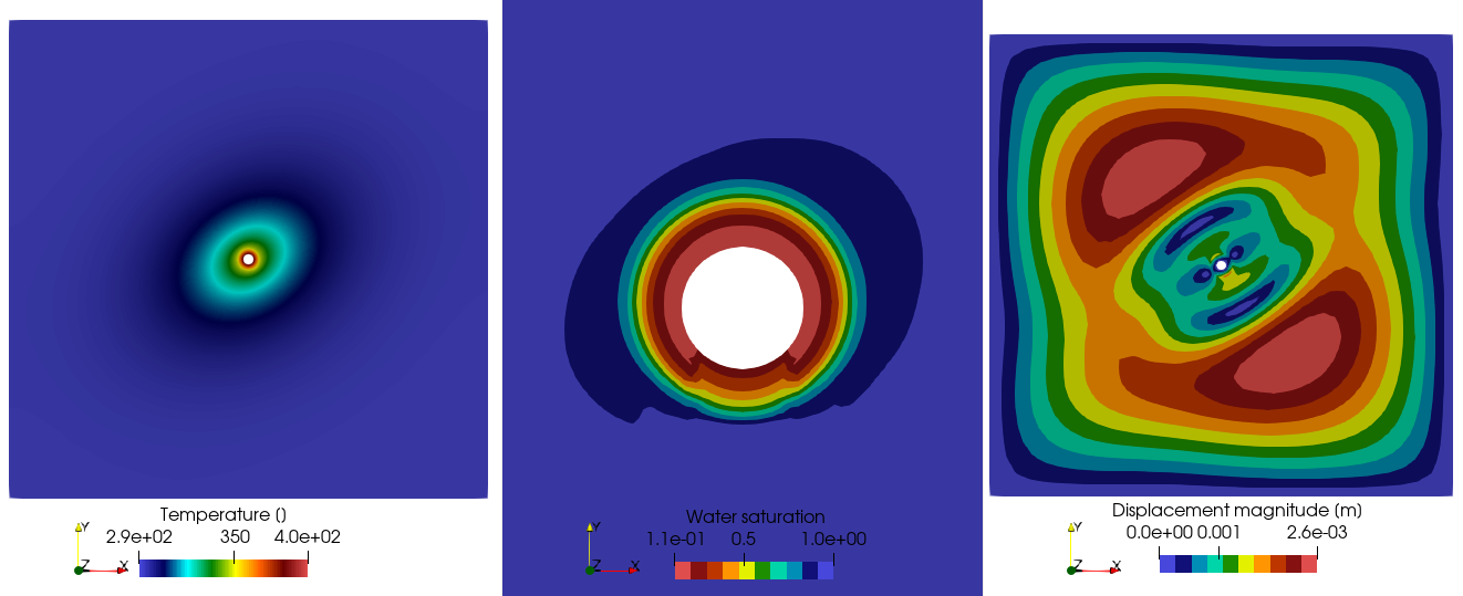

The results obtained are comparable with that obtained by other teams in Task C. The following figure shows the distribution of temperature in the domain, water saturation in the vicinity of the heater, and displacement magnitude in the domain after nearly 3 years’ heating:

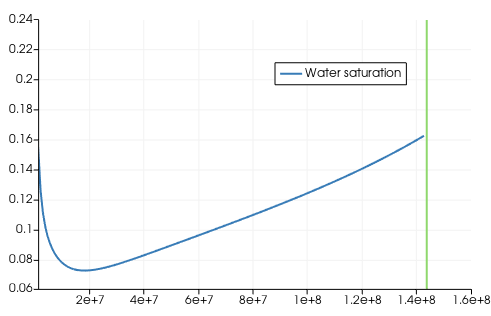

The following two figures show the temporal variations of temperature and water saturation, respectively, at a node near the heater:
drawing drawing
As shown the water saturation variation curve, the de-saturation - re-saturation process is well captured by the numerical simulation.
