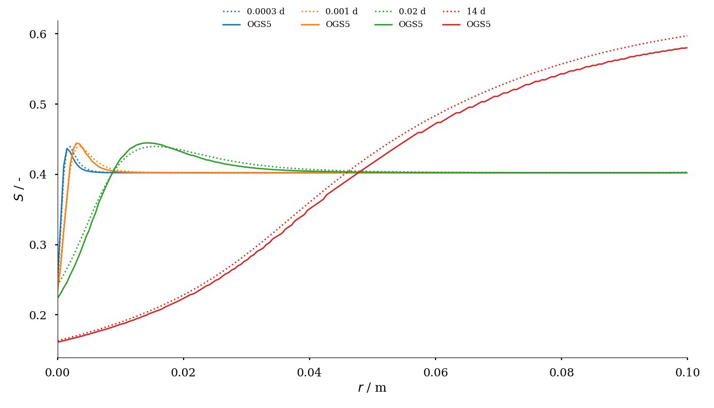

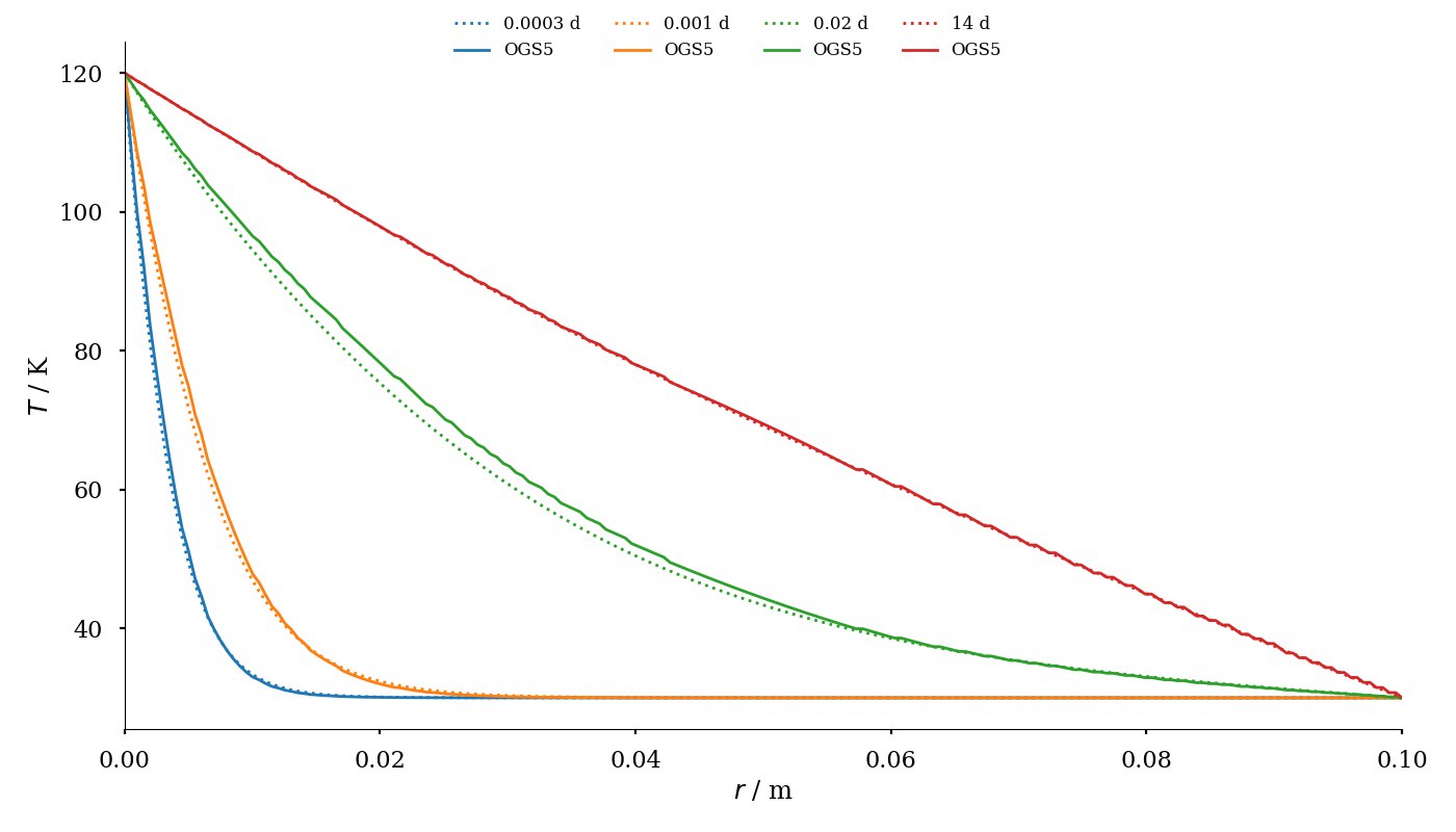

This test simulates the coupled thermal hydraulic processes in In the CTF1 experiment carried out by Villar et al. [1] .
The description of this test can be found in the paper by Wang et al. [2] . In the calculation, the formula of specific heat capacity of solid phase has already taken account of the porosity factor.
The following figures compare the results of this test against the results presented in [2] :
