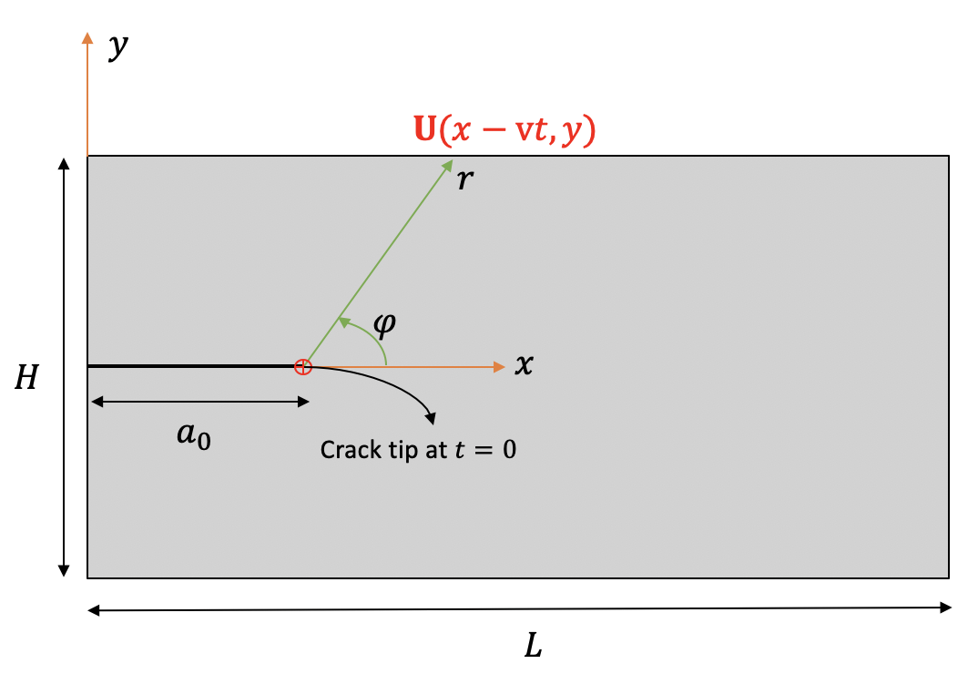

Consider a plate, $\Omega=[0,2]\times [-0.5,0.5]$, with an explicit edge crack, $\Gamma=[0,0.5]\times \{0\}$; that is subjected to a time dependent crack opening displacement:
\begin{eqnarray} \label{eq:surfing_bc} \mathbf{u}(x,y,t)= \mathbf{U}(x-\text{v}t,y) \quad \text{on} \quad \partial\Omega_D, \end{eqnarray} where $\text{v}$ is an imposed loading velocity; and $\mathbf{U}$ is the asymptotic solution for the Mode-I crack opening displacement \begin{eqnarray} \label{eq:asymptotic} U_x= \dfrac{K_I}{2\mu} \sqrt{\dfrac{r}{2\pi}} (\kappa-\cos \varphi) \cos \frac{\varphi}{2}, \nonumber \ U_y= \dfrac{K_I}{2\mu} \sqrt{\dfrac{r}{2\pi}} (\kappa-\cos \varphi) \sin \frac{\varphi}{2}, \end{eqnarray}
where $K_I$ is the stress intensity factor, $\kappa=(3-\nu)/(1+\nu)$ and $\mu=E / 2 (1 + \nu) $; $(r,\varphi)$ are the polar coordinate system, where the origin is crack tip. Also, we used $G_\mathrm{c}=K_{Ic}^2(1-\nu^2)/E$ as the fracture surface energy under plane strain condition. Table 1 lists the material properties and geometry of the numerical model.
Schematic view of surfing boundary condition benchmark
Schematic view of surfing boundary condition benchmark.

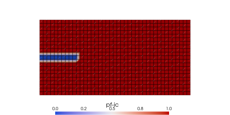

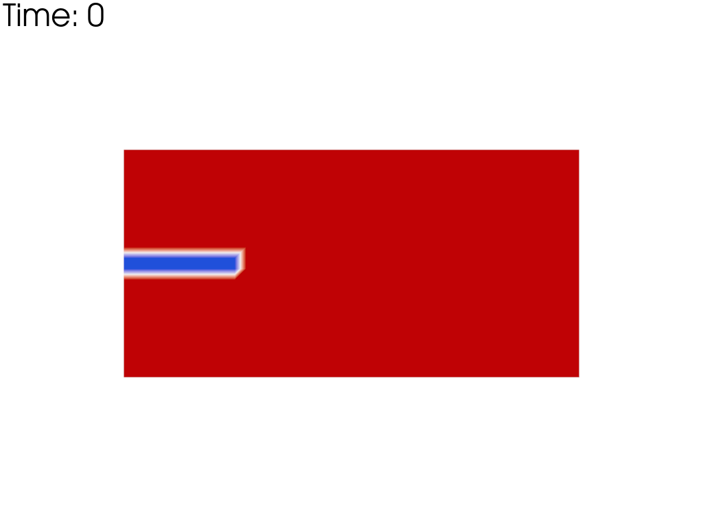

At fracture, we set the initial phase field to zero.
pv.set_plot_theme("document")(click to toggle)
mesh = pv.read(f"{out_dir}/surfing_quad_1x2_NR.vtu")
    if (
        x[0] < x_tip_Initial + h / 10
        and x[1] < Height / 2 + h
        and x[1] > Height / 2 - h
        phase_field[node_id] = 0.0
mesh.point_data["pf-ic"] = phase_field
mesh.save(f"{out_dir}/surfing_quad_1x2_NR_pf_ic.vtu")
pf_ic = mesh.point_data["pf-ic"]
sargs = {
    "title": "pf-ic",
    "title_font_size": 20,
    "label_font_size": 15,
    "n_labels": 5,
    "position_x": 0.24,
    "position_y": 0.0,
    "fmt": "%.1f",
    "width": 0.5,
clim = [0, 1.0]
p.add_mesh(
    mesh,
    scalars=pf_ic,
    show_edges=True,
    show_scalar_bar=True,
    colormap="coolwarm",
    clim=clim,
    scalar_bar_args=sargs,
p.view_xy()
p.camera.zoom(1.5)
p.window_size = [800, 400]
p.show()

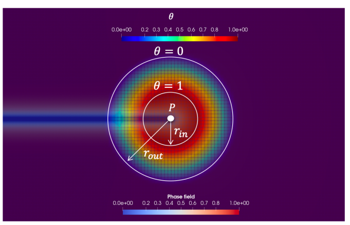

We computed the energy release rate using $G_{\theta}$ method (Destuynder et al., 1983; Li et al., 2016) and plot the errors against the theoretical numerical toughness i.e. $(G_c^{\text{eff}})_{\texttt{num}}=G_c(1+\frac{h}{2\ell})$ for $\texttt{AT}_2$, and $(G_c^{\text{eff}})_{\texttt{num}}=G_c(1+\frac{3h}{8\ell})$ for $\texttt{AT}_1$ (Bourdin et al., 2008).
Alt text
Phase field and $\theta$ profile for the volumetric deviatoric $\texttt{AT}_2$ models. We use virtual perturbation of $\theta$ to compute energy release rate using $G_{\theta}$ Dubois et al., 1998. The $\theta$ value is 1 inside of $B_{r_{in}}(P)$, 0 outside, and a linear interpolation in between. We set $r_{in}=4\ell$ and $r_{out}=2.5r_{in}$ (see Li et al., 2016).
Alt text
R_inn = 4 * ls(click to toggle)
R_inn = 4 * ls
R_out = 2.5 * R_inn
if phasefield_model == "AT1":
    G_eff = G_i * (1 + 3 * h / (8 * ls))
    G_eff = G_i * (1 + h / (2 * ls))

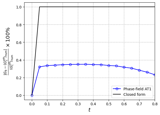

plt.xlabel("$t$", fontsize=14)(click to toggle)
plt.ylabel(
    r"$\frac{|{G}_\mathrm{\theta}-({G}_\mathrm{c}^{\mathrm{eff}})_\mathrm{num}|}{({G}_\mathrm{c}^{\mathrm{eff}})_\mathrm{num}}\times 100\%$",
    fontsize=14,
plt.plot(
    G_theta_time[:, 0],
    abs(G_theta_time[:, 1]) / G_eff,
    "-ob",
    fillstyle="none",
    linewidth=1.5,
    label=f"Phase-field {phasefield_model}",
plt.plot(
    G_theta_time[:, 0],
    np.append(0, np.ones(len(G_theta_time[:, 0]) - 1)),
    "-k",
    fillstyle="none",
    linewidth=1.5,
    label="Closed form",
plt.grid(linestyle="dashed")
plt.xlim(-0.05, 0.8)

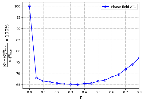

plt.ylabel(
    fontsize=14,
plt.plot(
    G_theta_time[:, 0],
    abs(G_theta_time[:, 1] - G_eff) / G_eff * 100,
    "-ob",
    fillstyle="none",
    linewidth=1.5,
# plt.ylim(0,4)
Hint: Accurate results can be obtained by using the mesh size below 0.02.

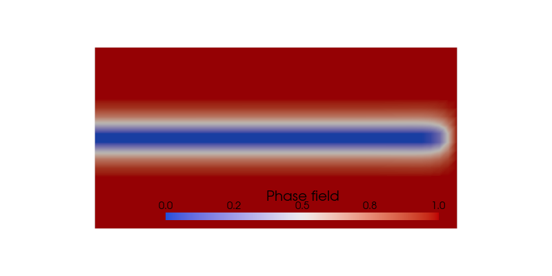

Phase field profile at last time step
mesh = reader.read()[0](click to toggle)
p.add_mesh(
    mesh,
    scalars=pf,
    show_edges=False,
    clim=clim,
p.view_xy()
p.camera.zoom(1.5)
p.show()
