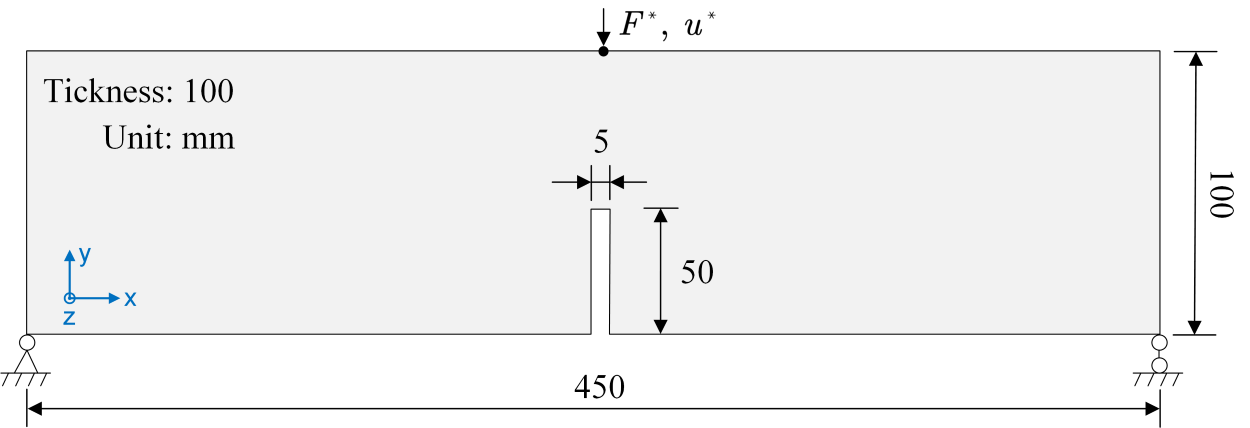

The notched beam under three-point bending is simulated to show how the phase field models can capture crack propagation and the structural strength. The geometry and boundary conditions of the model are depicted below. The bottom left point is fixed on both $x$ and $y$ directions and bottom right point is fixed on the $y$ direction. A displacement boundary condition $u^{\ast}$ is applied on the midpoint of the upper edge. The crack will initiate at the notch tip and propagate upward to the upper edge.
  • Three phase field models are implemented in OGS, i.e., $\texttt{COHESIVE}$, $\texttt{AT}_1$ and $\texttt{AT}_2$.
  • The energy-split models include EffectiveStress, Isotropic and the VolumetricDeviatoric.
  • The softening rules implemented for the $\texttt{COHESIVE}$ model are Linear and Exponential.

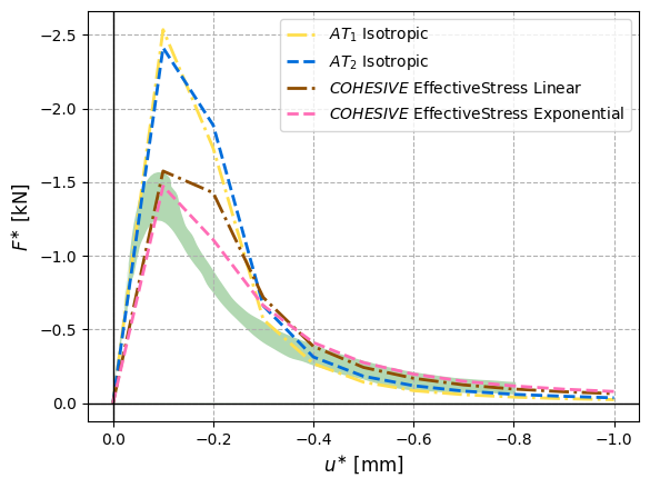

In the following, coarse time steps are chosen for the sake of less computational cost.

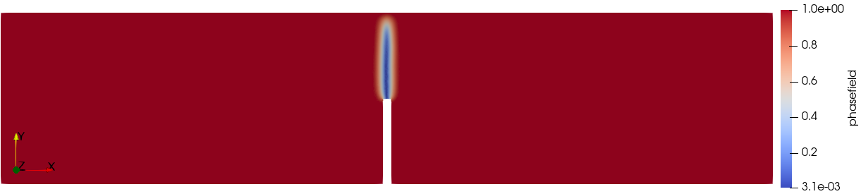

The phase field profile in the final time step of the COHESIVE EffectiveStress case with Exponential softening is shown below.
Phase-field
Phase-field

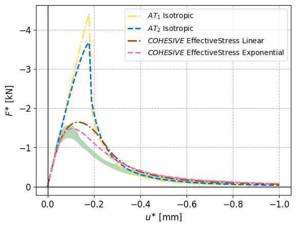

The force-displacement curves ($F^{\ast}$-$u^{\ast}$) applied to the beam are compared.

Running all the selected cases with fine time steps (100 steps) yields the following figure in which the green patch bounds the experimental data. The cohesive models match the experimental results better than $\texttt{AT}_1$ and $\texttt{AT}_2$.
