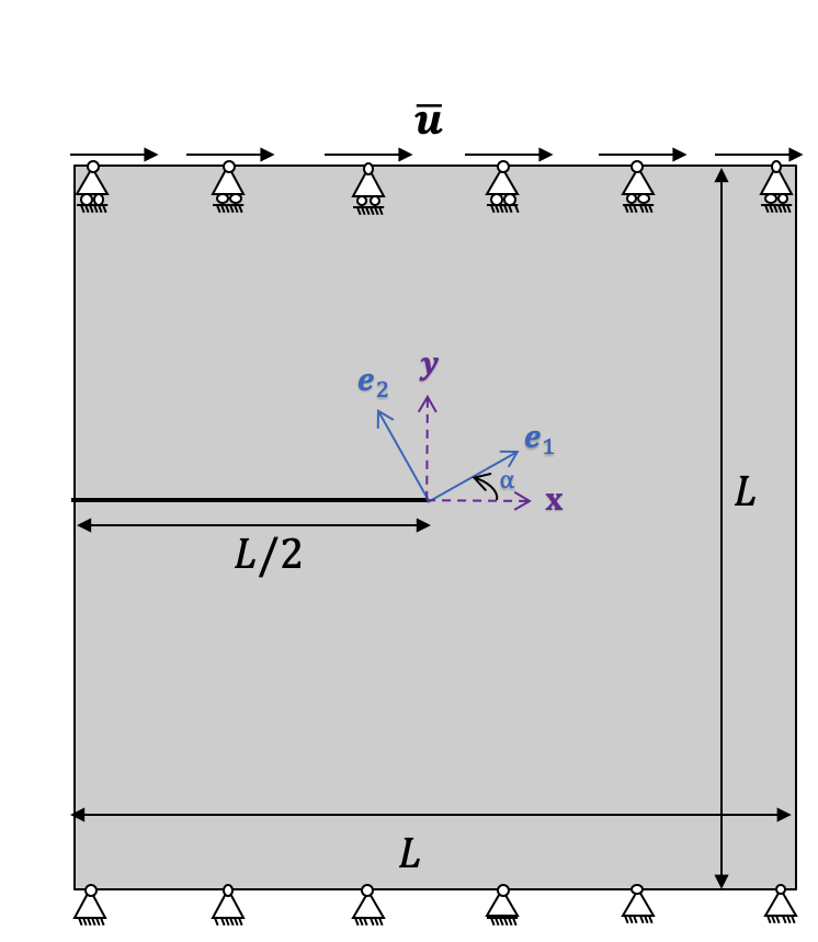

The geometry and boundary conditions for this example is shown in the following Figure.
We consider a square plate with an initial horizontal crack placed at the middle height from the left outer surface to the center of the specimen. Plane strain condition was assumed for sake of less computational costs. The user is free to choose either $\texttt{AT}_1$ or $\texttt{AT}_2$ as for the phase field model.
The boundary conditions are as follows. The displacement along any direction on the bottom edge ($y=-L/2$) was fixed to zero. Also, the displacement at the top edge ($y = L/2$) was prescribed along the $x$-direction, where the $y$-direction was taken to be zero.

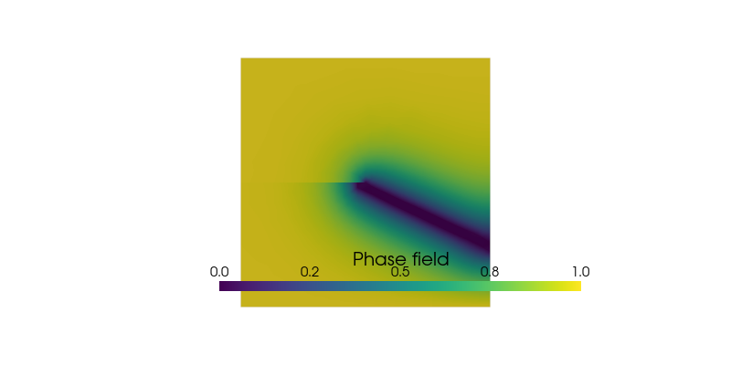

In the following, the crack paths are shown for orthotropic volumetric–deviatoric and {no-tension} models under the shear loading with material orientation angle ($\alpha=0$). The user is free to change $\alpha$ to her desired angle in the prj file.

Phase field contours at the last time step
Also, below shows the phase field contours at the last time step for the orthotropic no-tension model.

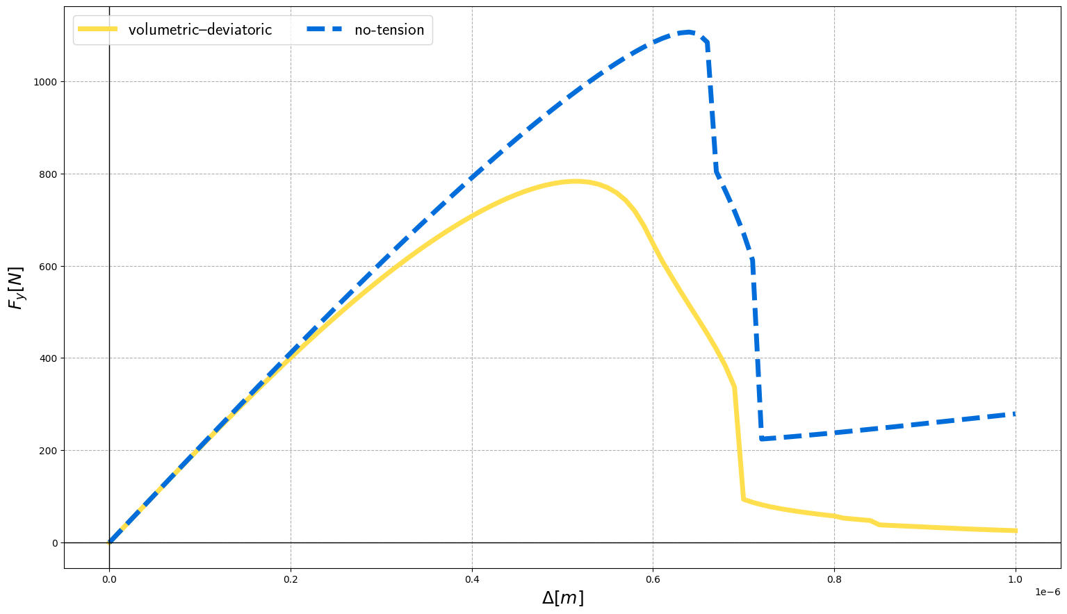

Post-processing
Figures compares the load-deflection curve for both models. As soon as the crack starts to propagate, the load drops.
