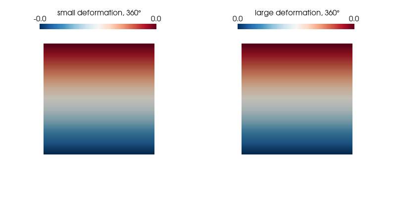

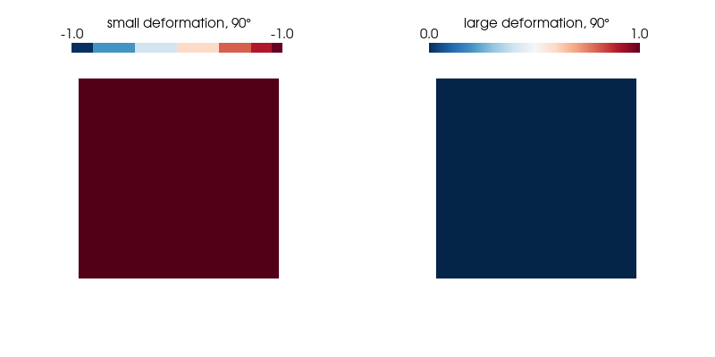

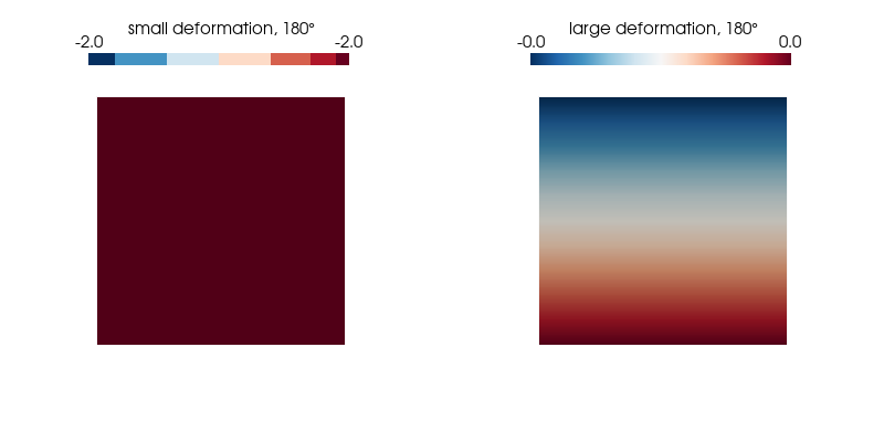

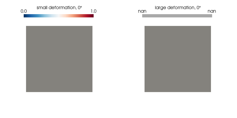

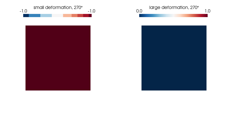

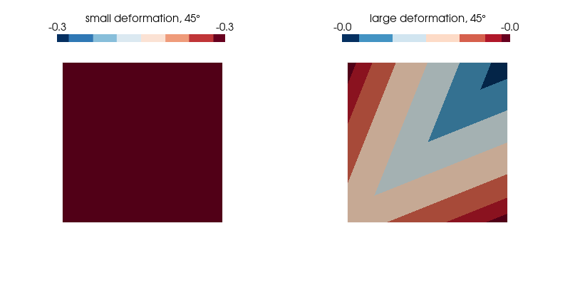

We plot the normal strain in the $x$-direction for both kinematic formulations on the undeformed configuration as it undergoes a 360° rotation and find our expectations confirmed.
ploteps(0, 0)
Expected: 0.00 (small strain) and 0 (large strain)
2025-10-30 14:43:37.612 (   1.254s) [    7F6087281400]vtkXOpenGLRenderWindow.:1416  WARN| bad X server connection. DISPLAY=
/var/lib/gitlab-runner/builds/vZ6vnZiU/0/ogs/build/release-all/.venv/lib/python3.13/site-packages/pyvista/plotting/mapper.py:675: RuntimeWarning: All-NaN axis encountered
  clim = [np.nanmin(scalars), np.nanmax(scalars)]
ploteps(0.5, 45)
Expected: -0.29 (small strain) and 0 (large strain)
ploteps(1, 90)
Expected: -1.00 (small strain) and 0 (large strain)
ploteps(2, 180)
Expected: -2.00 (small strain) and 0 (large strain)
ploteps(3, 270)
ploteps(4, 360)
