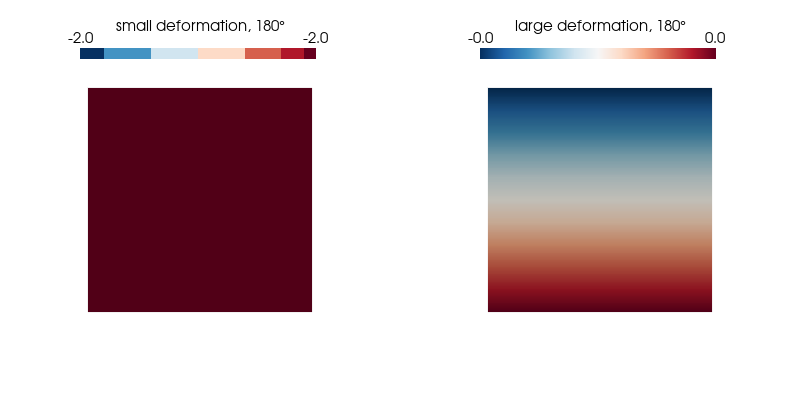

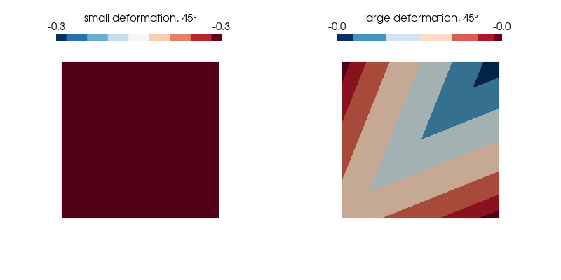

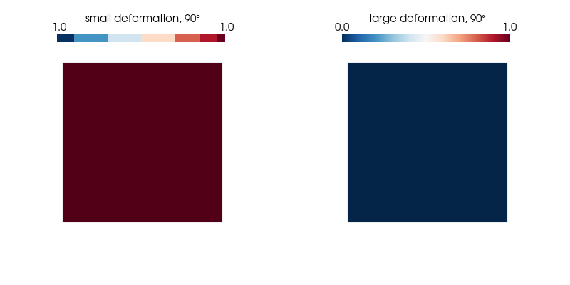

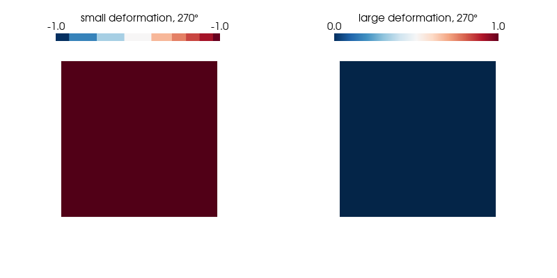

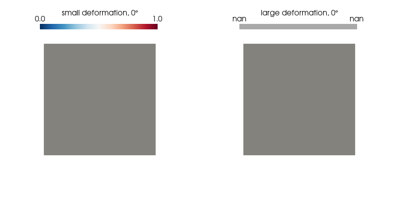

We plot the normal strain in the $x$-direction for both kinematic formulations on the undeformed configuration as it undergoes a 360° rotation and find our expectations confirmed.
ploteps(0, 0)
Expected: 0.00 (small strain) and 0 (large strain)

ploteps(0.5, 45)
Expected: -0.29 (small strain) and 0 (large strain)
ploteps(1, 90)
Expected: -1.00 (small strain) and 0 (large strain)
ploteps(2, 180)
Expected: -2.00 (small strain) and 0 (large strain)
ploteps(3, 270)
