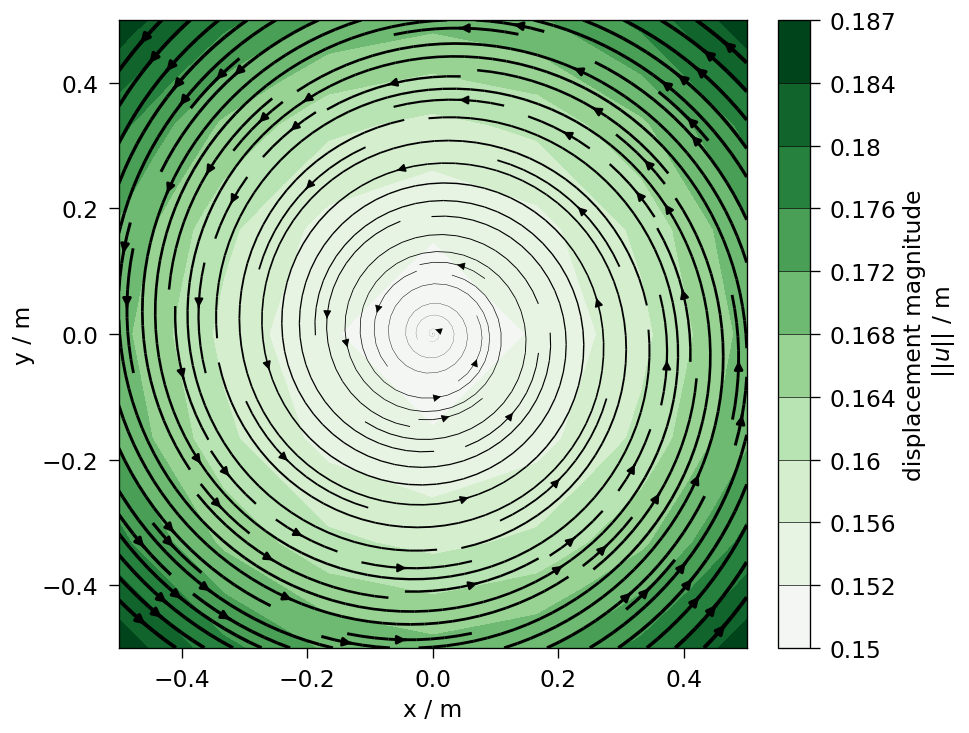

Boundary conditions
The bar of dimensions $1 \times 1 \times 6$ m³ is stretched by $\lambda = 1.5$ in the axial direction and twisted by 180°. The following graph illustrates the torsion bc.
top_pts = mesh.points[:, 2] == mesh.bounds[5]… (click to toggle)
top_surf = mesh.extract_points(top_pts, False, False).delaunay_2d()
fig = ot.plot.contourf(top_surf, ot.variables.displacement, figsize=(8, 6), fontsize=14)

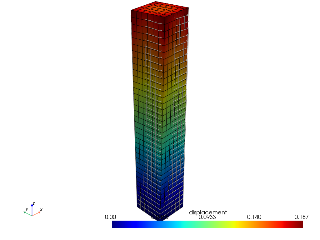

Let’s plot the result.
pl = pv.Plotter()… (click to toggle)
pl = pv.Plotter()
pl.camera_position = (-0.5, -0.5, 0.4)
pl.show_axes()
pl.reset_camera()
pl.show()

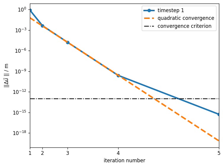

Convergence
What we’re more interested in, is the convergence behaviour over time. The large deformations were applied in only 5 load steps to challenge the algorithm.
log_file_raw = logparser.parse_file(f"{out_dir}/out.txt")… (click to toggle)
log_df = pd.DataFrame(log_file_raw)
for ts in range(1, 6):
    dxs = log_df[log_df["time_step"] == ts]["dx"].dropna().to_numpy()
    slopes = np.log10(dxs)[1:] / np.log10(dxs)[:-1]
    # not checking slope of last ts (below quadratic due to precision limit)
    assert np.all(slopes[:-1] > 1.9)
fig, ax = plt.subplots(dpi=120)… (click to toggle)
ts1_df = log_df[log_df["time_step"] == 1]
its, dxs = ts1_df[["iteration_number", "dx"]].dropna().to_numpy(float).T
ax.plot(its, dxs, "-o", label="timestep 1", lw=3)
offset = 3 - np.log2(-np.log10(dxs[2]))  # to touch the data at dx(it=3)
quad_slope = 10 ** -(2 ** (its - offset))
ax.plot(its, quad_slope, "--C1", lw=3, label="quadratic convergence")
ax.axhline(1e-13, ls="-.", color="k", label="convergence criterion")
ax.set_xscale("function", functions=(lambda x: 2**x, lambda x: np.log10(x - 2)))
ax.set_yscale("log")
ax.set_xlim([1, 5])
ax.set_xticks(its)
ax.set_xlabel("iteration number")
ax.set_ylabel("$|| \\Delta \\vec{u}$ || / m")
ax.legend()
We observe quadratic convergence in the proximity of the solution supporting the implementation of the geometric stiffness matrix. The last iteration converges slightly less then quadratic since we reach the numerical precision limit at this point.
