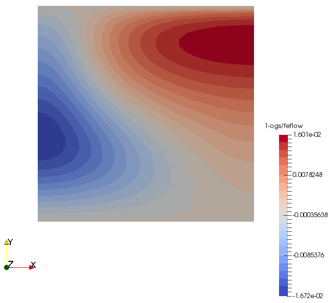

  • The steady state temperature is shown in the following on the right figure. The left figure shows the resulting temperature minus the initial gradient. With the temperature-only density model these temperatures were in good accordance with the FEFLOW results and with results from the OGS version < 6; see the note below the figure for the effect of the pressure dependence.
Comparison with FEFLOW solution
The figure was produced with a temperature-only fluid density model. The pressure dependence added afterwards changes the results, so the figure has not been regenerated and is shown for qualitative comparison only.
