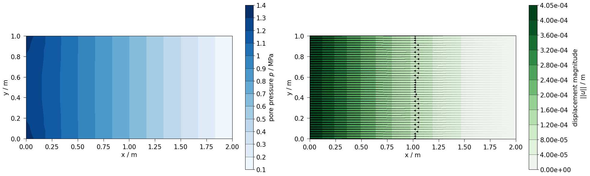

The distributions of pressure and displacement at the end time are shown in the following figure:
# Plotting(click to toggle)
# Plotting
mesh = MeshSeries("HM_NodalSourceTem.pvd").mesh(20)
fig, (ax1, ax2) = plt.subplots(1, 2, figsize=(20, 6))
mesh.plot_contourf(
    ot.variables.pressure.replace(data_name="pressure_interpolated"),
    fig=fig,
    ax=ax1,
    fontsize=15,
mesh.plot_contourf(ot.variables.displacement, fig=fig, ax=ax2, fontsize=15)
plt.subplots_adjust(wspace=0.3)  # increase horizontal space
plt.tight_layout()
