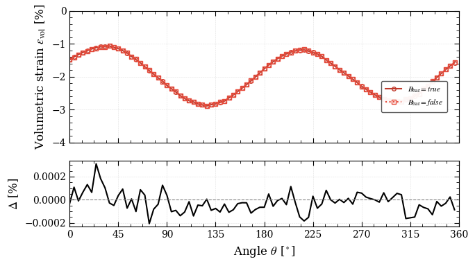

Compare the volume strains obtained with and without the B-bar method
The figure below shows that the B-bar method improves the strain result significantly.

fig, (ax, ax_err) = plt.subplots(
    2, 1, figsize=(7.0, 4.0), sharex=True, gridspec_kw={"height_ratios": [2, 1]}
series = {}
colors = {"true": "#c0392b", "false": "#e74c3c"}
for b_bar in ["true", "false"]:
    angles, eps_v = sorted_angles_eps_trace(f"hm_lie_bbar_{b_bar}.pvd")
    linestyle = {"false": "dotted", "true": "solid"}[b_bar]
    ax.plot(
        angles,
        np.array(eps_v) * 100,
        linestyle=linestyle,
        label=rf"$B_{{\mathrm{{bar}}}} = {b_bar}$",
        marker="o" if b_bar == "true" else "s",
        markersize=4,
        markerfacecolor="none",
        markeredgewidth=1.0,
        color=colors[b_bar],
    series[b_bar] = (angles, eps_v)
ax.set_ylabel(r"Volumetric strain $\varepsilon_{\mathrm{vol}}$ [%]", labelpad=5)
ax.set_xlim(0, 360)
ax.set_ylim(-4, 0)
ax.set_xticks(np.arange(0, 361, 45))
ax.grid(True, which="major", linestyle=":", linewidth=0.4, alpha=0.7)
ax.legend(
    loc="lower right",
    bbox_to_anchor=(0.98, 0.2),
    frameon=True,
    framealpha=0.95,
    edgecolor="0.3",
    borderpad=0.6,
phi_t, y_t = series["true"]
phi_f, y_f = series["false"]
if not np.array_equal(phi_t, phi_f):
    y_f = np.interp(phi_t, phi_f, y_f)
err = y_t - y_f
ax_err.plot(phi_t, err, color="k")
ax_err.axhline(0, linestyle="--", linewidth=0.8, color="gray")
ax_err.set_xlabel(r"Angle $\theta$ [$^\circ$]", labelpad=5)
ax_err.set_ylabel(r"$\Delta$ [%]", labelpad=5)
ax_err.grid(True, which="major", linestyle=":", linewidth=0.4, alpha=0.7)
ax.minorticks_on()
ax.tick_params(which="minor", length=3, width=0.6)
ax.tick_params(which="major", length=5, width=0.8)
ax.tick_params(axis="both", which="both", direction="in", top=True, right=True)
ax_err.minorticks_on()
ax_err.tick_params(which="minor", length=3, width=0.6)
ax_err.tick_params(which="major", length=5, width=0.8)
ax_err.tick_params(axis="both", which="both", direction="in", top=True, right=True)
plt.tight_layout()
plt.savefig("hm_lie_bbar_comparison.pdf", dpi=600, bbox_inches="tight", pad_inches=0.05)
plt.close()

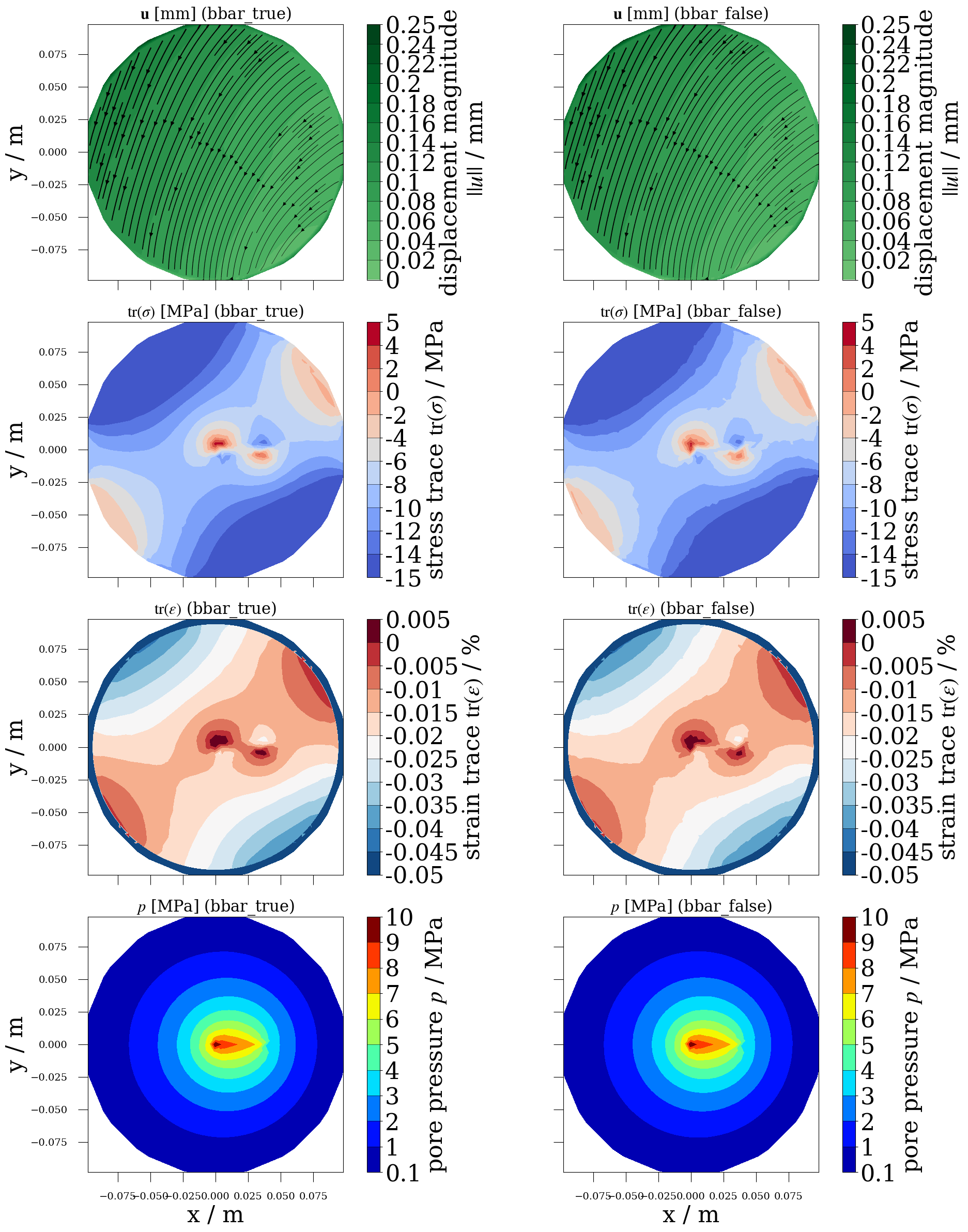

Results over the entire domain
def plot_mesh_compare(… (click to toggle)

colorbar_opts = {
    "u": {"vmin": 0, "vmax": 0.25, "cmap": "Greens"},
    "stress": {"vmin": -15, "vmax": 5, "cmap": "coolwarm"},
    "strain": {"vmin": -0.05, "vmax": 0.005, "cmap": "RdBu_r"},
    "pressure": {"vmin": 0.1, "vmax": 10, "cmap": "jet"},
plot_mesh_compare(
    file_true=Path(out_dir, "hm_lie_bbar_true.pvd"),
    file_false=Path(out_dir, "hm_lie_bbar_false.pvd"),
    colorbar_opts=colorbar_opts,
    save_file=Path(out_dir, "compare_bbar.png"),
Check the the volumetric strain at the specified circle against reference results.
expected_eps_v_bbar_true = np.array([-0.01490984255021392 , -0.013987665076443945, -0.013291145162162097, -0.012657186344186994,… (click to toggle)
 -0.012077562490951627, -0.011593306527156625, -0.011176316797253946, -0.01092569848731069 ,
 -0.01091895899307576 , -0.010714526271895689, -0.01114387725791524 , -0.011504380671698598,
 -0.012092934118127245, -0.012863844099957972, -0.013891307884180757, -0.014824422439206673,
 -0.015842888407653168, -0.01698930615310603 , -0.01820004415291281 , -0.019311361785447873,
 -0.02037186498737685 , -0.021381900264295425, -0.02267022167453655 , -0.023700791466756962,
 -0.024651973931523918, -0.025834316049296095, -0.02665397856513444 , -0.02733189018996455 ,
 -0.02770781423765582 , -0.028345819993573197, -0.028607888986588764, -0.028921395881402683,
 -0.028527748160527878, -0.028321403010593223, -0.02785847219788058 , -0.02744136638137052 ,
 -0.026451557317533896, -0.025586383474529427, -0.024539938245160493, -0.023466049965989697,
 -0.022417380454526133, -0.02129466806681034 , -0.020118766322555316, -0.018890229381819928,
 -0.017632516373885486, -0.01646493848269331 , -0.015464670523898097, -0.014562092590426413,
 -0.013752144407338369, -0.013096148271584786, -0.012564590391080288, -0.012185082706746724,
 -0.01199447428001041 , -0.011893699392594523, -0.012263204688720017, -0.01261592084988576 ,
 -0.013186641784431212, -0.013856951863050332, -0.014948316001225192, -0.01588134762422188 ,
 -0.0168738751033352  , -0.017887279415493056, -0.01882953072448892 , -0.0197989418783354  ,
 -0.020800230539342886, -0.021787442243462178, -0.022928602250839102, -0.02382648570600328 ,
 -0.02473887039251807 , -0.02554854198958239 , -0.026241011041587634, -0.026767411360017812,
 -0.027160336582612497, -0.02742609130243981 , -0.027461460888973104, -0.027588143281204316,
 -0.02706688976921454 , -0.026720468413761987, -0.02598620743929075 , -0.02534338104812332 ,
 -0.023780857548122827, -0.022808214680706176, -0.021565074282019227, -0.02028192599371304 ,
 -0.019043182295690863, -0.017844613487726778, -0.01677439282883159 , -0.01579129577134375 ])  # fmt: skip
eps_v_bbar = sorted_angles_eps_trace("hm_lie_bbar_true.pvd")[1]
np.testing.assert_allclose(
    actual=eps_v_bbar, desired=expected_eps_v_bbar_true, atol=1e-10
