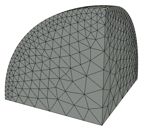

This is a classical example to demonstrate the effect of hydromechanical coupling in a poroelastic medium. For more details we refer to a textbook (Verruijt, 2009), in which also the analytical solution is derived. As domain we consider a sphere, by symmetry we need to simulate only an octant.
Domain Mesh
Mesh

Finite Elements $8741$ Taylor-Hood tetrahedra

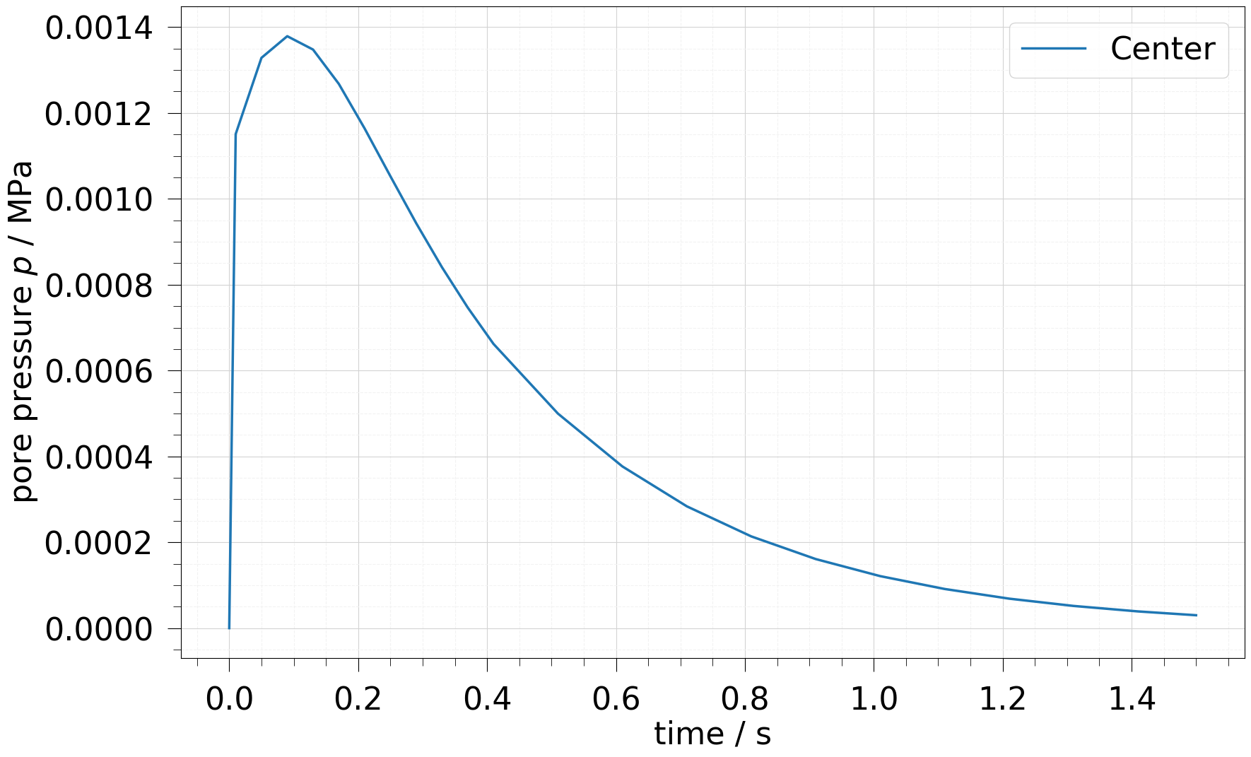

# Load the result
ms = ot.MeshSeries(f"{out_dir}/results_MandelCryerStaggered.pvd")
Available point data in the results:
print(ms[0].point_data.keys())
['displacement', 'epsilon', 'pressure', 'sigma', 'velocity']
# Plot soil temperature at observation points… (click to toggle)
center_point = [0, 0, 0]
ms_pts = ot.MeshSeries.extract_probe(ms, center_point)
fig = ot.plot.line(ms_pts, "time", ot.variables.pressure, labels=["Center"])
/var/lib/gitlab-runner/builds/Sbm-BZZt4/1/ogs/build/release-all/.venv/lib/python3.13/site-packages/pyvista/core/utilities/points.py:77: UserWarning: Points is not a float type. This can cause issues when transforming or applying filters. Casting to ``np.float32``. Disable this by passing ``force_float=False``.
  warnings.warn(
As predicted, the pressure in the center exceeds the applied load and then levels out.
