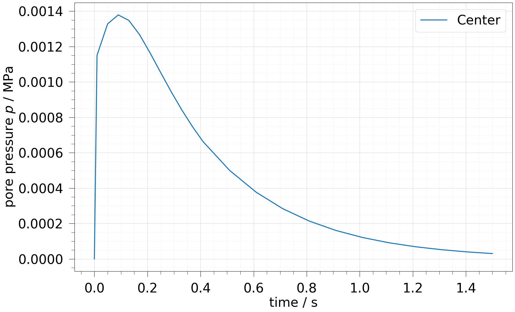

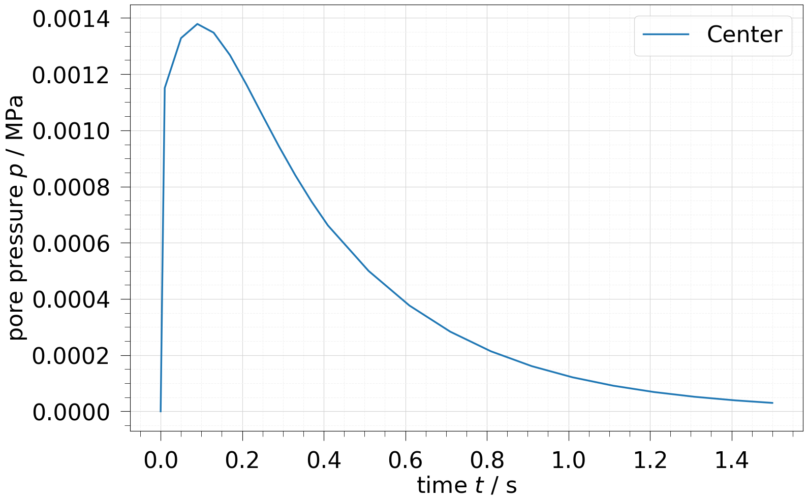

center_point = [0, 0, 0]
ms_pts = ot.MeshSeries.extract_probe(ms, center_point)
fig = ot.plot.line(ms_pts, "time", ot.variables.pressure, labels=["Center"])
/var/lib/gitlab-runner/builds/vZ6vnZiU/0/ogs/build/release-all/.venv/lib/python3.13/site-packages/pyvista/core/utilities/points.py:77: UserWarning: Points is not a float type. This can cause issues when transforming or applying filters. Casting to ``np.float32``. Disable this by passing ``force_float=False``.
  warnings.warn(
As predicted, the pressure in the center exceeds the applied load and then levels out.
