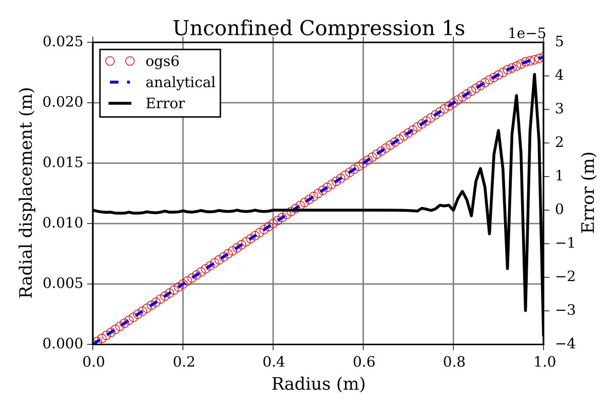

The result after 1s shows that due to the direct displacement on the boundary, the displacement on the x direction is quite large. Where the location is close enough to the outer radius, some water has already flowed out, the pore pressure is decreased and the gradient of displacement curve is modified.

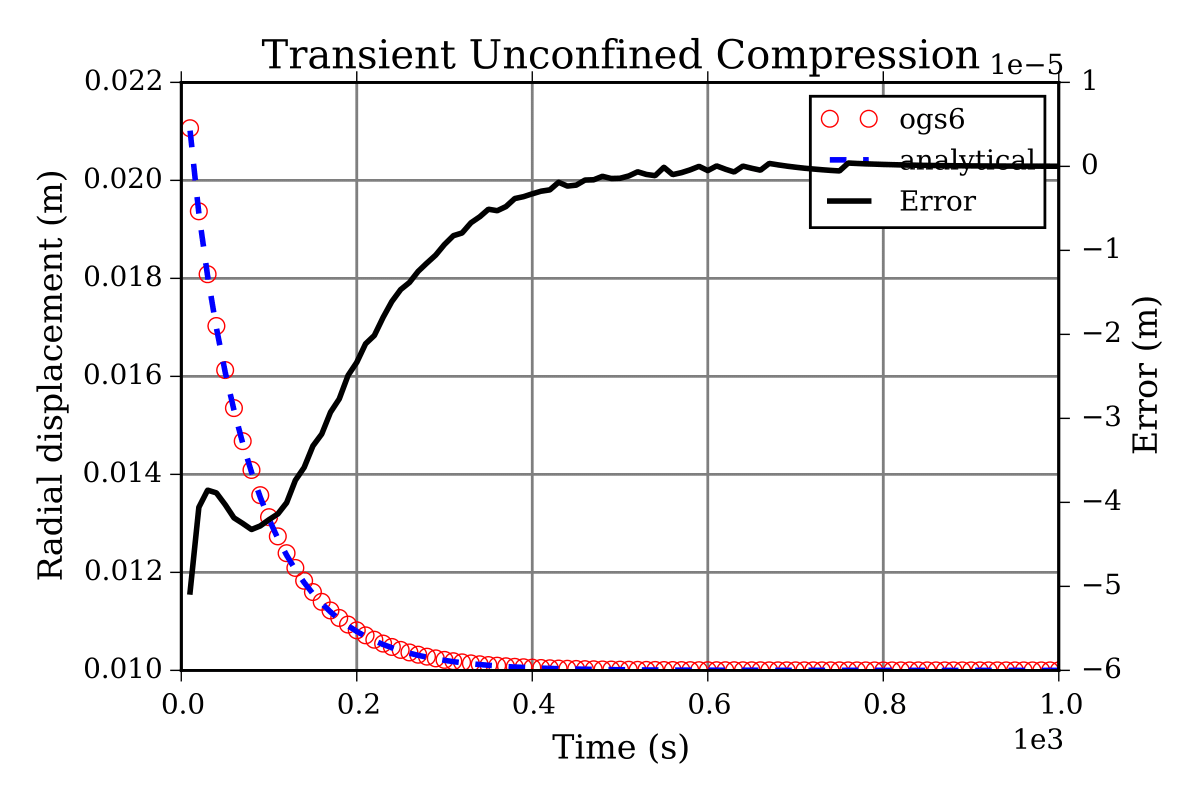

In order to capture the transient process at certain location, a point at the outer boundary is chosen to show the displacement during the whole compression process.
