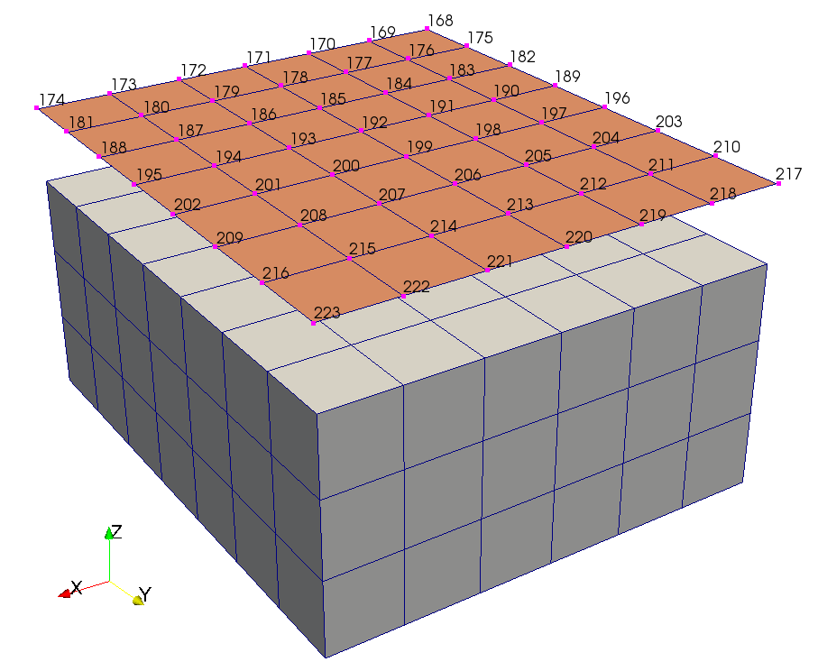

The following steps were performed to obtain the example data:
  1. The hexahedral example domain was created by generateStructuredMesh generateStructuredMesh -o hex_6x7x3.vtu -e hex --lx 6 --ly 7 --lz 3.
  2. The tool ExtractSurface was applied: ExtractSurface -i hex_6x7x3.vtu -o hex_6x7x3_surface.vtu The generated surface mesh contains a property bulk_node_ids assigned to the mesh nodes that contains the original subsurface mesh node ids.
  3. Finally ComputeNodeAreasFromSurfaceMesh -i hex_6x7x3_surface.vtu generates two text files (hex_6x7x3_surface.txt and hex_6x7x3_surface.csv). The TXT file is usable as boundary condition input file for OGS-5 simulation. The first column of the text file contains the original mesh node id (see image above), the second column the associated area. For example to the corner node 168 an area of 0.25 is associated. The edge node 169 has an area value of 0.5 and the interior node 176 has an area value of 1.
