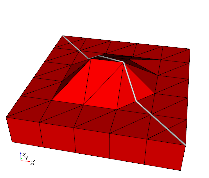

Input
Often, the mesh resolution and the resolution of the geometric objects like polylines are different.

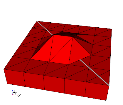

Result
The result of the application of the algorithm is shown.
Usage for the example:
MapGeometryToMeshSurface -m SubsurfaceMesh.vtu -i TestPolyline.gml -o TestMappedPolyline.gml
