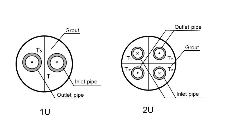

  • 1U: means there is only one single U-tube installed in the borehole;
  • 2U: double U-tubes installed in the borehole;

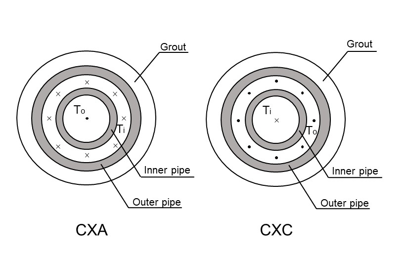

  • CXA: coaxial pipe with annular space as the inlet downwards flow and the centre part as outlet upwards flow;
  • CXC: coaxial pipe with a reversed flow direction to CXA type;
  • 1P: single coaxial pipe where the fluid flows down through a central pipe and returns upward through the annular space between the pipe and the borehole wall. Only one pipe (the inner pipe) is configured; the grout-filled annulus serves as the return flow path.
The borehole orientation — vertical, tilted, or curved — is determined entirely by the line-element geometry in the input mesh, and applies to all BHE types (1U, 2U, CXA, CXC, 1P). The node ordering of each line element defines the flow reference direction: BHE inflow flows from the element’s node 0 toward node 1, and the outflow returns from node 1 toward node 0. For the canonical vertical BHE this means node 0 sits at the top (surface) and node 1 at the bottom (depth). The per-leg advection vectors are computed from this line-element direction, so any inclination encoded in the mesh is honoured automatically. See the inclined-BHE meshing tutorial for guidance on producing meshes with non-vertical line elements.
The cross-sections of the U-type and coaxial BHEs are illustrated in the following figures.
