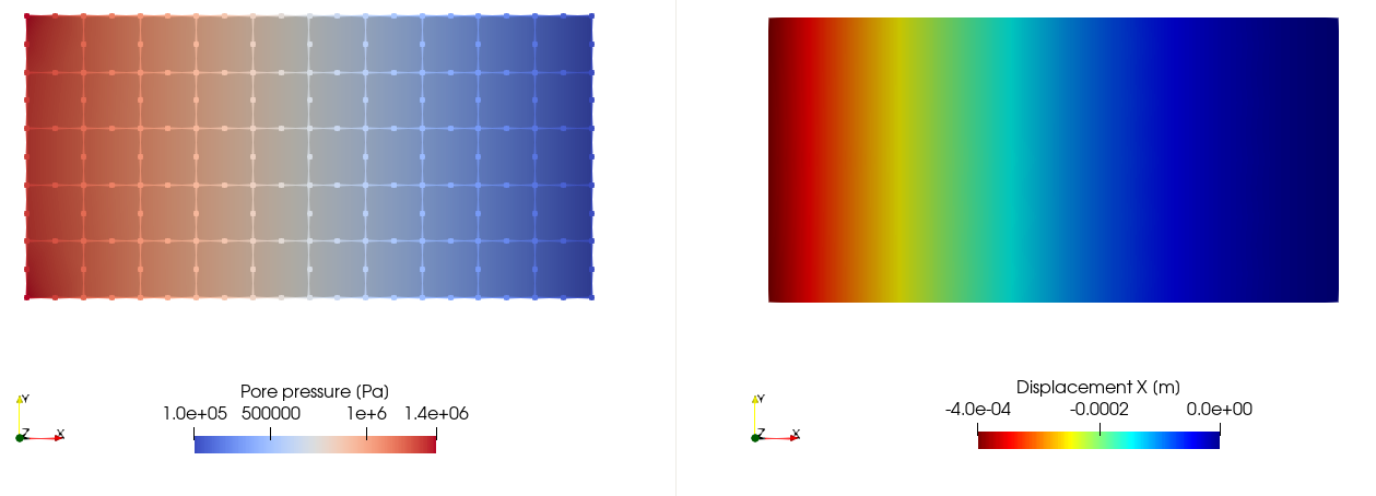

The distributions of pressure and displacement at the end time are shown in the
following figure:
