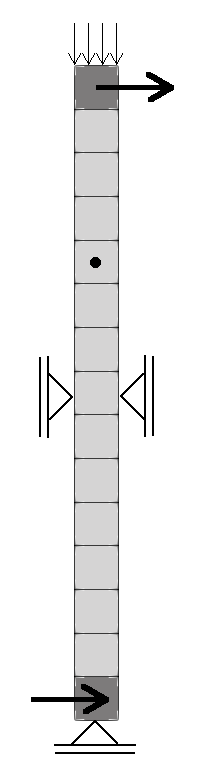

This benchmark simulates a soil column with fluid injection at the bottom and a production well at the top. It is taken from Kim [1], in detail it coincides with one of his examples (case 2, coupling strength $\tau=1.21$). A brief description of the used staggered scheme follows at the end.
Simulation model with fluid source, sink, observation point and boundary conditions
The fluid enters and leaves only via the source and sink in the domain, there is no flow across the boundaries. The displacements at the bottom are fixed, whereas there is a vertical traction applied on top. Originally the problem is one-dimensional, for simulation with OpenGeoSys it is created in two dimensions with corresponding boundary conditions. All parameters are concluded in the following tables.

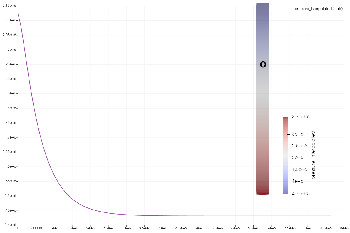

Note that 100 time steps were used for the following results, whereas the provided input file is set to 1 time step (1 day = 86400 s). Kim plots his results over non dimensional time, referring to the time at which the produced fluid volume equals the pore volume of the domain (450 days).
Pressure at observation point (marked by circle) versus time (t=0…100 days) and spatial pressure distribution at t=100 days
