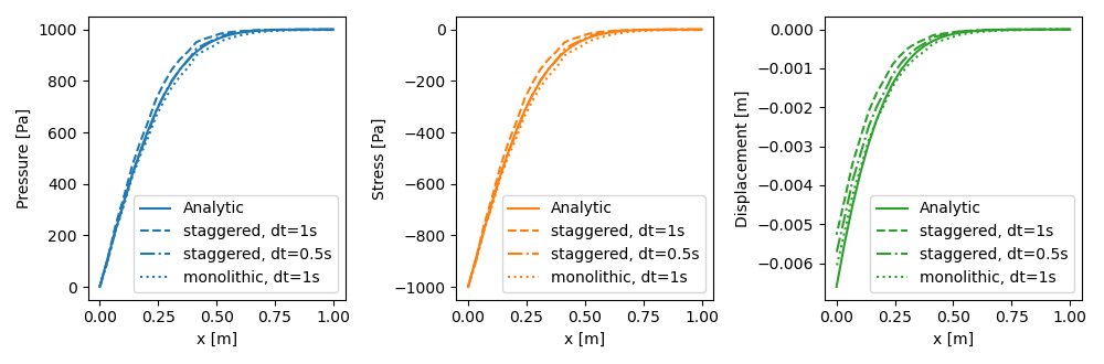

In the following figures, the solutions at $t=10$ s obtained by using the staggered scheme with fixed stress rate over time step, the monolithic scheme, and analytic approach are compared.
The figures show that for the staggered scheme with fixed stress rate over time step, the solutions with $dt=0.5$ s are quite close to the analytical ones.
