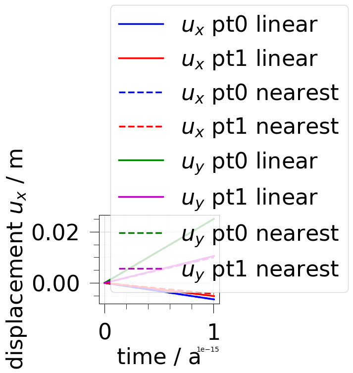

ms = ot.MeshSeries(f"{out_dir}/{prj_name}.pvd").scale(time=("s", "a"))… (click to toggle)
points_labels = ["pt0", "pt1"]
fig, ax = plt.subplots(nrows=1, ncols=1)… (click to toggle)
colors = {"x": ["b", "r"], "y": ["g", "m"]}
linestyles = {"linear": "-", "nearest": "--"}
for component in ["x", "y"]:
    for interp_method in ["linear", "nearest"]:
        labels = [f"$u_{component}$ {label} {interp_method}" for label in points_labels]
        ms_pts = ot.MeshSeries.extract_probe(
            ms, points_coords, interp_method=interp_method
        ot.plot.line(
            ms_pts,
            "time",
            ot.variables.displacement[component],
            labels=labels,
            ax=fig.axes[0],
            colors=colors[component],
            linestyle=linestyles[interp_method],
