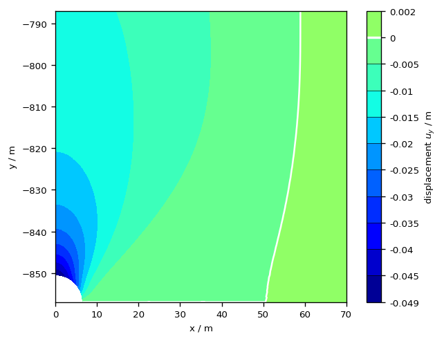

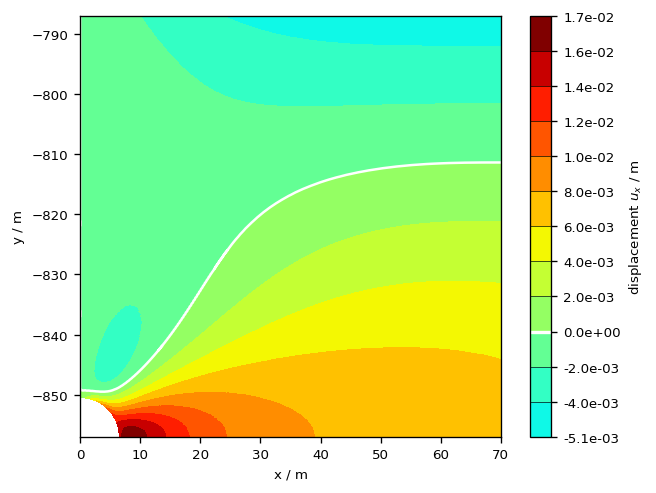

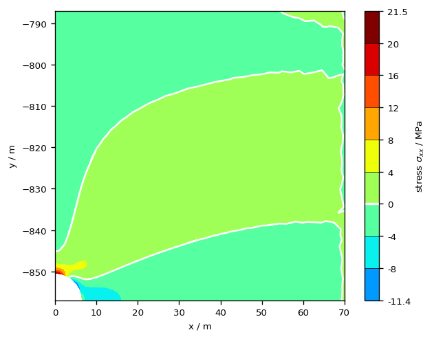

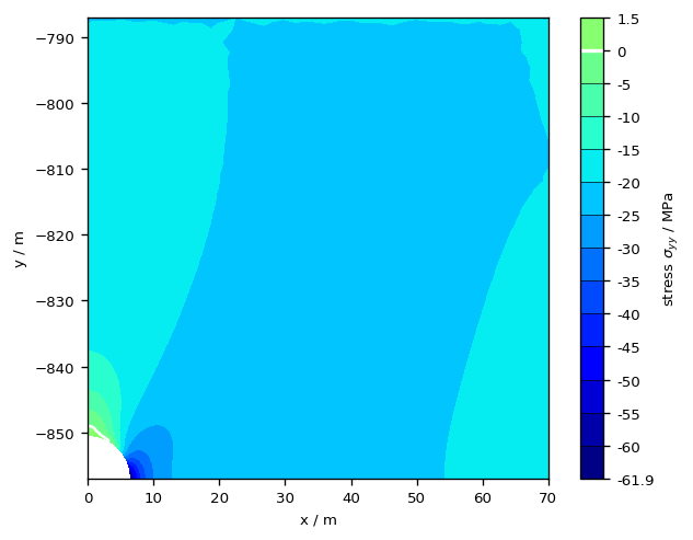

4. Contour plotting of the simulation results
pvd = Path(out_dir, f"{output_prefix}.pvd")… (click to toggle)
ms = ot.MeshSeries(pvd).scale(time=("s", "d"))
print(pvd)
mesh_last = ms[-1]
fig = mesh_last.plot_contourf(
    figsize=(6, 4),
    fontsize=8,
    cmap="jet",
/var/lib/gitlab-runner/builds/F1XUyv4cx/0/ogs/build/release-petsc/Tests/Data/Mechanics/ReleaseNodalForceKirsch/mpi_parallel_run_kirsch/kirsch_mpi.pvd
fig = mesh_last.plot_contourf(… (click to toggle)
    ot.variables.displacement["y"], figsize=(6, 4), fontsize=8, cmap="jet"
    ot.variables.stress["xx"], figsize=(6, 4), fontsize=8, cmap="jet"
    ot.variables.stress["yy"], figsize=(6, 4), fontsize=8, cmap="jet"

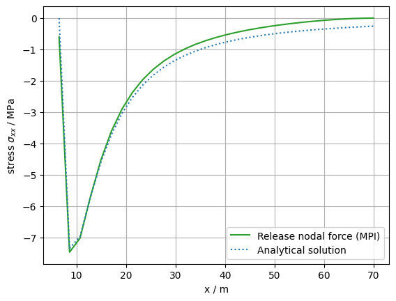

point_a = (6.5, -857.0, 0)… (click to toggle)
point_b = (70.0, -857.0, 0)
profile = ms[-1].sample_over_line(point_a, point_b, resolution=30)
xs = profile["Distance"] + 6.5
plt.plot(
    xs, profile["sigma"][:, 0] * 1e-6, color="C2", label="Release nodal force (MPI)"
a = 6.5
sigma_t = -20  # MPa
sigma_x_a = np.asarray(
    [0.5 * (3.0 * a * a / (r * r) - 3 * a**4 / (r**4)) * sigma_t for r in xs],
plt.plot(xs, sigma_x_a, linestyle="dotted", color="C0", label="Analytical solution")
plt.xlabel("x / m")
plt.ylabel(r"stress $\sigma_{xx}$ / MPa")
plt.legend()
plt.grid()
In the above figure, the radial stress $\sigma_r$ profiles along the $\theta = 0^\circ$ axis, obtained using the release nodal force approach, and the analytical solution, are compared.

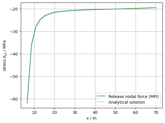

plt.plot(
    xs, profile["sigma"][:, 1] * 1e-6, color="C2", label="Release nodal force (MPI)"
a = 6.5
sigma_t = -20  # MPa
sigma_y_a = np.asarray(
    [0.5 * (2 + a * a / (r * r) + 3 * a**4 / (r**4)) * sigma_t for r in xs],
plt.plot(xs, sigma_y_a, linestyle="dotted", color="C0", label="Analytical solution")
plt.xlabel("x / m")
plt.ylabel(r"stress $\sigma_{yy}$ / MPa")
plt.legend()
plt.grid()
In the above two figures, the tangential stress $\sigma_{\theta}$ profiles along the $\theta = 0^\circ$ axis, obtained using the release nodal force approach, and the analytical solution, are compared.
