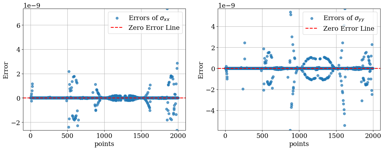

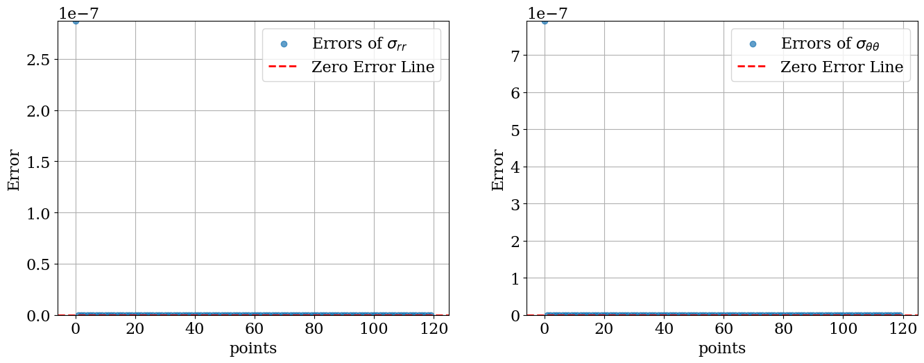

Error Analysis Function
def ErrorAnalysis(refFile, calFile, input1, input2, labelx, labely, tol):… (click to toggle)
    _fig, ax = plt.subplots(nrows=1, ncols=2, figsize=(16, 5.5))
    file_path1 = refFolder_name / refFile
    file_path2 = calFolder_name / calFile
    df1 = pd.read_csv(file_path1)
    df2 = pd.read_csv(file_path2)
    # Check if the columns are the same in both DataFrames
    if not df1.columns.equals(df2.columns):
        msg = "Columns in the CSV files are not the same."
        raise ValueError(msg)
    # Check if the shape of the DataFrames is the same
    if df1.shape != df2.shape:
        msg = "Shapes of the CSV files are not the same."
    errors0 = df1[input1] - df2[input1]
    errors1 = df1[input2] - df2[input2]
    # Calculate mean absolute error (MAE)
    mae0 = abs(errors0).mean()
    mae1 = abs(errors1).mean()
    mean_error = np.mean([mae0, mae1])
    if abs(mae0) > 0.0:
        ax[0].set_ylim([errors0.min(), errors0.max()])
    ax[0].scatter(range(len(errors0)), errors0, alpha=0.7, label=labelx)
    ax[0].axhline(y=0, color="red", linestyle="--", label="Zero Error Line")
    if abs(mae1) > 0.0:
        ax[1].set_ylim([errors1.min(), errors1.max()])
    ax[1].scatter(range(len(errors1)), errors1, alpha=0.7, label=labely)
    ax[1].axhline(y=0, color="red", linestyle="--", label="Zero Error Line")
    # Customize the plot
    ax[0].set_xlabel("points")
    ax[0].set_ylabel("Error")
    ax[0].grid("both")
    ax[0].legend()
    ax[1].set_xlabel("points")
    ax[1].set_ylabel("Error")
    ax[1].grid("both")
    ax[1].legend()
    tolerance = tol
    # Check if the error exceeds the threshold
    if mean_error > tolerance:
        msg = (
            f"Error exceeds the threshold. Stopping the code. Mean Error: {mean_error}"
    print("Continue with the rest of the code.", "Mean Error:", mean_error)

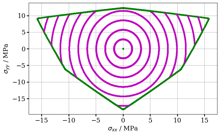

dataEx1 = {"sigma0": [], "sigma1": []}
calFile = "calculated_piplane_data_Ex1.csv"
piResults_set1 = {}… (click to toggle)
piResults_set1 = {}
material_set = {}
fig, ax = plt.subplots(figsize=(8, 5))
ax.set_adjustable("datalim")
ax.set_aspect("auto", "box")
material_set = {
    "sigma_ci": 110.0,
    "sigma_cg": 110.0,
    "Ei": 3.85e4,
    "nu": 0.2,
    "m_i": 2.0,
    "Df": 0.0,
    "gsi": 80.0,
    "lodeT": 29.0,
    "em": 5e-3,
    "delta_tol": 1e-6,
divisions = 1000
for theta in [
    pi * (-1.0 + 2.0 * float(i) / (float(divisions) - 1.0)) for i in range(divisions)
    piResults_set1 = run_pi_plane(theta, material_set, dataEx1, calFile)
    ax.plot(piResults_set1["sigma_elx"], piResults_set1["sigma_ely"], "m.")
    ax.plot(piResults_set1["sigma_plx"], piResults_set1["sigma_ply"], "g.")
ax.set_xlabel("$\\sigma_{xx}$ / MPa")

ErrorAnalysis(… (click to toggle)
ErrorAnalysis(
    "reference_piplane_data_Ex1.csv",
    "calculated_piplane_data_Ex1.csv",
    "sigma0",
    "sigma1",
    r"Errors of $\sigma_{xx}$",
    r"Errors of $\sigma_{yy}$",
    tol=1e-6,
Continue with the rest of the code. Mean Error: 1.6822704379315857e-10
dataEx2 = {"sigma0": [], "sigma1": []}
calFile = "calculated_piplane_data_Ex2.csv"
piResults_set2 = {}… (click to toggle)
piResults_set2 = {}
material_set = {}
material_set = {
    "sigma_ci": 30.0,
    "sigma_cg": 30.0,
    "Ei": 1.071e4,
    "nu": 0.2,
    "m_i": 15.0,
    "Df": 0.0,
    "gsi": 65.0,
    "lodeT": 29.0,
    "em": 2e-4,
    "delta_tol": 1e-6,
divisions = 1000
for theta in [
    piResults_set2 = run_pi_plane(theta, material_set, dataEx2, calFile)
    ax.plot(piResults_set2["sigma_elx"], piResults_set2["sigma_ely"], "m.")
    ax.plot(piResults_set2["sigma_plx"], piResults_set2["sigma_ply"], "g.")
ax.set_ylabel("$\\sigma_{yy}$ / MPa")
ax.grid("both")
ax.tick_params(width=2, length=5)
ax.xaxis.set_minor_locator(MultipleLocator(5))
ax.yaxis.set_minor_locator(MultipleLocator(5))
ax.tick_params(which="minor", width=2, length=3, color="k")

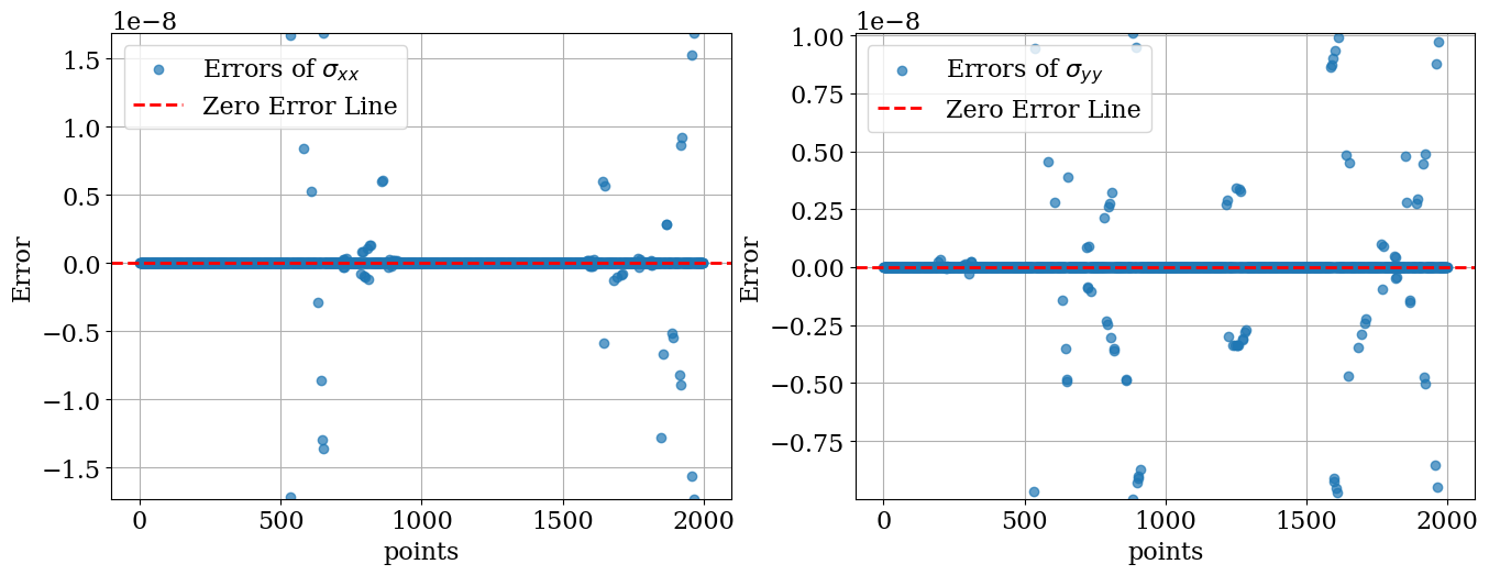

ErrorAnalysis(
    "reference_piplane_data_Ex2.csv",
    "calculated_piplane_data_Ex2.csv",
    "sigma0",
    "sigma1",
    tol=1e-6,
Continue with the rest of the code. Mean Error: 9.404406441636417e-11

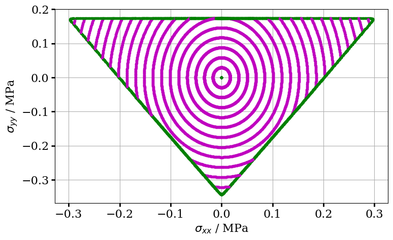

The yield function is approached along different stress paths within the $\pi$-plane. This shows that yield is correctly detected, and the stress state is correctly pulled back onto the yield surface.
The tensile strength is calculated by setting $\sigma_1 = \sigma_2 = \sigma_3 = \sigma_t$ in (1) and calculated by
$$ \sigma_t = s \cfrac{\sigma_{ci}}{m_b}. \tag{10} $$
Calculation of Tensile Strength
sigma_t = round(… (click to toggle)
sigma_t = round(
    piResults_set2["sF"] / piResults_set2["m_b"] * (material_set["sigma_ci"]), 3
stress_t = f"$\\sigma_t = {sigma_t:2.3f}$ MPa"
display(Markdown(stress_t))
$\sigma_t = 0.143$ MPa

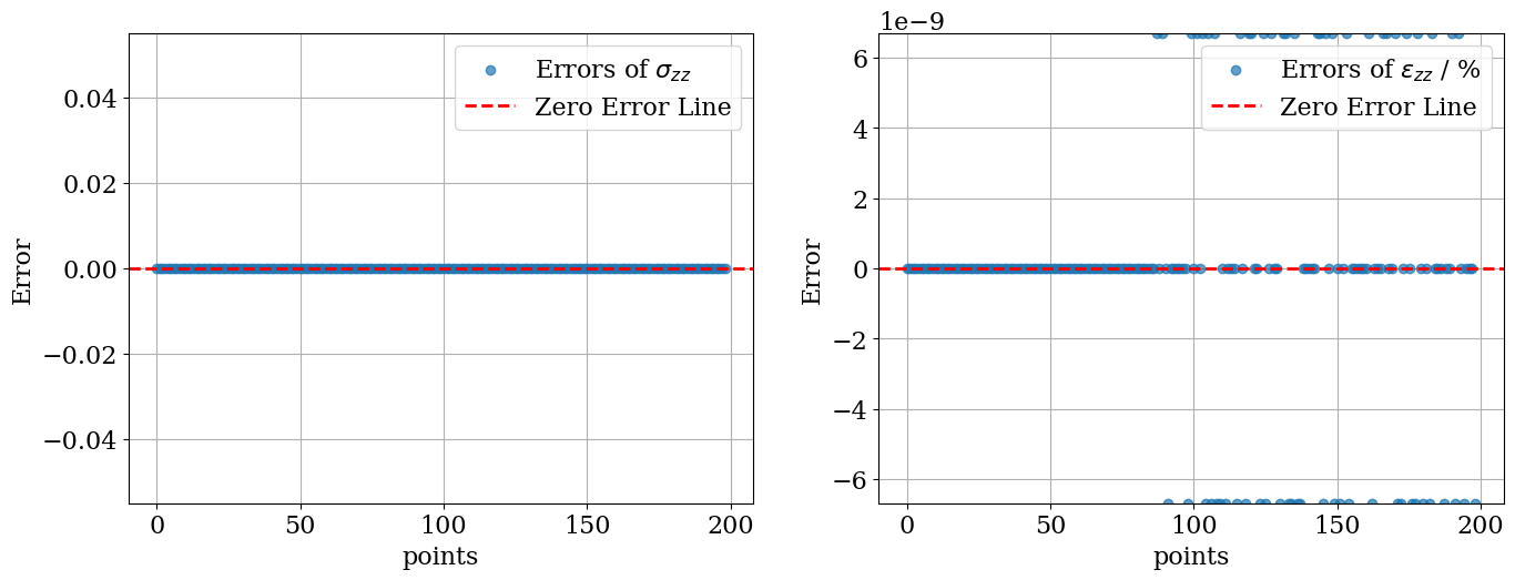

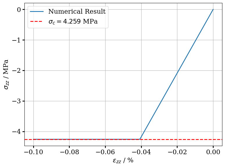

Compressive Loading Test
dataEx3 = {"epsilon2": [], "sigma2": []}
calFile = "calculated_CLT_data_Ex3.csv"
results_set1 = {}… (click to toggle)
results_set1 = {}
material_set = {}
fig, ax = plt.subplots(figsize=(8, 6))
material_set = {
    "sigma_ci": 30.0,
    "sigma_cg": 30.0,
    "Ei": 1.071e4,
    "nu": 0.2,
    "m_i": 15.0,
    "Df": 0.0,
    "gsi": 65.0,
    "lodeT": 29.0,
    "em": -1e-3,
    "delta_tol": 1e-6,
    "Test": "Compressive Loading Test",
flgt = 1
results_set1 = runTest(material_set, dataEx3, calFile)
ax.plot(
    results_set1["eps_zz"] * 100.0,
    results_set1["sig_zz"],
    label="Numerical Result",
ax.set_xlabel("$\\epsilon_{zz}$ / % ")
ax.set_ylabel("$\\sigma_{zz}$ / MPa")
ax.grid("both")
ax.axhline(
    y=-sigma_c, color="r", linestyle="--", label=f"$\\sigma_c = {sigma_c:2.3f}$ MPa"
ax.legend()
<matplotlib.legend.Legend at 0x7f1790e2b250>
ErrorAnalysis(
    "reference_CLT_data_Ex3.csv",
    "calculated_CLT_data_Ex3.csv",
    "epsilon2",
    "sigma2",
    r"Errors of $\sigma_{zz}$",
    r"Errors of $\epsilon_{zz}$ / %",
    tol=1e-6,
Continue with the rest of the code. Mean Error: 1.0083562117619269e-09

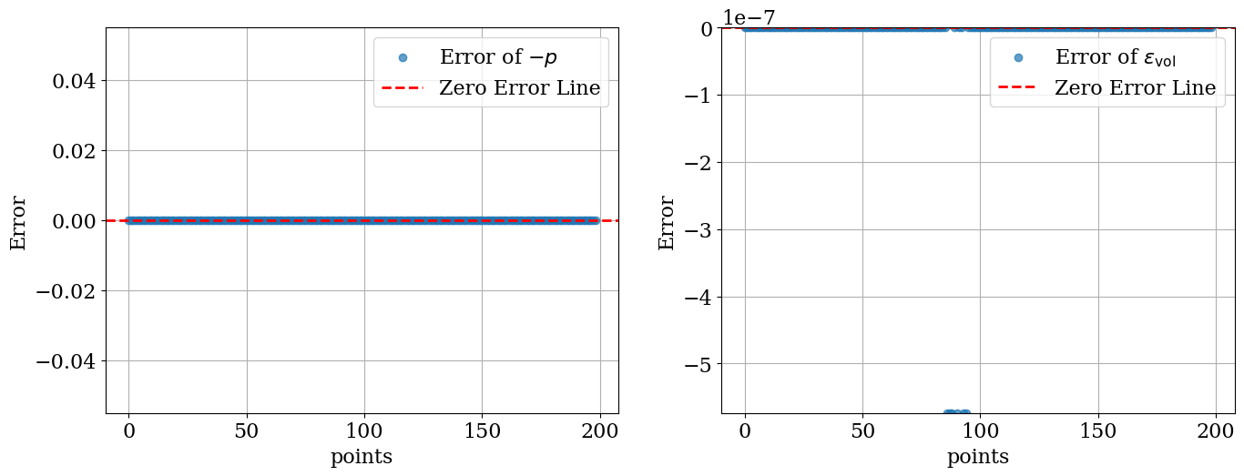

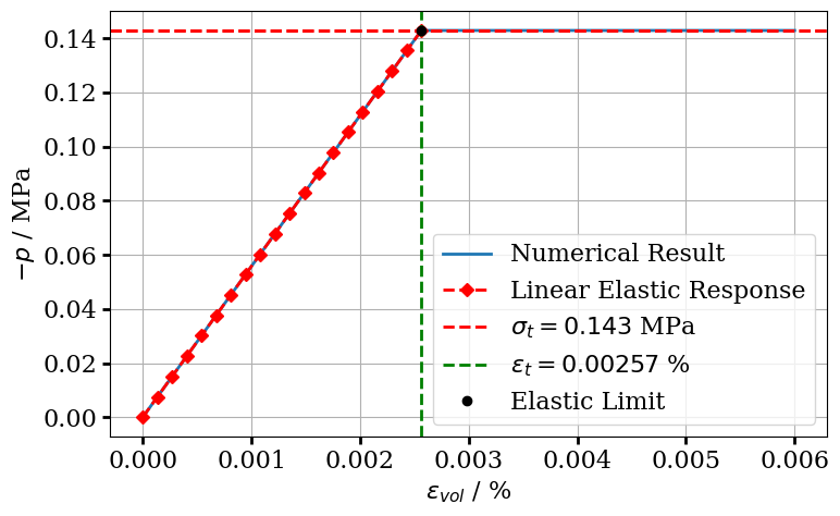

Hydrostatic Loading Test
This part validates the hydrostatic loading test by using analytically derived solutions. To this end, it is necessary to determine the bulk modulus and then the elastic limit, which indicates the point at which the material starts to undergo plastic deformation.
# Calculate the analytical solution to the hydrostatic loading test… (click to toggle)
def analytical_solution(epst, sigma_t, bulkModulus):
    def stressStrain(strain, bulkModulus):
        return bulkModulus * strain
    stress_start = 0
    stress_end = sigma_t
    strain = np.linspace(stress_start / bulkModulus, stress_end / bulkModulus, 20)
    stress = stressStrain(strain, bulkModulus)
    ax.plot(
        strain * 100.0,
        stress,
        label="Linear Elastic Response",
        color="r",
        linestyle="--",
        marker="D",
    if strain.any() > epst:
        ax.axhline(y=sigma_t, color="r", linestyle="--")
# Calculate the bulk modulus… (click to toggle)
def BulkModulus(results_set, material_set):
    return results_set["Ec"] / (3.0 * (1.0 - 2.0 * material_set["nu"]))
# Calculate the pressure… (click to toggle)
def pressure(results_set):
    return (
        -(results_set["sig_xx"] + results_set["sig_yy"] + results_set["sig_zz"]) / 3.0
# Calculate the elastic limit… (click to toggle)
def elasticLimit(sigma_t, bulkModulus):
    return sigma_t / bulkModulus * 100.0
dataEx4 = {"epsvol": [], "p": []}
calFile = "calculated_HLT_data_Ex4.csv"
results_set2 = {}… (click to toggle)
results_set2 = {}
material_set = {}
material_set = {
    "sigma_ci": 30.0,
    "sigma_cg": 30.0,
    "Ei": 1.071e4,
    "nu": 0.2,
    "m_i": 15.0,
    "Df": 0.0,
    "gsi": 65.0,
    "lodeT": 29.0,
    "em": 2e-5,
    "delta_tol": 1e-6,
    "Test": "Hydrostatic Loading Test",
results_set2 = runTest(material_set, dataEx4, calFile)
bulkModulus = BulkModulus(results_set2, material_set)
p = pressure(results_set2)
ax.plot(
    (results_set2["eps_xx"] + results_set2["eps_yy"] + results_set2["eps_zz"]) * 100,
    -p,
epst = elasticLimit(sigma_t, bulkModulus)
ax.axhline(
    y=sigma_t, color="r", linestyle="--", label=f"$\\sigma_t = {sigma_t:2.3f}$ MPa"
ax.axvline(
    x=epst,
    color="g",
    linestyle="--",
    label=f"$\\epsilon_t = {epst:2.5f}$ %",
ax.plot(epst, sigma_t, "ko", label="Elastic Limit")
ax.set_xlabel("$\\epsilon_{vol}$ / %")
ax.set_ylabel("$-p$ / MPa")
ax.grid("both")
ax.legend()
<matplotlib.legend.Legend at 0x7f17962f8b90>
ErrorAnalysis(
    "reference_HLT_data_Ex4.csv",
    "calculated_HLT_data_Ex4.csv",
    "epsvol",
    "p",
    "Error of $-p$",
    "Error of $\\epsilon_{\\text{vol}}$",
    tol=1e-6,
Continue with the rest of the code. Mean Error: 8.648036520496276e-09

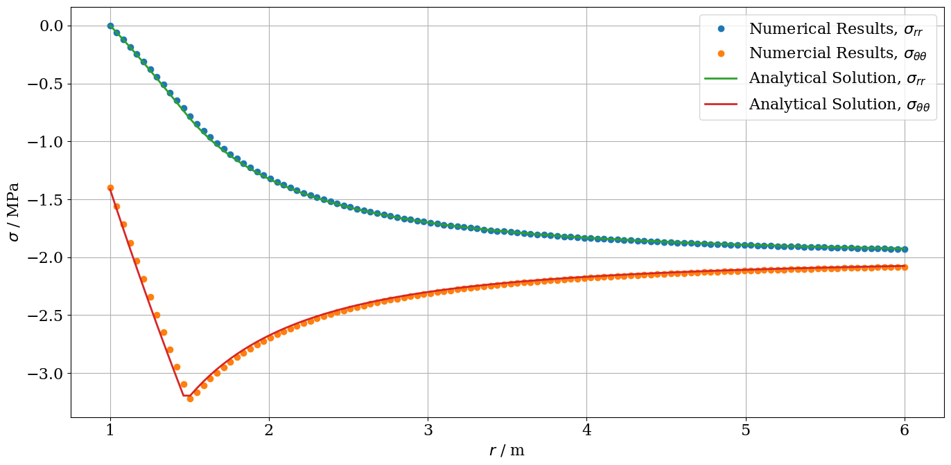

Elastoplastic Response of a Circular Hole to Cyclic Loading
In this example, the Hoek-Brown model implemented based on the $C_2$ continuous approach is applied to a circular hole under cyclic loading and compare the results in terms of the radial and tangential stresses with the analytical solutions. The analytical solution for this problem is provided by the work of Carranza-Torres and Fairhurst [15]. We consider a cylindrical hole with a radius of $r$, which is subjected to an in-situ uniform stress field of $\sigma_0$, and an internal pressure of $p_i$. The scaled far-field stresses, $S_0$, and scaled internal pressure, $P_0$, are determined by the following two equations, respectively
$$ S_0 = \frac{\sigma_0}{m_b \sigma_0} + \frac{s}{m_b ^ 2}, \quad \text{and} \quad P_i = \frac{P_0}{m_b \sigma_0} + \frac{s}{m_b ^ 2}. \tag{12} $$
The elastic limit of rock mass is determined by the scaled far-field stress ($S_0$) and the corresponding scaled (dimensionless) critical internal pressure ($P^{\text{cr}}_i$) is calculated as
$$ P_{i}^{\text{cr}} = \frac{1}{16} \left(1 - \sqrt{1 + 16 S_0} \right)^2. \tag{13} $$
Then, the critical internal pressure, $p^{\text{cr}}_i$ , is given by
$$ p_{i}^{\text{cr}} = \left( P_{i}^{\text{cr}} - \frac{s}{m_{b} ^ {2}} \right) m_b \sigma_{\text{ci}}. \tag{14} $$
The plastic region grows equally around the hole. The failure zone reaches to
$$ b_{\text{pl}} = b \exp \left( 2 \sqrt{P_{i}^{\text{cr}}} - \sqrt{P_i} \right). \tag{15} $$
In the plastic region where $r < b_{\text{pl}}$, the solutions for the radial and the tangential stresses are calculated as follows, respectively
$$ \sigma_r(r) = \left( S_r (r) - \frac{s}{m_b ^2} \right) m_b \sigma_{\text{ci}}, \quad \text{and} \quad \sigma_{\theta}(r) = \left( S_{\theta} (r) - \frac{s}{m_b ^2} \right) m_b \sigma_{\text{ci}}, \tag{16} $$
where $S_r$ and $S_{\theta}$ are correspondingly given by
$$ S_r(r) = \left( \sqrt{P_{i}^{\text{cr}}} + \frac{1}{2} \ln \left( \frac{r}{b_{\text{pl}}} \right) \right)^2, \quad \text{and} \quad S_{\theta}(\theta) = \sqrt{S_{r}(r)} + S_r(r). \tag{17} $$
The solutions for the radial and the tangential stresses in the elastic region are calculated by
$$ \sigma_r(r) = \sigma_0 - (\sigma_0 - p_{i}^{\text{cr}}) \left( \frac{b_{\text{pl}}}{r} \right)^2, \quad \text{and} \quad \sigma_{\theta}(r) = \sigma_0 + (\sigma_0 - p_{i}^{\text{cr}}) \left( \frac{b_{\text{pl}}}{r} \right)^2. \tag{18} $$
model_hb = ot.Project(… (click to toggle)
    input_file="load_test_hb_nonassociated.prj",
    output_file="load_test_hb_nonassociated.prj",
model_hb.run_model(… (click to toggle)
model_hb.run_model(
    logfile=str(out_dir / "out.txt"), args=f"-o {out_dir}", write_prj_to_pvd=False
Simulation: load_test_hb_nonassociated.prj
Execution took 7.002599477767944 s
pvd_hb = vtuIO.PVDIO(f"{out_dir}/load_test_hb.pvd", dim=2)
b = 1000.0… (click to toggle)
b = 1000.0
rmax = 6000.0
npts = 120
raxis = [(i, 500, 0) for i in np.linspace(start=b, stop=rmax, num=npts)]

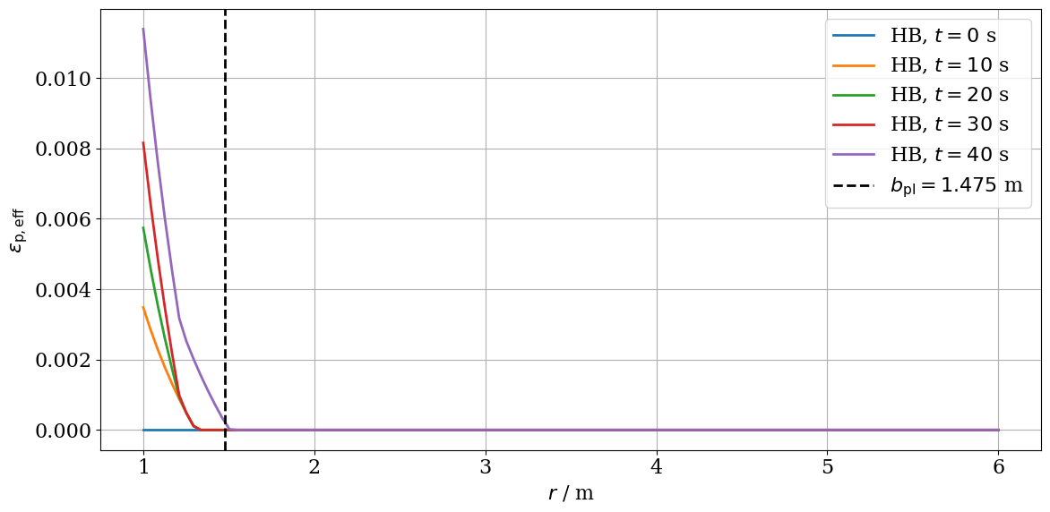

fig, ax = plt.subplots(figsize=(12, 6))… (click to toggle)
for i in [0, 10, 20, 30, 40]:
    ax.plot(
        np.array(raxis).T[0] / 1000,
        pvd_hb.read_set_data(i, "EquivalentPlasticStrain", pointsetarray=raxis),
        label=f"HB, $t = {i}$ s",
        ls="-",
ax.axvline(
    x=analytResults_set["pl_range"],
    color="black",
    linestyle="--",
    label="$b_{{\\text{{pl}}}} = {:2.3f}$ m".format(analytResults_set["pl_range"]),
ax.set_xlabel("$r$ / m")
ax.set_ylabel("$\\epsilon_\\mathrm{p,eff}$")
ax.legend()
ax.grid("both")
fig, ax = plt.subplots(figsize=(14, 7))… (click to toggle)
radData = np.array(raxis).T[0] / 1000
calData_stress_rr = pvd_hb.read_set_data(i, "sigma", pointsetarray=raxis).T[0]
calData_stress_tt = pvd_hb.read_set_data(i, "sigma", pointsetarray=raxis).T[2]
pd.DataFrame(
    {"rad": radData, "sigma_rr": calData_stress_rr, "sigma_tt": calData_stress_tt}
).to_csv(calFolder_name / "calculated_data_Ex5.csv", index=False)
ax.plot(
    pvd_hb.read_set_data(i, "sigma", pointsetarray=raxis).T[0],
    label="Numerical Results, $\\sigma_{rr}$",
    ls="none",
    marker="o",
ax.plot(
    pvd_hb.read_set_data(i, "sigma", pointsetarray=raxis).T[2],
    label="Numercial Results, $\\sigma_{\\theta\\theta}$",
    ls="none",
    marker="o",
ax.plot(
    analytResults_set["radius"][1:],
    analytResults_set["sig_rr"][1:] * -1.0,
    label="Analytical Solution, $\\sigma_{rr}$",
ax.plot(
    analytResults_set["sig_tt"][1:] * -1.0,
    label="Analytical Solution, $\\sigma_{\\theta\\theta}$",
ax.set_ylabel("$\\sigma$ / MPa")
ax.legend()
ax.grid("both")

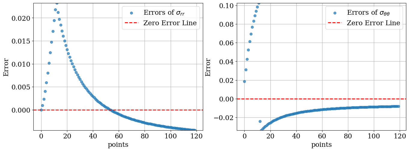

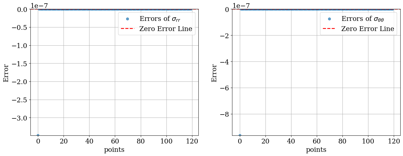

ErrorAnalysis(
    "reference_data_Ex5.csv",
    "sigma_rr",
    "sigma_tt",
    r"Errors of $\sigma_{rr}$",
    "Errors of $\\sigma_{\\theta \\theta}$",
    tol=1e-6,
Continue with the rest of the code. Mean Error: 5.467670297275222e-09
ErrorAnalysis(
    "analytical_data_Ex5.csv",
    "sigma_rr",
    "sigma_tt",
    tol=5e-1,
Continue with the rest of the code. Mean Error: 0.012070187784180824
