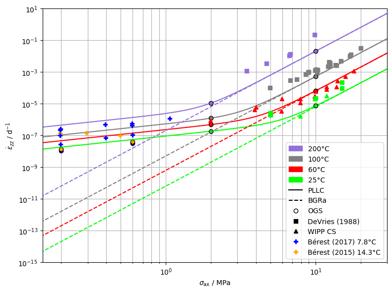

This benchmark shows the increased creep rate of salt rock at lower deviatoric stress. A two component power law (which we call Power Law Linear Creep, or short PLLC) provides an easy way to capture the power law behaviour (dislocation creep) and the linear behaviour (pressure solution creep). For more details have a look at (Zill et al., 2022).

Parameters
This set of parameters gives a good fit with the experimental data. The grain size is a bit larger than the usual grain size of roughly 1 cm.

The experimental data is compared against the model results (analytically and numerically)

fig, ax = plt.subplots(1, 1, figsize=(8, 6))
ax.set_xlabel("$\\sigma_\\mathrm{ax}$ / MPa")
ax.set_ylabel("$\\dot{\\epsilon}_{zz}$ / d$^{-1}$")
ax.set_xlim(0.15, 30)
ax.set_ylim(1e-15, 1e1)
ax.grid(visible=True, which="both")
points = {"pt0": (1.0, 1.0, 1.0)}
sigs = np.logspace(-1, 2, 100)
for temp, (col, stresses) in Exps.items():
    # plot analytical curves
    if temp >= 25:
        ax.plot(sigs, BGRa(sigs, temp), color=col, ls="--")
        ax.plot(sigs, PLLC(sigs, temp), color=col, ls="-")
    # simulation in ogs and plot results
    eps_dot = []
    ogs_model.replace_parameter_value("T_ref", str(temp + 273.15))
    for stress in stresses:
        ogs_model.replace_parameter_value("sigma_ax", str(-stress))
        ogs_model.write_input()
        # hide output
        with contextlib.redirect_stdout(None):
            ogs_model.run_model(
                logfile=f"{out_dir}/out.txt", args="-m " + f"{data_dir}/Mechanics/PLLC/"
            pvdfile = vtuIO.PVDIO(f"{prj_name}.pvd", dim=3)
        eps_zz = pvdfile.read_time_series("epsilon", points)["pt0"][:, 2]
        eps_zz_dot = np.abs(np.diff(eps_zz)) / np.diff(pvdfile.timesteps)
        # omit the first timestep
        eps_dot += [np.mean(eps_zz_dot[1:])]
    ax.loglog(1e-6 * stresses, eps_dot, "o", c=col, markeredgecolor="k")
# plot experimental data points
for _Ex, (temp, m, Data) in ExData.items():
    stresses, eps_dot = np.array(Data).T
    ax.loglog(stresses, eps_dot, m, c=Exps[temp][0])
# create legend
patches = [
    mpl.patches.Patch(color=col, label=str(temp) + "°C")
    for temp, (col, _) in Exps.items()
    if temp >= 25
][::-1]
def addLeg(**args):
    return patches.append(mpl.lines.Line2D([], [], **args))
addLeg(c="k", label="PLLC")
addLeg(c="k", ls="--", label="BGRa")
addLeg(c="w", ls="None", marker="o", mec="k", label="OGS")
addLeg(c="k", ls="None", marker="s", label="DeVries (1988)")
addLeg(c="k", ls="None", marker="^", label="WIPP CS")
addLeg(c="b", ls="None", marker="P", label="Bérest (2017) 7.8°C")
addLeg(c="orange", ls="None", marker="P", label="Bérest (2015) 14.3°C")
ax.legend(handles=patches, loc="best")
