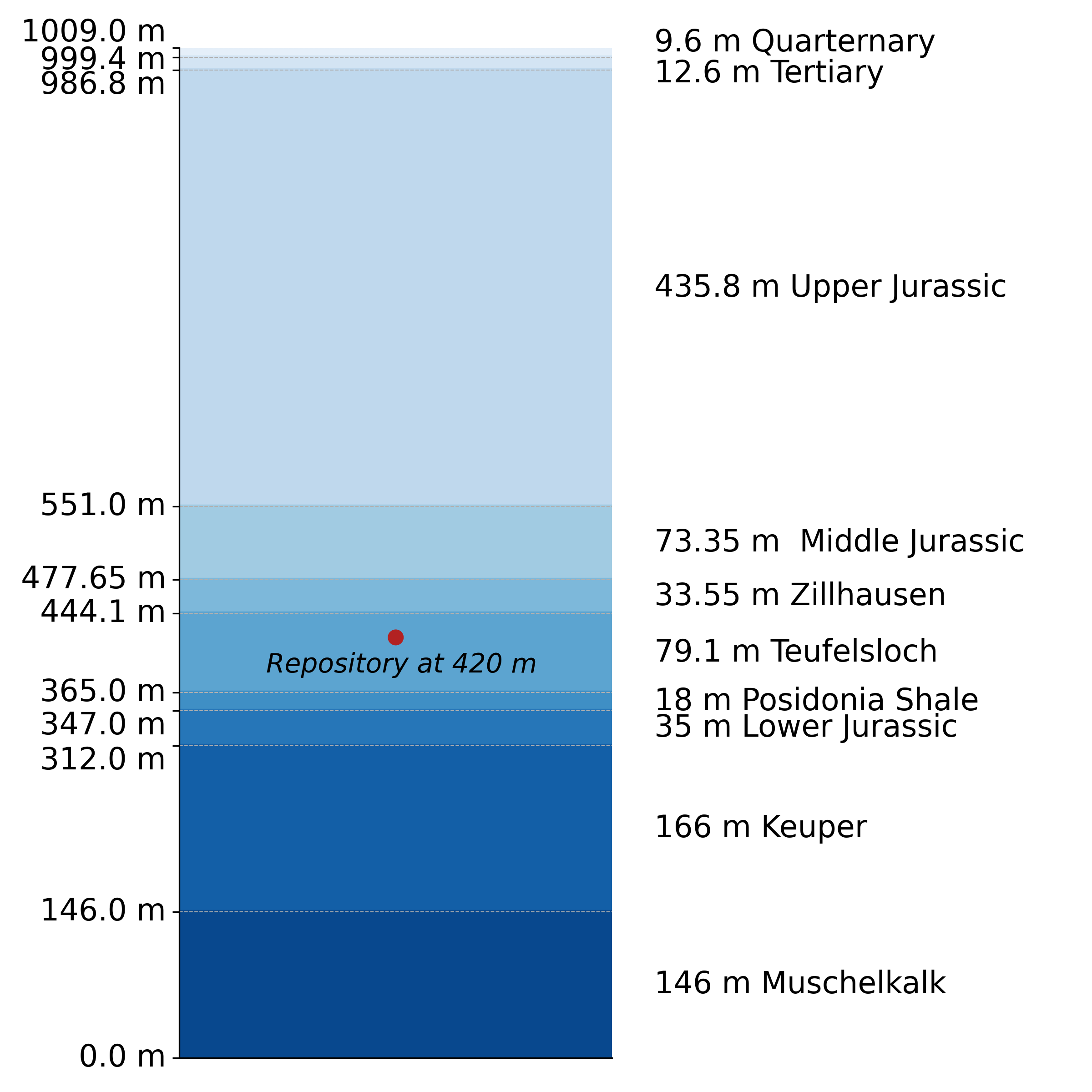

A hypothetical repository is located at $x = 420\,\mathrm{m}$ above the bedrock. Here, we only model Iodide-129 and all other radionuclides are ignored.
The initial condition is a $1\,\mathrm{m}$ long concentration peak centered at the repository, with node values chosen so that the total concentration at $t=0\,\mathrm{s}$ integrates to $2\,\mathrm{mol/L}$ .

The figure below shows the simplified stratigraphic profile representing the example geology: Domain

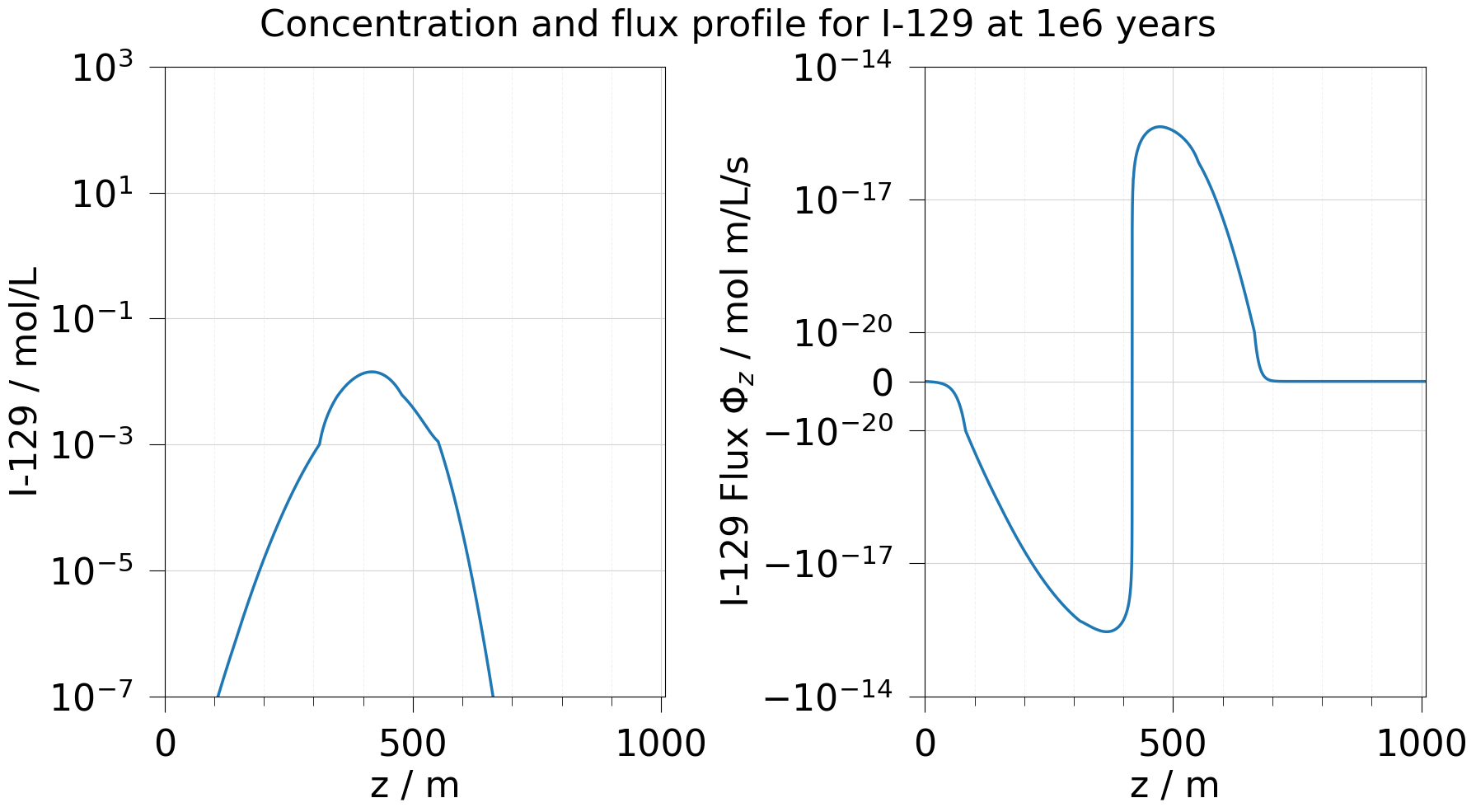

Next, we will visualize each of these field-data quantities in space for a fixed time $t$
Spatial profile of Iodide-129 and Iodide-129 flux ($\Phi_z$)

fig.suptitle("Concentration and flux profile for I-129 at 1e6 years", fontsize=32)

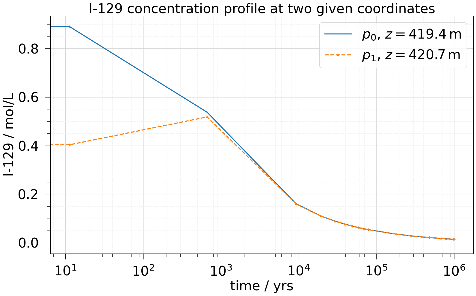

As stated earlier, our repository is located at a depth of $420 \mathrm{m}$.
In this section, we will probe the Iodide-129 concentration at two nearby points using the ogstools method MeshSeries.extract_probe. Let the points be: $p_0 = (0, 0, 419.4\,\mathrm{m})$ and $p_1 = (0, 0, 420.7\,\mathrm{m})$

ax.set_title("I-129 concentration profile at two given coordinates")

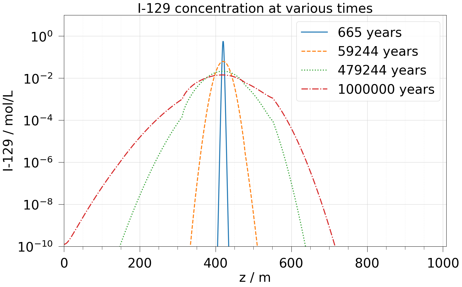

The .PVD file contains 21 time steps ranging from $0$ to $10^6$ years. We will now plot the profile at multiple time steps.

ax.set_title("I-129 concentration at various times")

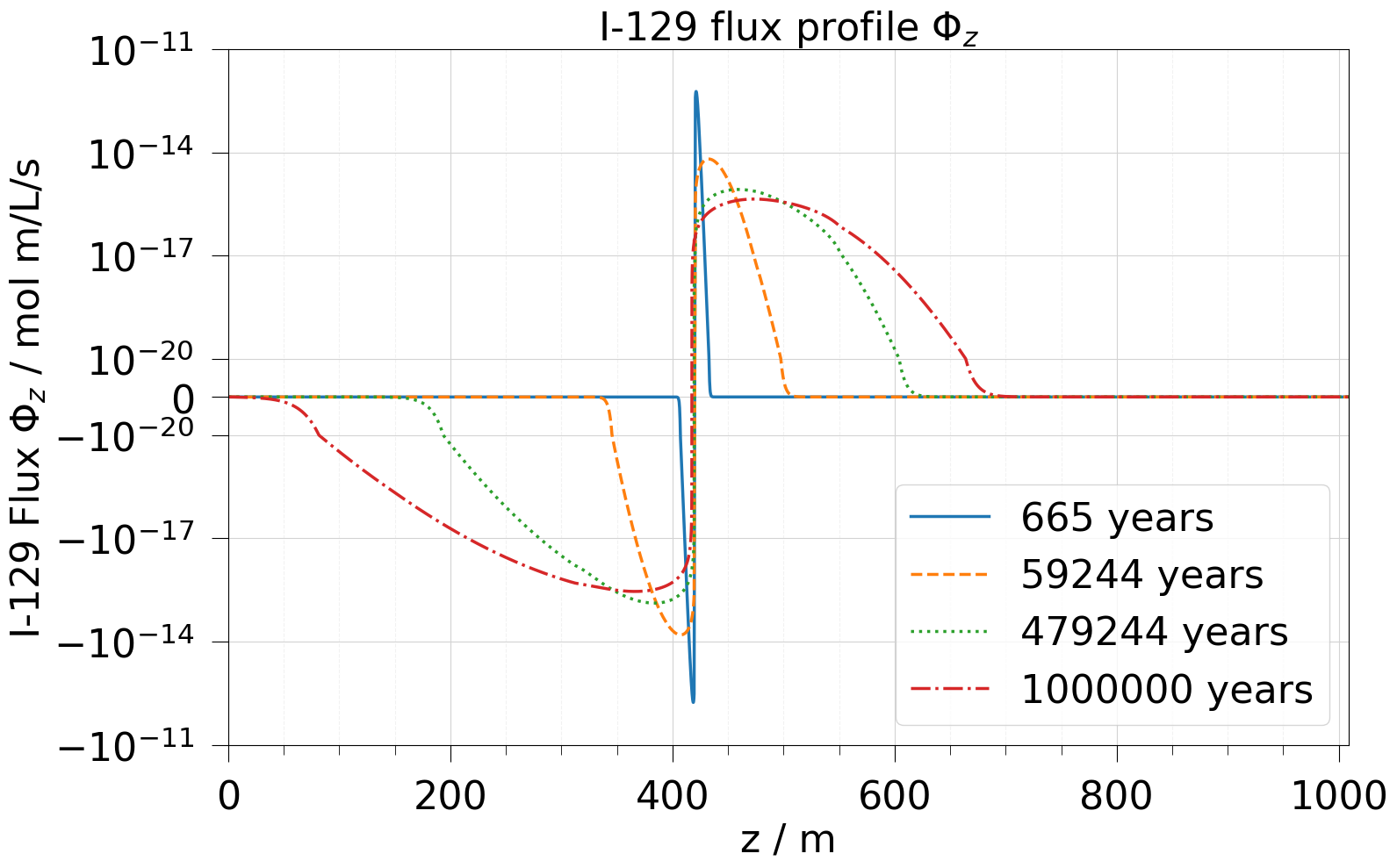

Similarly, we can create a plot illustrating the I-129 flux ($\Phi_z$) over multiple time steps till $10^6$ years.

fig.axes[0].set_title(r"I-129 flux profile $\Phi_z$")

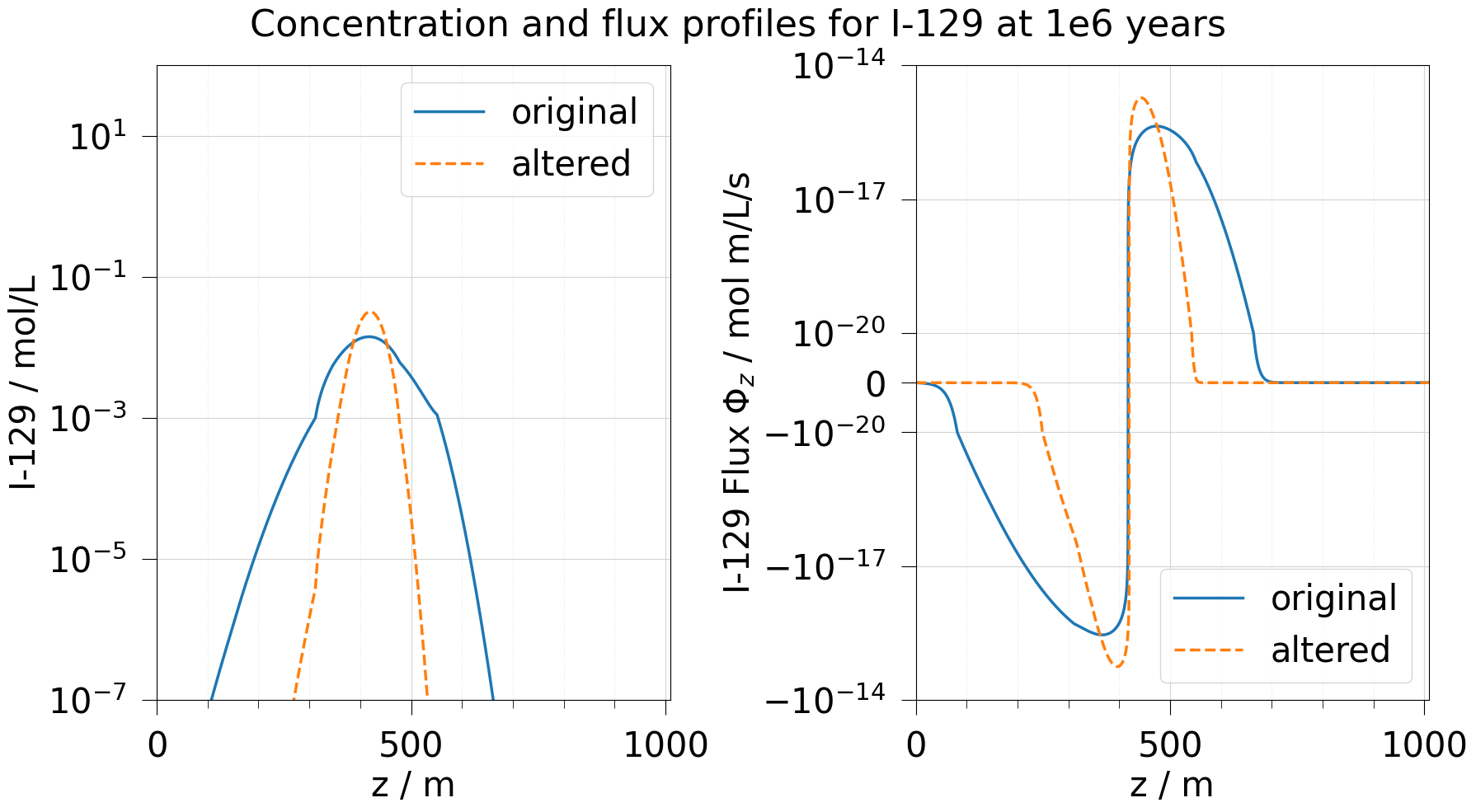

In this example, we adjust the retardation factors of the layers from our original setup. This is for demonstration purposes only and does not reflect any physical justification.

In this example, we will now compare the I-129 spatial concentration profile.
fig, ax = plt.subplots(ncols=2, figsize=(18, 10))(click to toggle)
ot.plot.line(ms_pvd[-1], "z", I129, label="original", ax=ax[0], color="C0")
ot.plot.line(
    ms_altered[-1],
    "z",
    I129,
    label="altered",
    ax=ax[0],
    color="C1",
    linestyle="--",
    fontsize=30,
ax[0].set_xlim(z_points.min(), z_points.max())
ax[0].set_yscale("log")
ax[0].set_ylim(1e-7, 1e2)
ot.plot.line(ms_pvd[-1], "z", I129Flux["z"], label="original", ax=ax[1], color="C0")
ot.plot.line(
    ms_altered[-1],
    "z",
    I129Flux["z"],
    label="altered",
    ax=ax[1],
    color="C1",
    linestyle="--",
    fontsize=30,
ax[1].set_ylim(-1e-14, 1e-14)
ax[1].set_yscale(
    "symlog", linthresh=10**-20
)  # By this, the y-axis is logarithmitic outside of [-1e-20,1e-20], and linear otherwise, however, some artifacts of double-plotting are there
ax[1].set_xlim(z_points.min(), z_points.max())
fig.suptitle("Concentration and flux profiles for I-129 at 1e6 years", fontsize=32)
