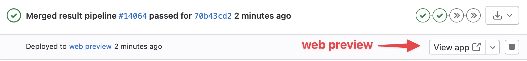

- A preview is also generated during Continuous Integration
