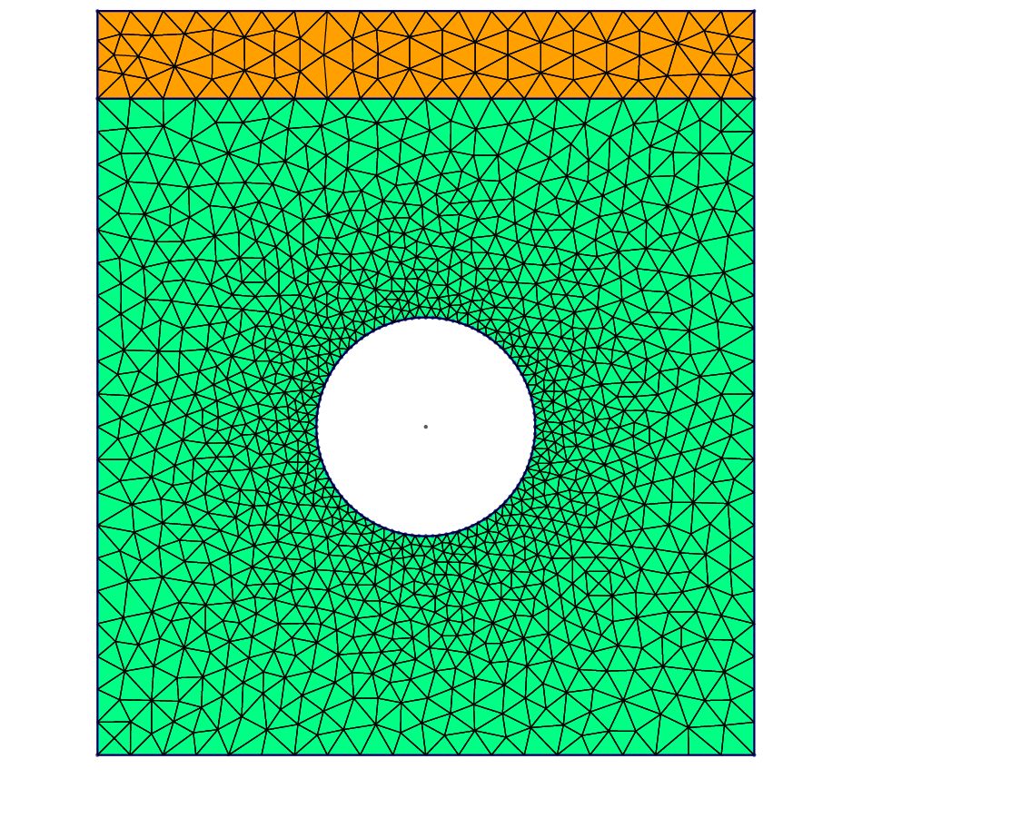

Following up the benchmark about the BGRa creep model described on the this page , this example represents the creep in the near field of drift in the deep rock salt after excavation. The domain and the geometry are shown in the following figure:
| Cap rock | Rock salt | Unit | |
| Density | 2000 | 2170 | $\mathrm{kg} / \mathrm{m}^3$ |
| Young’s Modulus | 7.0 | 7.65 | GPa |
| Poisson ratio | 0.3 | 2.7 | - |
| Thermal conductivity | 5 | 5 | W/(mK) |
The parameters of the BGRa creep model are $A = 0.18d^{-1}$, $m = 5$, $Q = 54$ $kJ/mol$ for the rock salt. For the cap rock, $A$ is set to zero.
- top boundary: $\tau_x$ = $\sigma_{xy} = 0$, $\tau_y = \sigma_y = - 10$ $MPa$, $T = 310$ $K$
- two lateral boundaries: normal displacement is fixed, and no heat flux.
- bottom boundary: normal displacement is fixed, and $T = 320 K$
- circle of drift surface: traction free $(\sigma \cdot \mathbf{n} = 0)$ and $T = 310$ $K$ as excavation conditions.

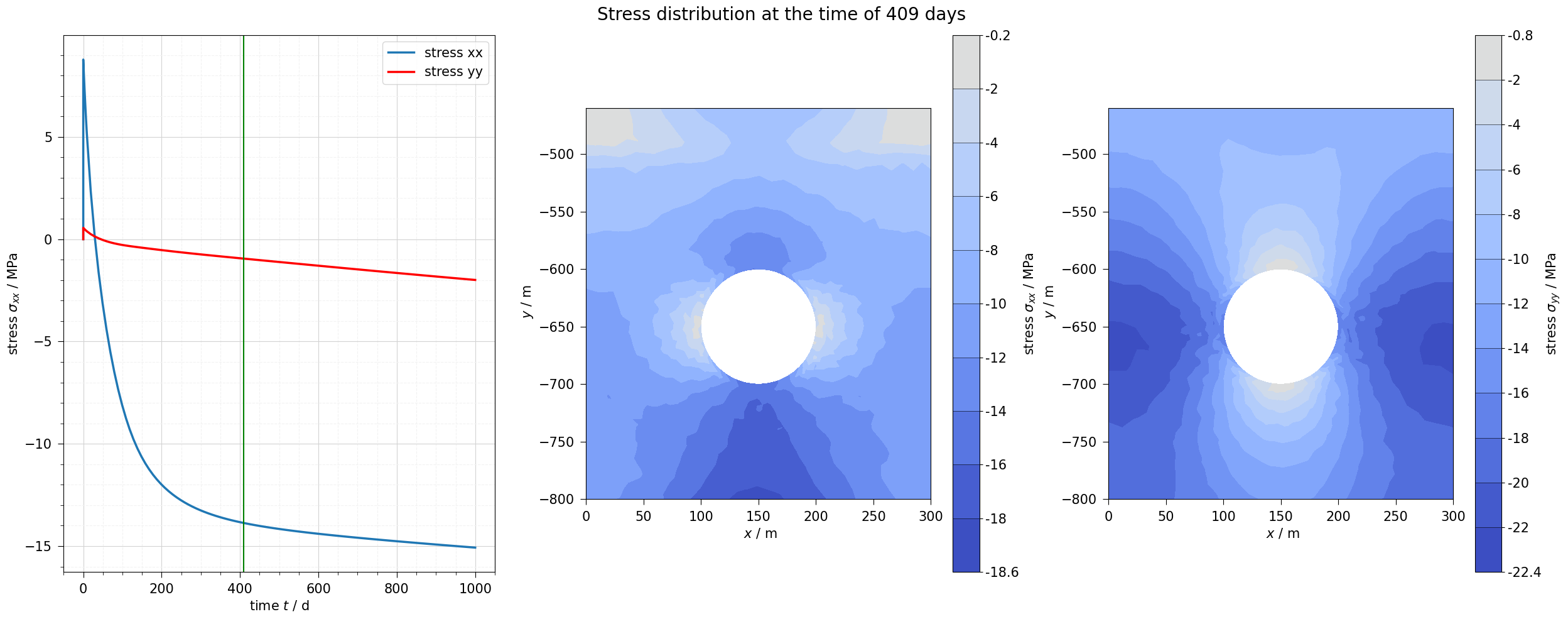

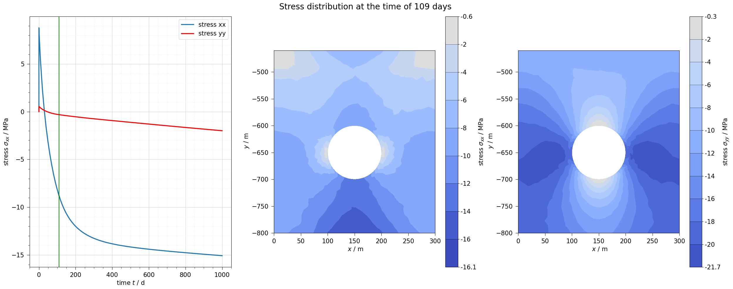

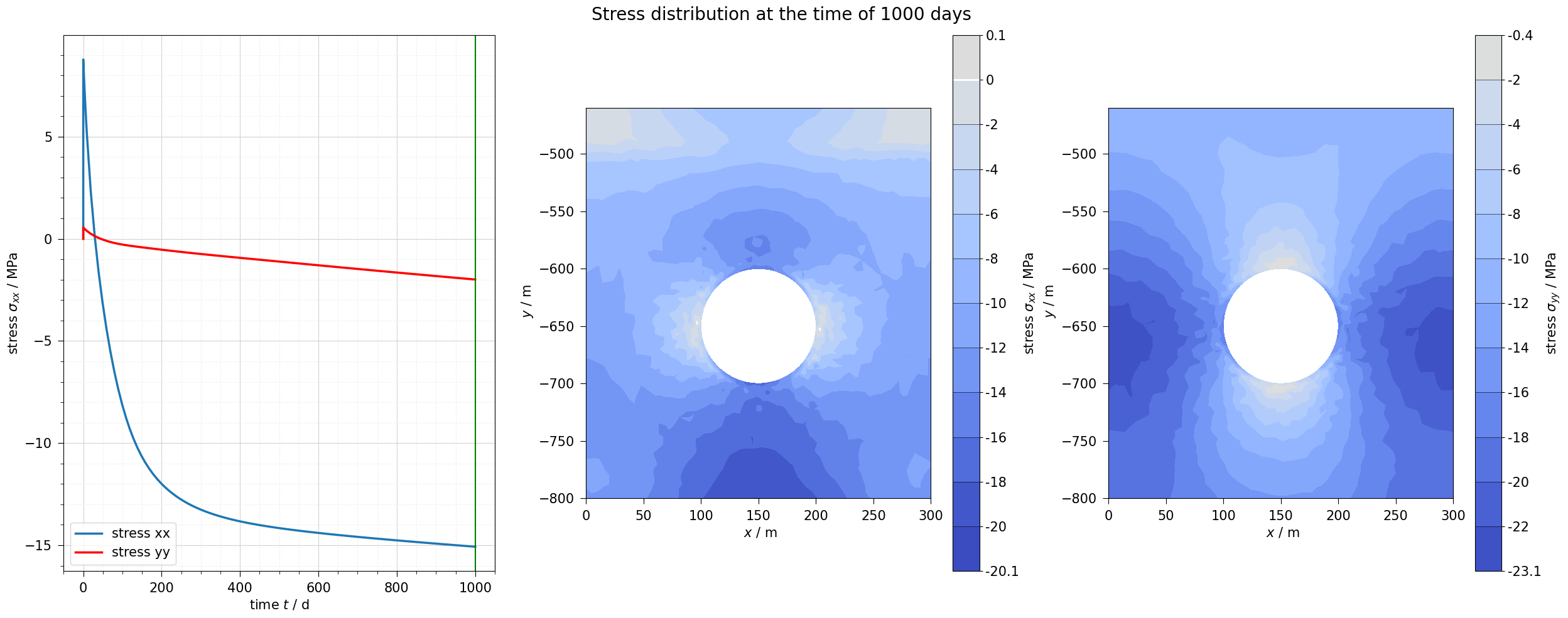

The following three figures are plotted by using the results of the simulation of 1000 days creep. The three figures display the distribution of horizontal and vertical stresses at times of 109 days, 409 days and 1000 days, respectively.

plt.show()Now the stress distributions at 109, 409, and 1000 days will be plotted:
# Stress distrubtion at 109 days
plot_stress_dist(109, mesh_109d)
# Stress distrubtion at 409 days
plot_stress_dist(409, mesh_409d)
# Stress distrubtion at 1000 days
plot_stress_dist(1000, mesh_1000d)

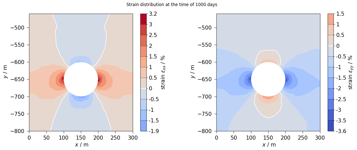

fig_strain, ax = plt.subplots(nrows=1, ncols=2, figsize=(15, 6))…
(click to toggle)
ot.plot.contourf(
mesh_1000d, ot.variables.strain["xx"], fig=fig_strain, ax=ax[0], fontsize=15
ot.plot.contourf(
mesh_1000d, ot.variables.strain["yy"], fig=fig_strain, ax=ax[1], fontsize=15
fig_strain.suptitle("Strain distribution at the time of 1000 days")
plt.tight_layout()

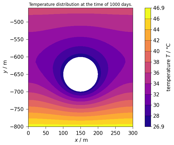

fig_temp, ax = plt.subplots(figsize=(10, 6))…
(click to toggle)
ot.plot.contourf(mesh_1000d, ot.variables.temperature, fig=fig_temp, ax=ax, fontsize=15)
ax.set_title("Temperature distribution at the time of 1000 days.")
plt.tight_layout()
