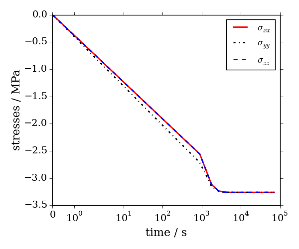

We solve a thermo-mechanical homogeneous model in cube domain. The dimensions of this cube model are 1 m in all directions. The boundary conditions and temperature loadings, as well as the material can refer Chapter 14 in Kolditz et al. for detailed problem description:

Result showing temperature and stresses development with time in the centre node of the model:
The analytical solution of stresses after heating is:
$$\begin{equation} \sigma_{xx} = \sigma_{yy} = \sigma_{zz} = - \frac{\alpha \Delta T E}{1 - 2 \nu} = - 3.260869\, \textrm{MPa} \end{equation}$$The relative error between the numerical simulation and the analytical solution is 9.2⋅10-13.
