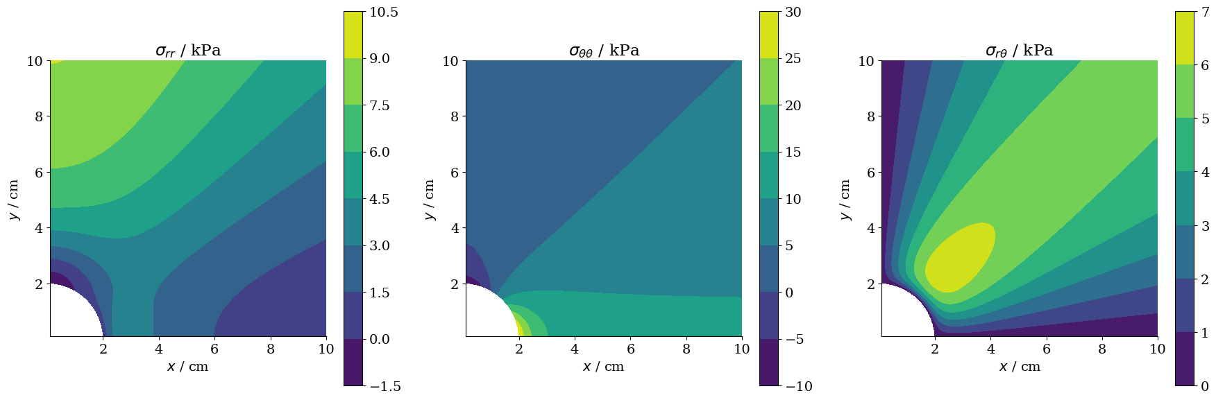

As a simple example we take the disc with a hole benchmark test case from our benchmark gallery. This benchmark analyzes the stress distribution emerging in a large two-dimensional disc that is stretched in the $y$ direction. The stress distributions (in polar coordinates) obtained in that test case are visualized in the figure below, the instructions to run OGS follow below the figure…
Stress distribution in polar coordinates of the disc with hole benchmark

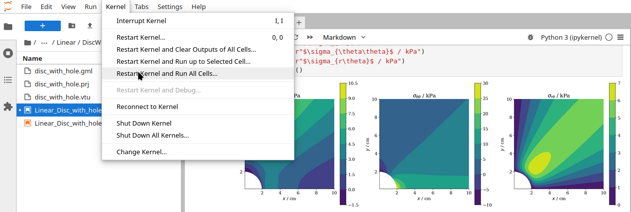

    The notebook already contains plots of the analytical solution to the problem and of OGS simulation results. You can play around with it, now. A good first step is to rerun the entire notebook (Restart Kernel and Run All Cells…, see figure below). This will run OGS – your first OGS run!
Run all cells in a Jupyter notebook

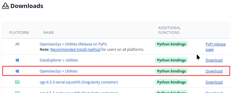

  1. Download the OGS binaries from our release page. Download the current windows binaries of OGS
