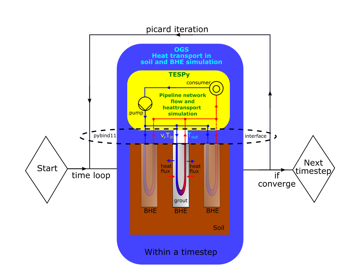

The work flow of the PipeNetwork feature is illustrated in Figure 2. To explicitly simulate both the BHE and the pipe network, OGS is coupled with the TESPy through a Python interface. Within every time step and each iteration, the outflow temperature Tout from each BHE is computed by OGS and transferred to TESPy via the interface. Then TESPy will use these Tout temperature and the current hydraulic state as the boundary condition imposed on the pipeline network to calculate the current inflow temperature Tin of each BHE and the currently flow rate, which satisfies the overall thermal load of the building. After the calculation, all data will be transferred back to OGS and update the inlet temperature and flow rate of each BHE for the next iteration. The convergence is set to be satisfied when the difference from the last two iteration results is smaller than a preset tolerance value. Additionally, OGS will transfer the currently time step ’t’ to TESPy within each iteration, which makes TESPy able to adjust its time dependent network boundary conditions according to the user’s configuration.
Work flow of the model with BHEs coupled with a pipe network
