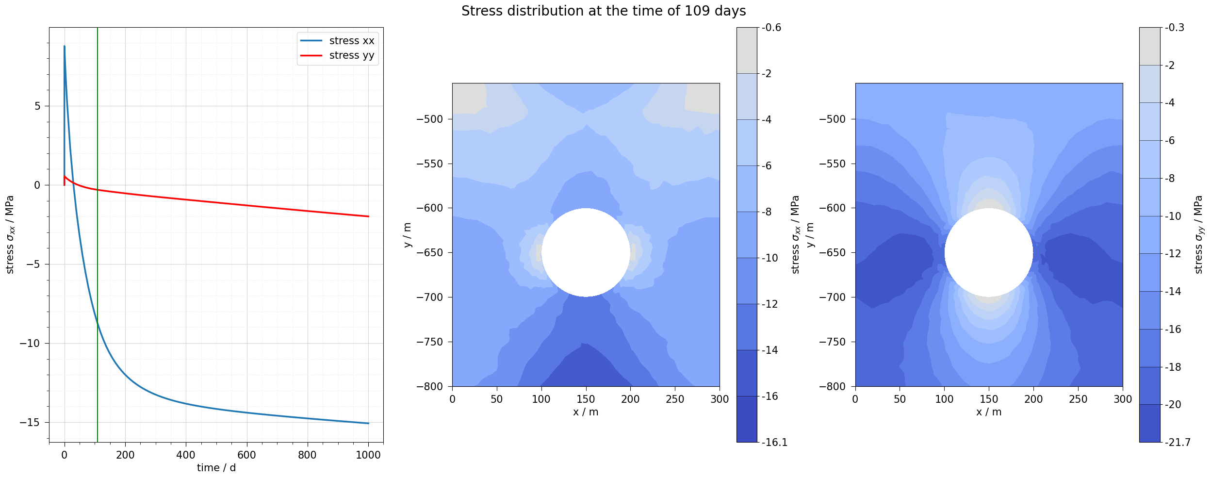

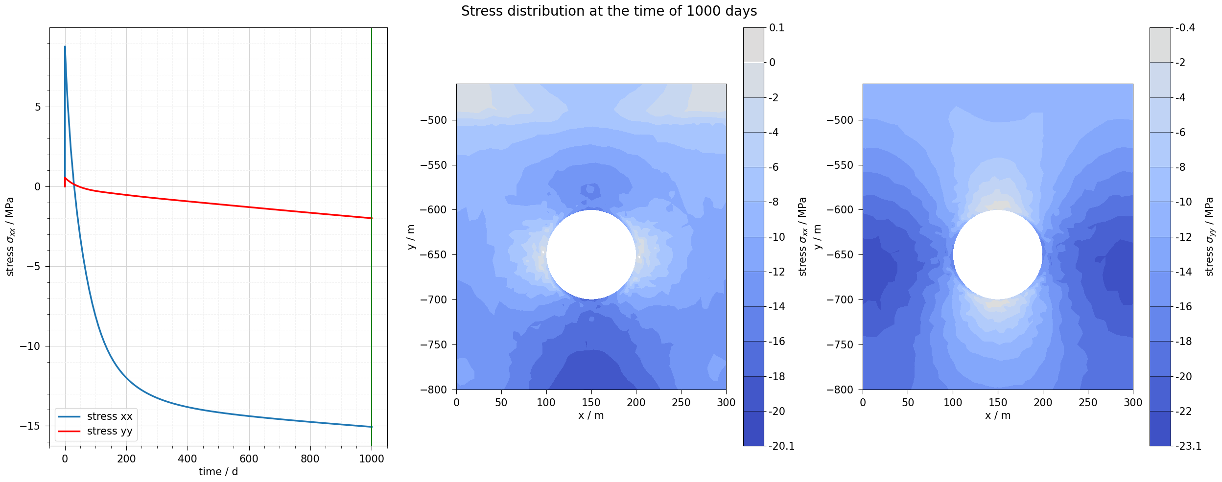

The following three figures are plotted by using the results of the simulation of 1000 days creep. The three figures display the distribution of horizontal and vertical stresses at times of 109 days, 409 days and 1000 days, respectively.

Now the stress distributions at 109, 409, and 1000 days will be plotted:
# Stress distrubtion at 109 days
plot_stress_dist(109, ms_109d)

# Stress distrubtion at 1000 days
plot_stress_dist(1000, ms_1000d)

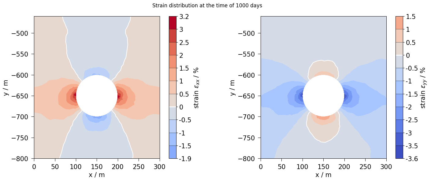

fig_strain, ax = plt.subplots(nrows=1, ncols=2, figsize=(15, 6))… (click to toggle)
ms_1000d.plot_contourf(ot.variables.strain["xx"], fig=fig_strain, ax=ax[0], fontsize=15)
ms_1000d.plot_contourf(ot.variables.strain["yy"], fig=fig_strain, ax=ax[1], fontsize=15)
fig_strain.suptitle("Strain distribution at the time of 1000 days")
plt.tight_layout()

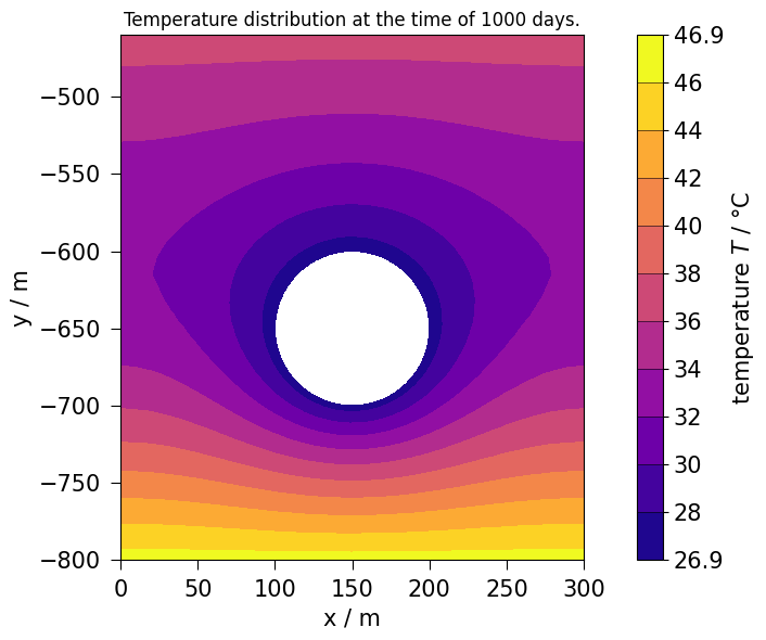

fig_temp, ax = plt.subplots(figsize=(10, 6))… (click to toggle)
ms_1000d.plot_contourf(ot.variables.temperature, fig=fig_temp, ax=ax, fontsize=15)
ax.set_title("Temperature distribution at the time of 1000 days.")
plt.tight_layout()
