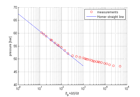

The permeability of the reservoir can be estimated by means of a Horner plot, in which the pressure $p$ is plotted against $(t_p+\Delta t)/\Delta t$, i.e. Horner time on a semi-logarithmic scale (cf. Figure 1). In the Horner plot, the data points form a straight line in the late-time period of the test. Note that the time increases in the opposite direction of the X-axis. Therefore, the linear section appears at the left side of the diagram.
\centering
Figure 1: Horner plot ($p$ vs $(t_p+\Delta t)/\Delta t$) for buildup test showing the inferred Horner straight line
The slope $m$ of the Horner straight line is expressed as:
$$m=0.1832\frac{Q\mu}{\kappa b}$$in which $Q\ \mathrm{[L^3/T]}\ (Q>0)$ is the production rate of the well before shut-in, $\kappa\ \mathrm{[L^2]}$ is the permeability and $b\ \mathrm{[L]}$ is the aquifer thickness. From the Horner plot, we can infer a Horner straight line with a slope of $m=0.79$. Therefore the transmissivity of the aquifer can be calculated as
$$\begin{aligned} \kappa b&=&0.1832\frac{Q\mu}{m}=0.1832\frac{((78000/3600)/78.68)\times1.295\times10^{-4}}{7.09\times10^5}\\&=&9.2\times10^{-12}\ \mathrm{m^3}\end{aligned}$$In addition, the straight line in the Horner plot can be extracted to a Horner time of 1, which corresponds to the infinite shut-in time $(\Delta t)$. This leads to an extrapolated pressure $p_0$ of $67.5~\mathrm{kPa}$, which is the undisturbed reservoir pressure .

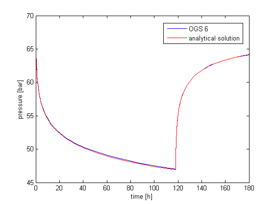

The pressure buildup test is comparable to a pumping recovery test as the extraction rate is first kept constant at $Q$, and then becomes zero at $t=t_p$. This benchmark then adopts the same assumptions as in the Theis' problem. The analytical solution of the pressure difference $\Delta p$ with respect to the initial pressure $p_0$ is the sum of two Theis curves: one starting at $t=0$ and another starting at $t=t_p$ but with an opposite extraction rate, i.e. for $t\leq t_p$,
$$\Delta p=\rho g \frac{-Q}{4\pi T}W\left(\frac{r^2S}{4Tt}\right)$$and for $t>t_p$,

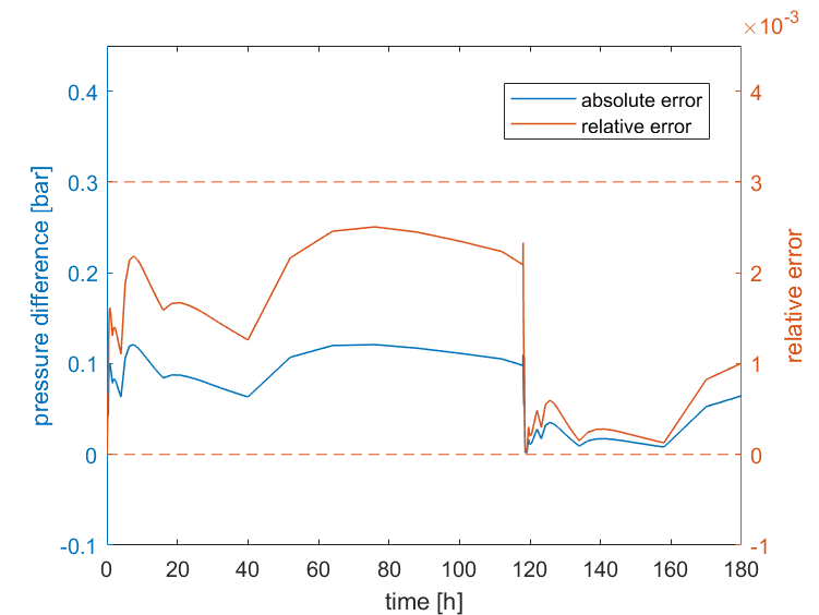

$$\Delta p=\rho g \frac{-Q}{4\pi T}W\left(\frac{r^2S}{4Tt}\right)+\rho g \frac{Q}{4\pi T}W\left(\frac{r^2S}{4T(t-t_p)}\right)$$The pressure evolution is simulated throughout the domain and the result is compared with the analytical solution at $r=10.287\ \mathrm{m}$. In Figure 2, it can be observed that the numerical model fits with the analytical solution very well. The absolute and relative error between the analytical and numerical solution is depicted in Figure 3.
Figure 2: OGS 6 result compared with analytical solution
Figure 3: Absolute and relative error
