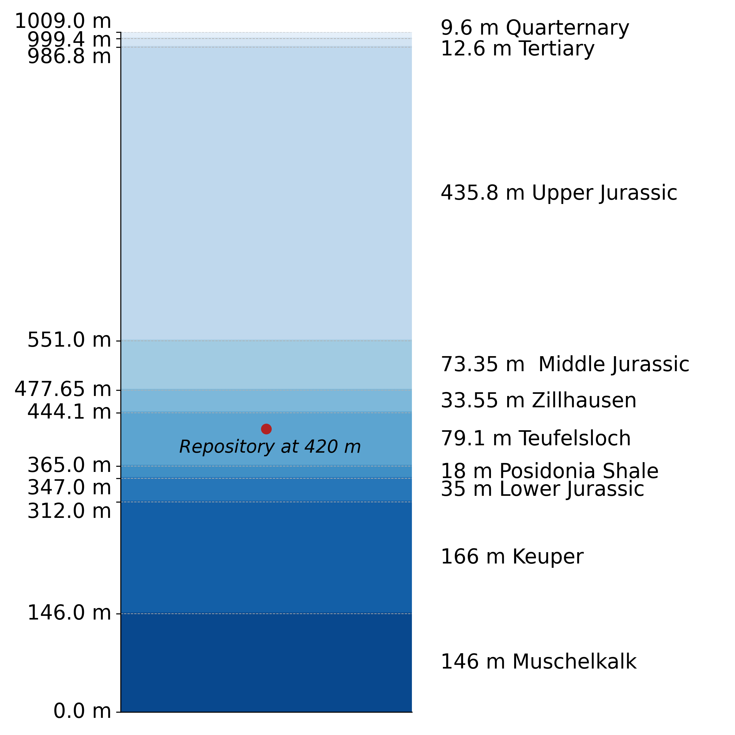

The figure below shows the simplified stratigraphic profile representing the example geology: Domain

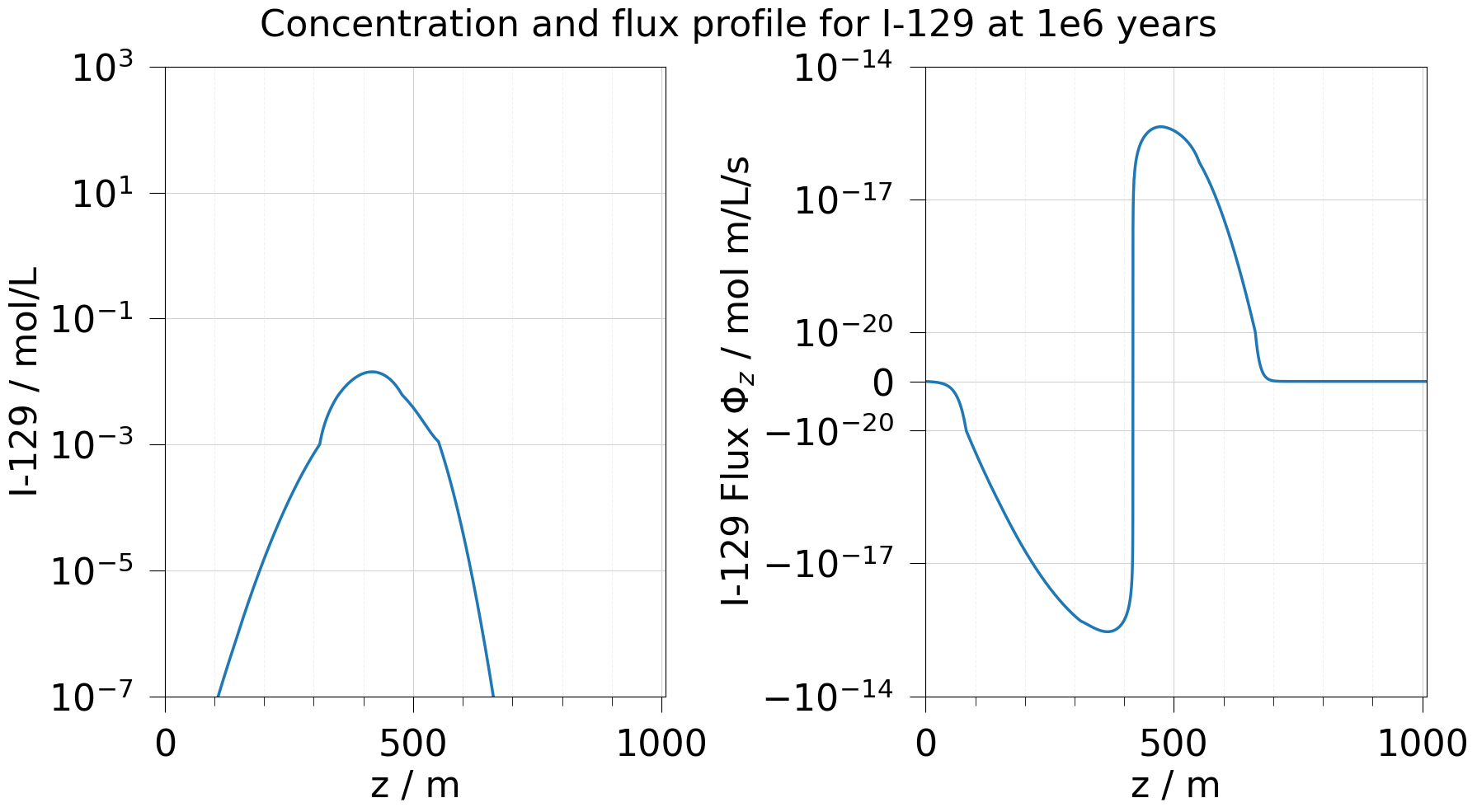

Spatial profile of Iodide-129 and Iodide-129 flux ($\Phi_z$)
z_points = ms.mesh(0).points[:, 2]… (click to toggle)
fig, ax = plt.subplots(ncols=2, figsize=(18, 10))
ot.plot.line(ms, "z", I129, ax=ax[0])
ax[0].set_xlim(z_points.min(), z_points.max())
ax[0].set_yscale("log")
ax[0].set_ylim(1e-7, 1e3)
ot.plot.line(ms, "z", I129Flux["z"], ax=ax[1])
ax[1].set_ylim(-1e-14, 1e-14)
ax[1].set_yscale(
    "symlog", linthresh=10**-20
)  # By this, the y-axis is logarithmitic outside of [-1e-20,1e-20], and linear otherwise, however, some artifacts of double-plotting are there
ax[1].set_xlim(z_points.min(), z_points.max())
fig.suptitle("Concentration and flux profile for I-129 at 1e6 years", fontsize=32)
# Fix fontsizes

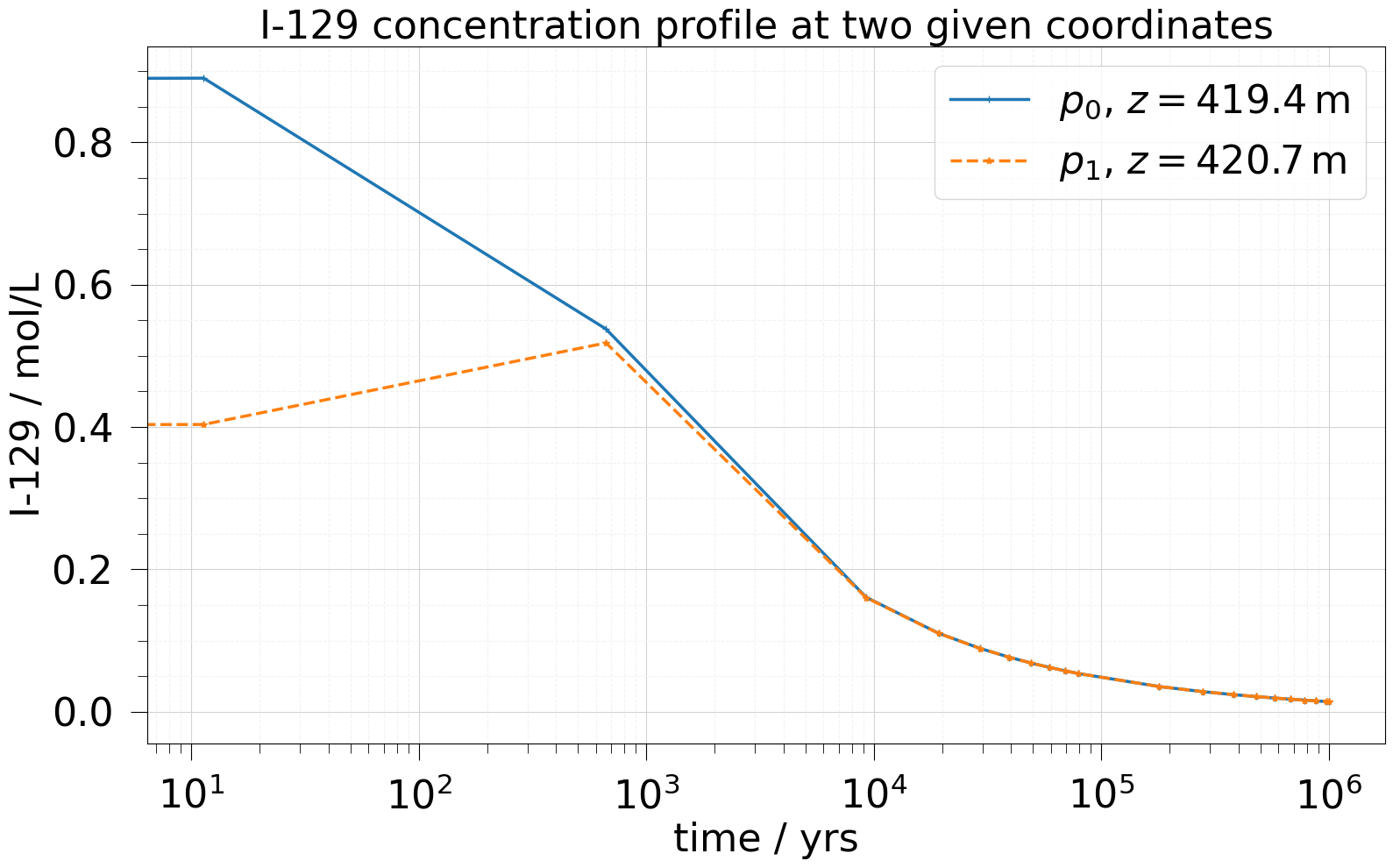

As stated earlier, our repository is located at a depth of $420 \mathrm{m}$.
In this section, we will probe the Iodide-129 concentration at two nearby points using the ogstools method MeshSeries.extract_probe. Let the points be: $p_0 = (0, 0, 419.4\,\mathrm{m})$ and $p_1 = (0, 0, 420.7\,\mathrm{m})$
points = np.array([(0.0, 0.0, 419.4), (0.0, 0.0, 420.7)])… (click to toggle)
labels = [rf"$p_{i}$, $z = {pt[2]}\,$m" for i, pt in enumerate(points)]
ms_pts = [ot.MeshSeries.extract_probe(ms_pvd, pts, I129) for pts in points]
fig, ax = plt.subplots(figsize=(16, 10))… (click to toggle)
ot.plot.line(ms_pts[0], "time", I129, ax, label=labels[0], color="C0", marker="+")
ot.plot.line(
    ms_pts[1], "time", I129, ax, label=labels[1], color="C1", marker="*", linestyle="--"
ax.set_xscale("log")
ax.set_title("I-129 concentration profile at two given coordinates")
# Fix fontsizes

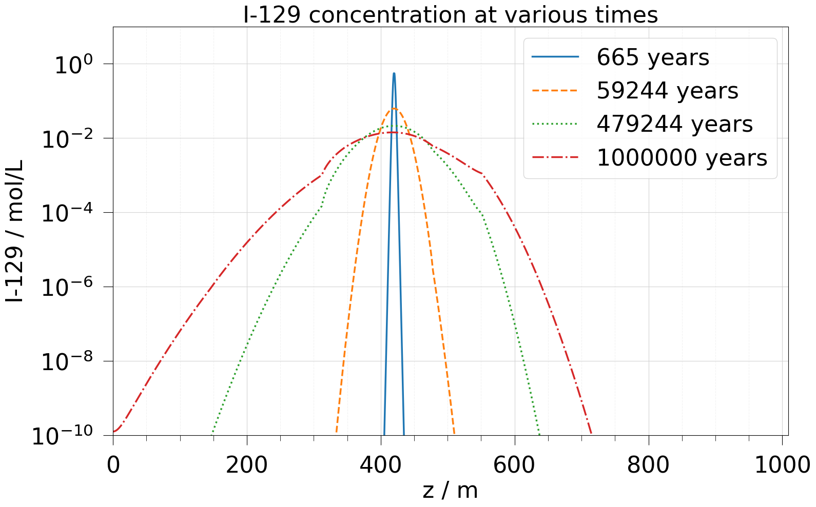

The .PVD file contains 21 time steps ranging from $0$ to $10^6$ years. We will now plot the profile at multiple time steps.
style_cycler = ot.plot.utils.get_style_cycler(min_number_of_styles=4)… (click to toggle)
timevalues = ms_pvd.timevalues
timesteps_to_probe = ms_pvd.timesteps[2::6]
meshes = [ms_pvd.mesh(ts) for ts in timesteps_to_probe]
labels = [f"{np.round(timevalues[ts], 0):.0f} years" for ts in timesteps_to_probe]
fig, ax = plt.subplots(ncols=1, figsize=(16, 10))
for mesh, label, style in zip(meshes, labels, style_cycler, strict=True):
    ot.plot.line(
        mesh,
        "z",
        I129,
        label=label,
        ax=ax,
        color=style["color"],
        linestyle=style["linestyle"],
ax.set_xlim(z_points.min(), z_points.max())
ax.set_yscale("log")
ax.set_ylim(1e-10, 1e1)
ax.set_title("I-129 concentration at various times")
# Fix fontsizes

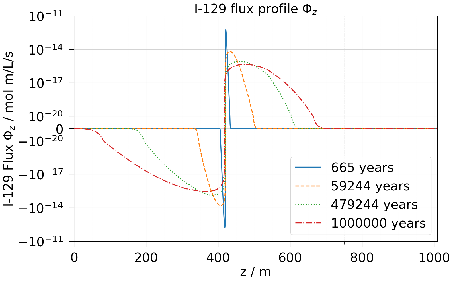

Similarly, we can create a plot illustrating the I-129 flux ($\Phi_z$) over multiple time steps till $10^6$ years.
    ot.plot.line(
        mesh,
        "z",
        I129Flux["z"],
        label=label,
        ax=ax,
        loc="lower right",
fig.axes[0].set_yscale(
# of double-plotting are there
fig.axes[0].set_ylim(-1e-11, 1e-11)
fig.axes[0].set_xlim(z_points.min(), z_points.max())
fig.axes[0].set_title(r"I-129 flux profile $\Phi_z$")
# Fix fontsizes
ot.plot.utils.update_font_sizes(fig.axes[0])

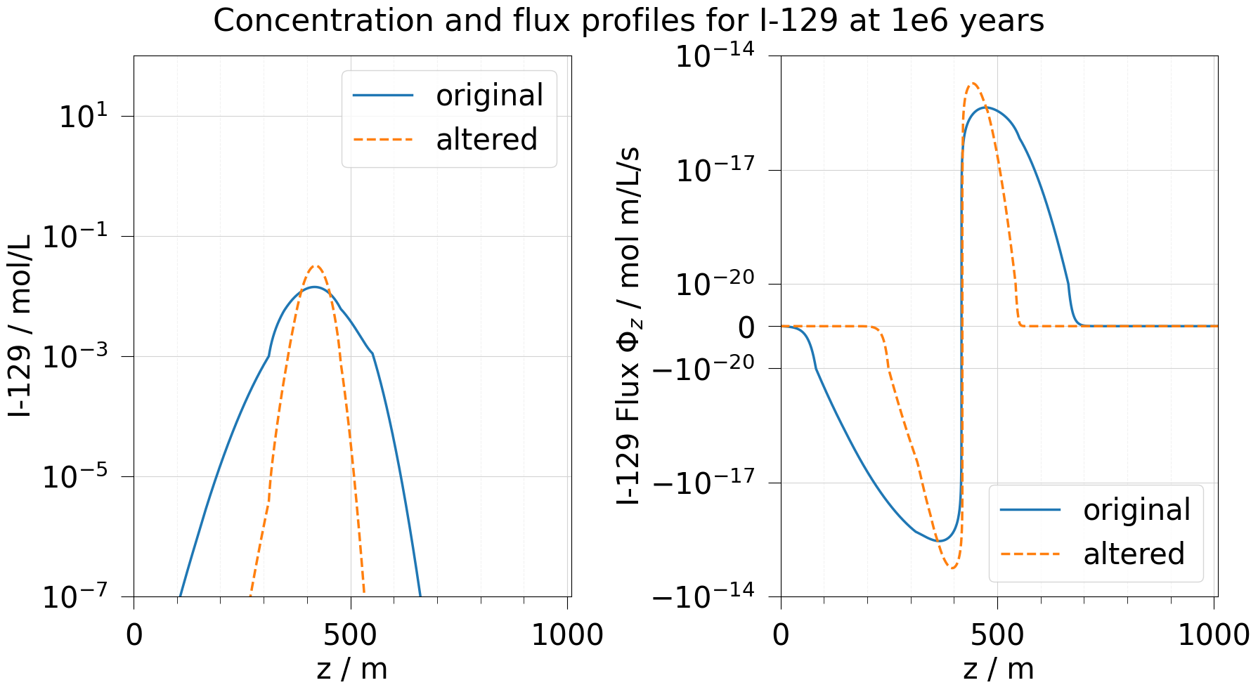

In the current model, the parameters that can be varied are retardation_factor, pore_diffusion, and porosity. In some cases, one might also modify the geometry, which involves changing the media IDs in the input .vtu files rather than in the .prj file.
In this example, we adjust the retardation factors of the layers from our original setup. This is for demonstration purposes only and does not reflect any physical justification.
property_to_vary = "retardation_factor"… (click to toggle)
retardation_factors_per_layer = np.arange(1.0, 11.0, 1.0)
no_of_parameter_variations = 1
no_of_layers = 10  # equal to number of material IDs, does not necessarily be layers, if the domain is 2D or 3D
for _ in range(no_of_parameter_variations):
        input_file=project_file_modified, output_file=project_file_modified
    for j in range(no_of_layers):
        model.replace_text(
            retardation_factors_per_layer[j],
            xpath="./media/medium/phases/phase/components/component/properties/property[name='retardation_factor']/value",
            occurrence=j,
        # please be aware that as such the "includes" in the ".prj"-file are not kept, but everything is written
        # directly in the ".prj"-file only, which should be fine for surrogate modelling though, and maybe even easier.
    model.run_model(args=f"-m {project_dir} -o {out_dir_modified}")
Simulation: modified/Iodide129_main_altered.prj

In this example, we will now compare the I-129 spatial concentration profile.
fig, ax = plt.subplots(ncols=2, figsize=(18, 10))… (click to toggle)
ot.plot.line(ms_pvd[-1], "z", I129, label="original", ax=ax[0], color="C0")
ot.plot.line(
    ms_altered[-1],
    "z",
    I129,
    label="altered",
    ax=ax[0],
    color="C1",
    linestyle="--",
    fontsize=30,
ax[0].set_ylim(1e-7, 1e2)
ot.plot.line(ms_pvd[-1], "z", I129Flux["z"], label="original", ax=ax[1], color="C0")
ot.plot.line(
    ms_altered[-1],
    "z",
    I129Flux["z"],
    label="altered",
    ax=ax[1],
    color="C1",
    linestyle="--",
    fontsize=30,
ax[1].set_yscale(
fig.suptitle("Concentration and flux profiles for I-129 at 1e6 years", fontsize=32)
