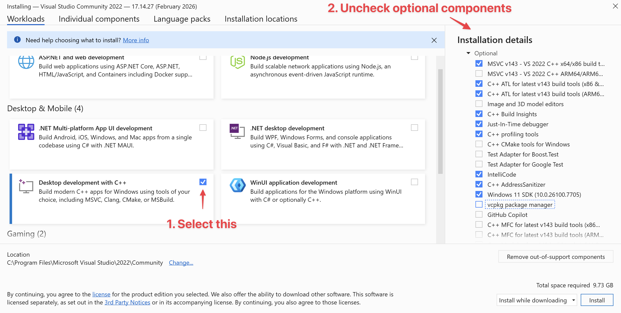

As we use lots of features of the C++20-standard we support Visual Studio 2022 with compiler version 19.24 and up. Therefore you will need at least Windows 7 (64-bit required). It is perfectly fine to use the free Community Edition of Visual Studio.
  • Download and install Visual Studio Community
    • Select the workload Desktop Development with C++
    • You can uncheck everything else
  • When installation finished please start Visual Studio once (when asked for credentials enter your Microsoft account or click on Skip for now)

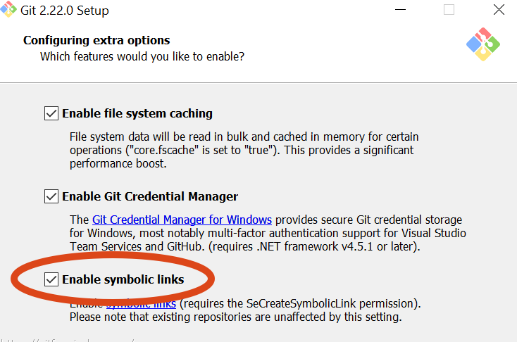

Download and install git from the git homepage. Use the default installer options but also enable Enable symbolic links under the Configuring extra options page.
Enable symbolic links option
This install a new command line called Git Bash which should be used for all git operations.

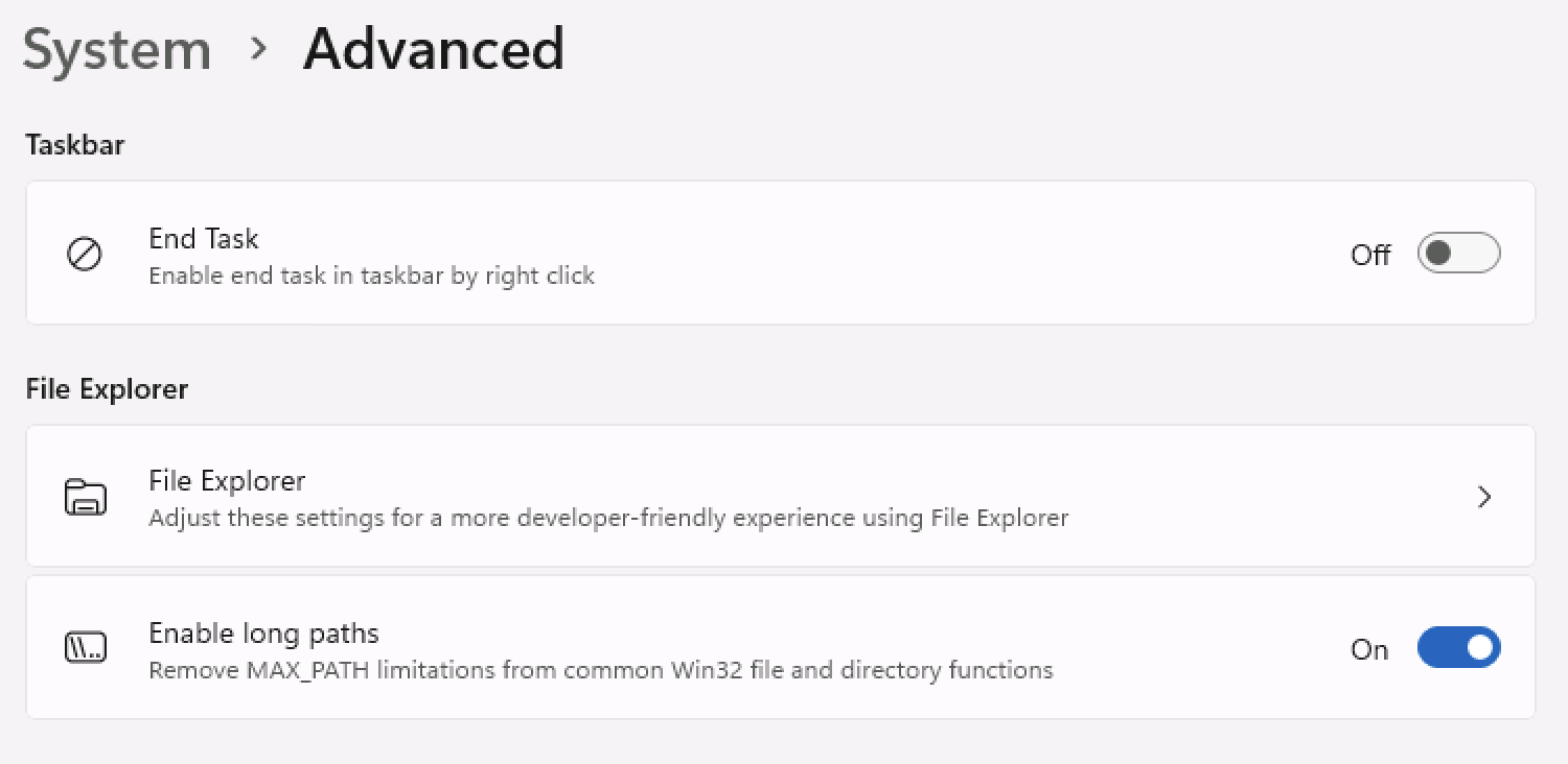

Enable the long paths feature:
git config --global core.longpaths true
You may also have enable the long paths feature in the Windows registry.
