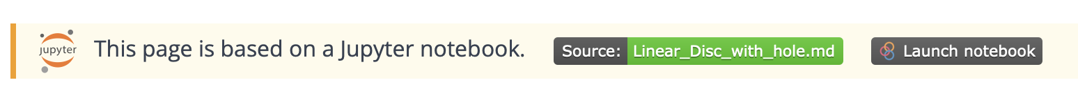

Run a notebook in BinderHub
On the web site or MR web previews on pages generated by a notebook there is a new banner:
Notebook web banner with BinderHub launch button
  • Click the button to launch the notebook in BinderHub.
  • The environment running in BinderHub is defined in bilke/binder-ogs-requirements at GitHub
  • When clicking the link it launches a Jupyter Lab instance pre-configured with ogs via wheel, clones the current ogs repo in it and opens the respective notebook ready to run. Please note that startup times may be several minutes (if the execution environment is not already built and cached) and the computing resources are limited. Currently only the serial ogs configuration is available.
