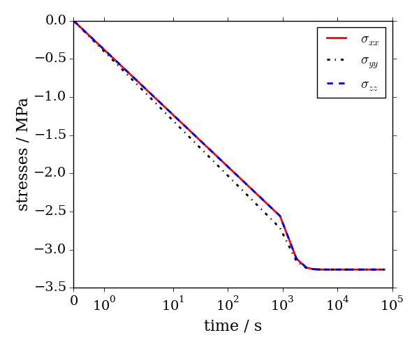

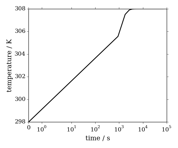

Result showing temperature and stresses development with time in the centre node of the model:
The analytical solution of stresses after heating is:
$$\begin{equation} \sigma_{xx} = \sigma_{yy} = \sigma_{zz} = - \frac{\alpha \Delta T E}{1 - 2 \nu} = - 3.260869\, \textrm{MPa} \end{equation}$$The relative error between the numerical simulation and the analytical solution is 9.2⋅10-13.
