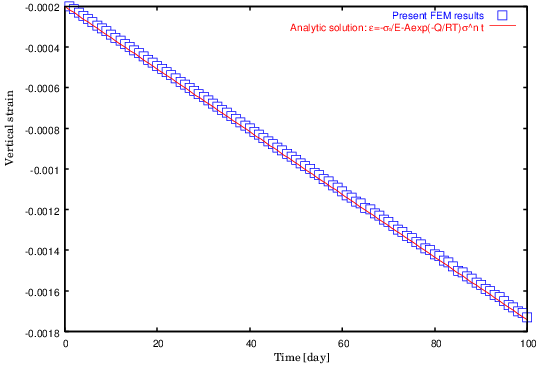

We verify the scheme by a one dimensional extension with constant pressure of ${ \sigma}_0=5 ~\mbox{MPa}$. The values of the parameters are given as $A=0.18 \mbox{d}^{-1}$, $m=5$, $Q=54 ~\mbox{kJ/mol}$, $E=25000 ~\mbox{MPa}$, and the temperature is constant everywhere of 100 $^{\circ}\mbox{C}$. The analytical solution of the strain is given straightforward as
$$\begin{gathered} { \epsilon}=-\dfrac{{ \sigma}_0}{E}-Ae^{-Q/RT}{ \sigma}_0^m t \end{gathered}$$
The problem is solved as an axisymmetric one. Therefore
$$\begin{gathered} { \epsilon_z}=-\dfrac{{ \sigma}_0}{E}-Ae^{-Q/RT}{ \sigma}_0^m t \end{gathered}$$
Because of
$$\begin{gathered} \lambda\epsilon_v^e+2G\epsilon_r^e=\lambda\epsilon_v^e+2G\epsilon_t^e=0 \end{gathered}$$
we have
$$\begin{gathered} \epsilon_r^e=\epsilon_t^e \end{gathered}$$
and
$$\begin{gathered} \sigma_z=2G(\epsilon_z^e-\epsilon_r^e)=2G(\epsilon_z^e-\epsilon_t^e) \end{gathered}$$
with $\epsilon^e=\epsilon-\epsilon^c$, where superscript $e$ means elasticity and $c$ means creep. With the creep strain formulas that are presented in the above context, the analytical solutions of the other main strains are
$$\begin{gathered} { \epsilon_r}={ \epsilon_t}=\frac{\sigma_0}{2G}+\epsilon_z+ \frac{3}{2}A e^{-Q/RT}\sigma_0^m t \end{gathered}$$
The comparison of the result of $\epsilon_z$ obtained by the present multidimensional scheme with the analytical solution is shown in the following figure:
