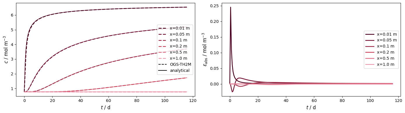

Concentration vs. time at different locations
obs_pts = np.asarray([(x, 0, 0) for x in [0.01, 0.05, 0.1, 0.2, 0.5, 1.0]])(click to toggle)
num_values = concentration(ms.probe(obs_pts, "xmWL").T)
ref_values = [Diffusion(x, ms.timevalues) for x in obs_pts[:, 0]]
reds = ["#4a001e", "#731331", "#9f2945", "#cc415a", "#e06e85", "#ed9ab0"]
time = ms.timevalues / 3600 / 24
plot_results_errors(time, num_values, ref_values, leg_labels, "$t$ / d", reds)

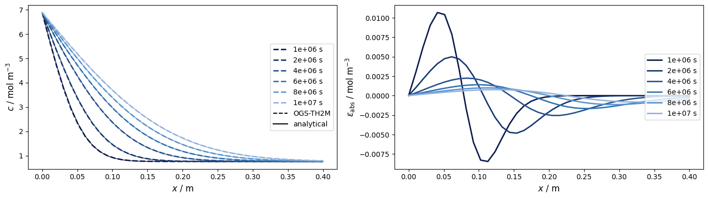

Concentration vs. location at different times
timevalues = np.asarray([1e6, 2e6, 4e6, 6e6, 8e6, 1e7])(click to toggle)
xs = np.linspace(0, 0.4, 40)
line = pv.PointSet([(x, 0, 0) for x in xs])
num_values = [concentration(line.sample(ms[ts])["xmWL"]) for ts in timesteps]
ref_values = [Diffusion(xs, tv) for tv in timevalues]
leg_labels = [f"{tv:.0e} s" for tv in timevalues]
blues = ["#0b194c", "#163670", "#265191", "#2f74b3", "#5d94cb", "#92b2de"]
plot_results_errors(xs, num_values, ref_values, leg_labels, "$x$ / m", blues)
The numerical approximation approaches the exact solution quite well. Deviations can be reduced if the resolution of the temporal discretisation is increased.

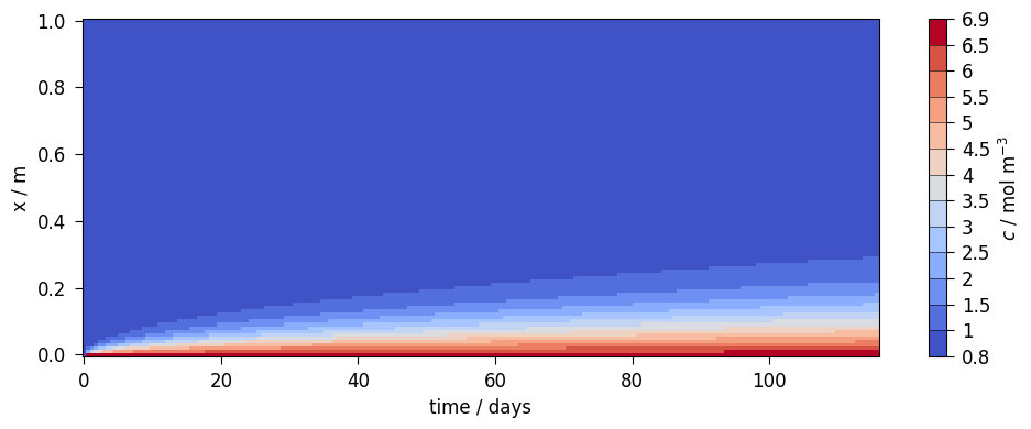

Concentration over time and space
pts = np.linspace([0.0, 0.0, 0.0], [0.3, 0.0, 0.0], 500)(click to toggle)
var = ot.variables.Scalar("xmWL", func=concentration)
fig = ms.scale(time=("s", "days")).plot_time_slice(
    "time", "x", var, figsize=[10, 4], fontsize=12
fig.axes[1].set_ylabel("$c$ / mol m$^{-3}$")
