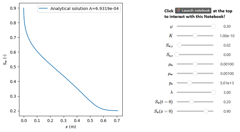

The analytical solution is calculated according to McWhorter and Sunada. The initial saturation is Si in the domain. At $t=0$ the saturation at $x=0$ becomes S0. The analytical solution is calculated for $t=1000$ s.
def plot_f(mun, muw, K, phi, lambda_, Pe, S0, Si, Snr, Swr, **kwargs):… (click to toggle)
    model = BrooksCorey(Pe, lambda_, Snr, Swr)
    problem = McWhorter(model, phi, K, muw, mun, S0, Si)
    problem.plot_solution()
# Creating sliders for interactive plots based on the DataFrame
sliders = {}
lock = threading.RLock()  # Prevent update loops
# Residual Saturations Snr, Swr limit values for Initial and boundary saturation Si, S0
def update_constraints(_change):
    with lock:
        try:
            # Calculate new bounds from current constraint values with small buffer
            buffer = 0.001
            min_bound = sliders["Swr"].value + buffer
            max_bound = 1 - sliders["Snr"].value - buffer
            # Update constraints, Values are automatically set according to range
            with sliders["Si"].hold_trait_notifications():
                sliders["Si"].min = min_bound
                sliders["Si"].max = min(max_bound, sliders["S0"].value)  # S0 > Si!
            with sliders["S0"].hold_trait_notifications():
                sliders["S0"].min = max(min_bound, sliders["Si"].value)  # S0 > Si!
                sliders["S0"].max = max_bound
        except Exception as e:
            print(f"Constraint update failed: {e}")
# Initialize sliders
for _idx, row in parameter_table.iterrows():
    key = row["Key"]
    sym = row["Symbol"]
    label = rf"\({sym}\)"
    if row["Scale"] == "log":
        slider = widgets.FloatLogSlider(
            value=row["Value"],
            base=10,
            min=np.log10(row["Range min"]),
            max=np.log10(row["Range max"]),
            step=0.01,
            description=label,
        slider = widgets.FloatSlider(
            value=row["Value"],
            min=row["Range min"],
            max=row["Range max"],
            step=0.01,
            description=label,
    # Add observers for constraint sliders
    if key in ["Swr", "Snr", "Si", "S0"]:
        slider.observe(update_constraints, names="value")
    sliders[key] = slider
update_constraints(None)
if "OGS_TESTRUNNER" in os.environ:  # static plot
    params = {k: v.value for k, v in sliders.items()}
        params["Pe"],
        params["lambda_"],
        params["Snr"],
        params["Swr"],
        model,
        params["phi"],
        params["K"],
        params["muw"],
        params["mun"],
        params["S0"],
        params["Si"],
    img = mpimg.imread("figures/slider.png")
    fig, axes = plt.subplots(1, 2, figsize=(10, 5))
    axes[1].imshow(img)
    axes[1].axis("off")  # Achsen ausblenden
    plt.sca(axes[0])
else:  # interactive plot
    # Display sliders and plot
    ui = widgets.VBox(list(sliders.values()))
    out = widgets.interactive_output(plot_f, sliders)
    display(widgets.HBox([out, ui]))

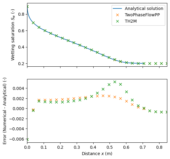

Evaluation and Results
# 1. Plot analytical solution… (click to toggle)
plotter = plot_with_error(
    x_ref,
    Sw_ref,
    "C0-",
    "Analytical solution",
    "Distance $x$ (m)",
    "Wetting saturation $S_w$ (-)",
    "Error (Numerical - Analytical) (-)",
# 2. Read results from TwoPhaseFlowPP
labels = ["TwoPhaseFlowPP", "TH2M"]
results = [
    "twophaseflow_test_t_1000.000000.vtu",
    "result_McWhorter_H2_ts_110_t_1000.000000.vtu",
