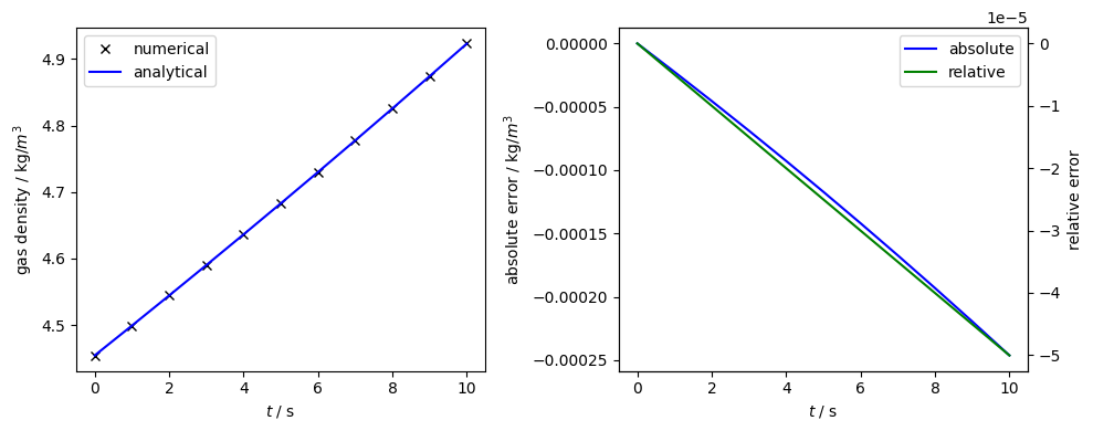

Gas density evolution
rho_g = ot.variables.Scalar("gas_density", r"kg/$m^3$", r"kg/$m^3$")
plot_results_errors(rho_g, gas_density(ms.timevalues))

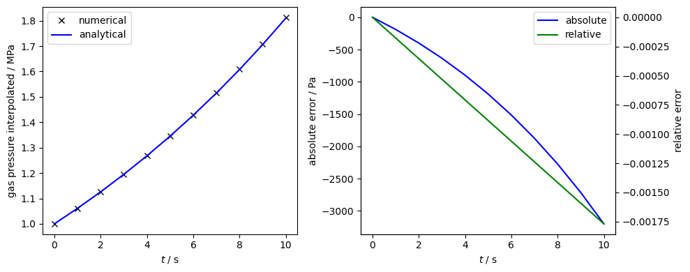

Gas pressure evolution
p_g = ot.variables.Scalar("gas_pressure_interpolated", "Pa", "MPa")
plot_results_errors(p_g, gas_pressure(ms.timevalues))

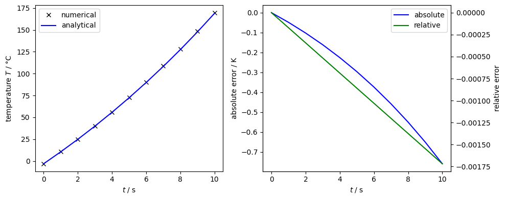

Temperature evolution
plot_results_errors(ot.variables.temperature, temperature(ms.timevalues))
