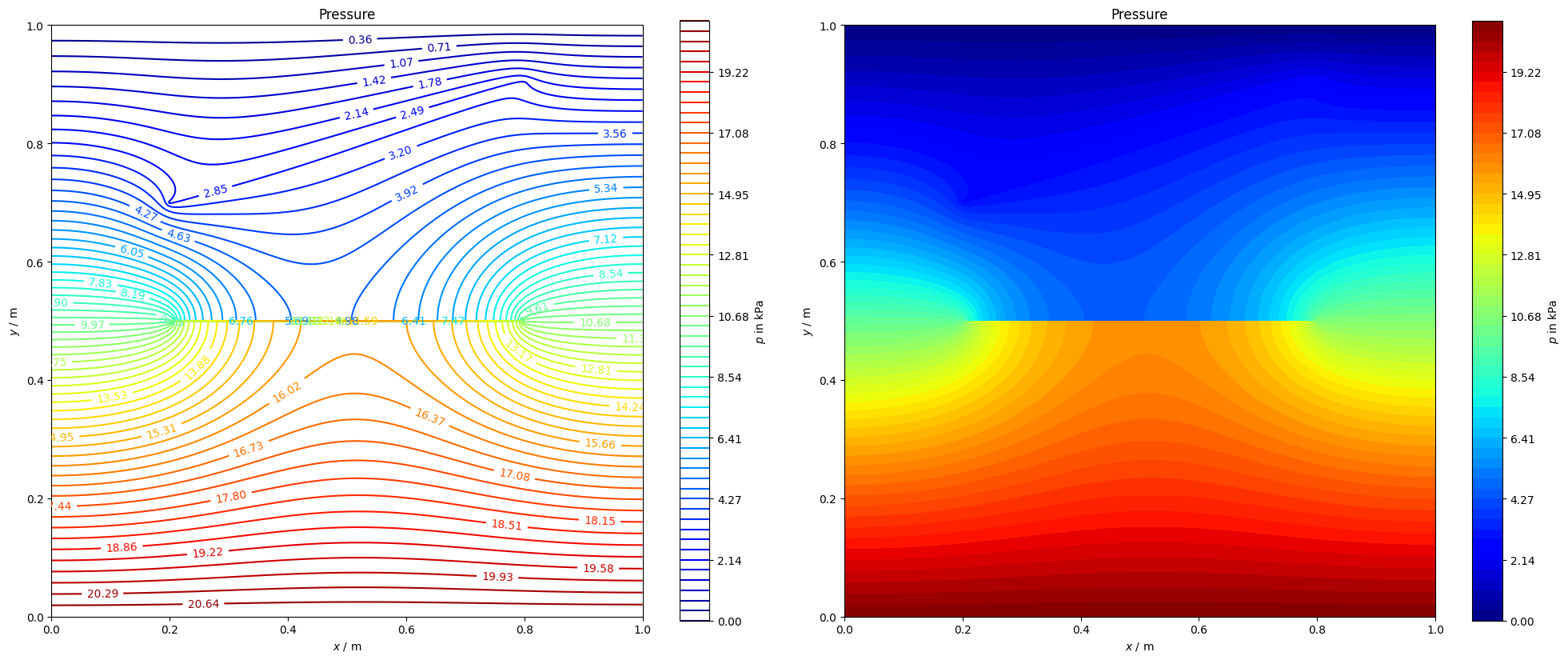

# Post-Processing(click to toggle)
# Post-Processing
levels = np.linspace(np.min(field), np.max(field), 60)
levelsf = np.linspace(np.min(field), np.max(field), 60)
fig, ax = plt.subplots(ncols=2, figsize=(20, 8))
contour = ax[0].tricontour(triang, field, levels=levels, cmap=plt.cm.jet)
contourf = ax[1].tricontourf(triang, field, levels=levelsf, cmap=plt.cm.jet)
plt.clabel(contour, fontsize=10, inline=1)
fig.colorbar(contour, ax=ax[0], label="$p$ in kPa")
fig.colorbar(contourf, ax=ax[1], label="$p$ in kPa")
ax[0].set_title("Pressure")
ax[1].set_title("Pressure")
for i in range(2):
    ax[i].set_aspect("equal")
    ax[i].set_ylabel("$y$ / m")
    ax[i].set_xlabel("$x$ / m")

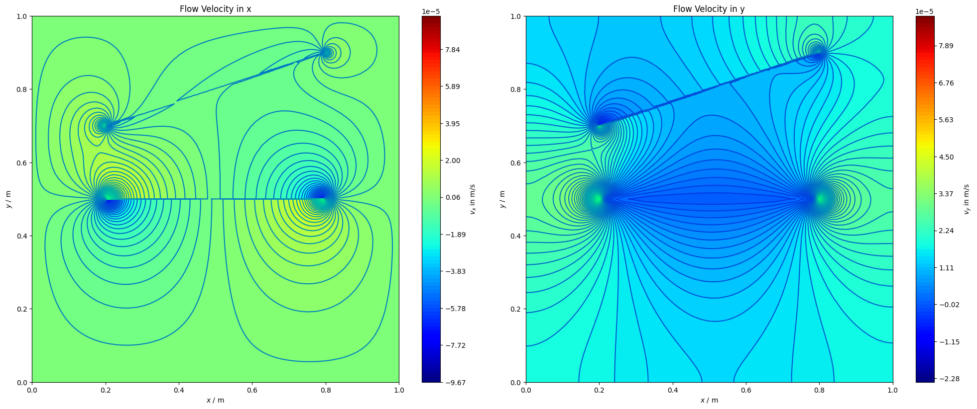

# Post-Processing (Velocities Fields in Conducting and Blocking Fracture)(click to toggle)
levels_x = np.linspace(np.min(fieldx), np.max(fieldx), 100)
levels_y = np.linspace(np.min(fieldy), np.max(fieldy), 100)
contour_x = ax[0].tricontourf(triang, fieldx, levels=levels_x, cmap=plt.cm.jet)
contour_y = ax[1].tricontourf(triang, fieldy, levels=levels_y, cmap=plt.cm.jet)
contour = ax[0].tricontour(triang, fieldx, levels=levels_x, cmap=plt.cm.winter)
contour = ax[1].tricontour(triang, fieldy, levels=levels_y, cmap=plt.cm.winter)
fig.colorbar(contour_x, ax=ax[0], label="$v_x$ in m/s")
fig.colorbar(contour_y, ax=ax[1], label="$v_y$ in m/s")
ax[0].set_title("Flow Velocity in x")
ax[1].set_title("Flow Velocity in y")
for i in range(2):

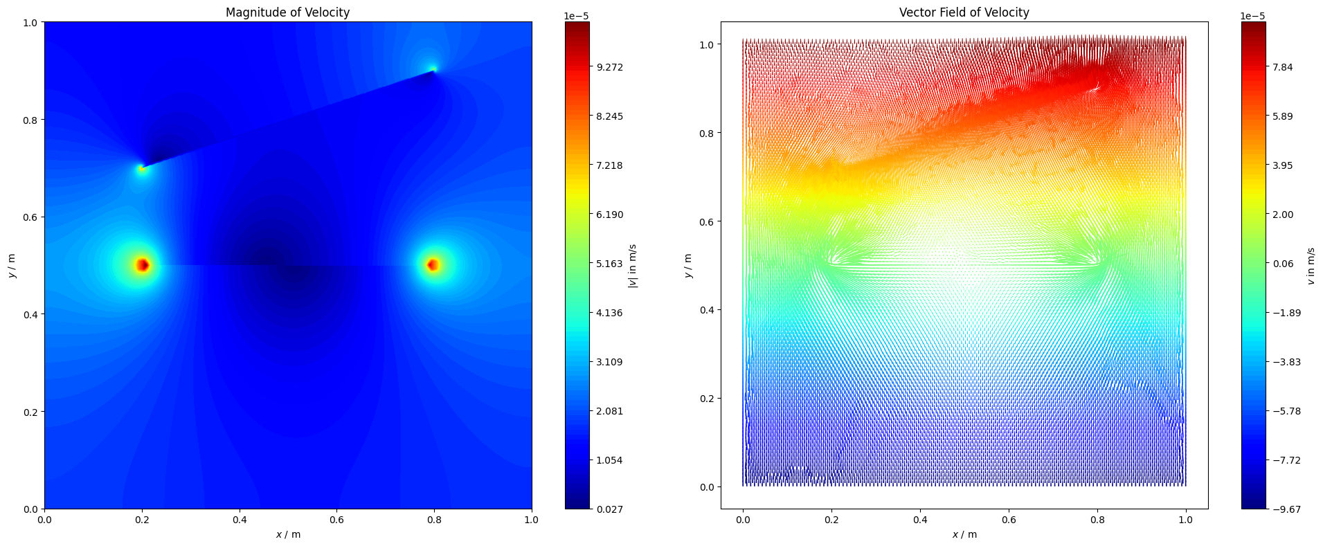

# Calculate the magnitude of the velocity vector fieldlevels = np.linspace(np.min(field), np.max(field), 58)
vmag = np.sqrt(fieldx**2.0 + fieldy**2.0)
fig, ax = plt.subplots(ncols=2, figsize=(20, 8))(click to toggle)
nz = mcolors.Normalize()
nz.autoscale(y)
levels = np.linspace(np.min(vmag), np.max(vmag), 100)
contourf = ax[0].tricontourf(triang, vmag, levels=levels, cmap=plt.cm.jet)
quiverf = ax[1].quiver(
    x,
    y,
    fieldx,
    fieldy,
    color=cm.jet(nz(y)),
    headwidth=0.45,
    scale=0.0012,
    headlength=0.35,
fig.colorbar(contourf, ax=ax[0], label="$|v|$ in m/s")
ax[0].set_title("Magnitude of Velocity")
fig.colorbar(contour_x, ax=ax[1], label="$v$ in m/s")
ax[1].set_title("Vector Field of Velocity")
for i in range(2):

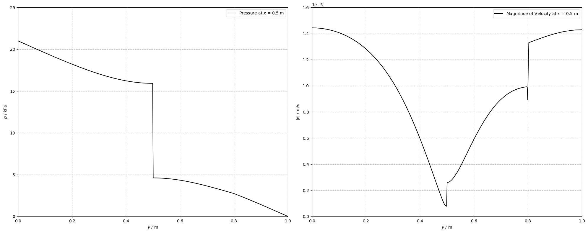

pvd_frac = vtuIO.PVDIO("fracture_block_conduct.pvd", dim=2)(click to toggle)
line_05 = [(0.5, i, 0) for i in np.linspace(start=0.0, stop=1.0, num=500)]
lines = {"@ x=0.5": line_05}
sns.set_palette("Paired", n_colors=10)(click to toggle)
x = np.linspace(0, 1, 500)
for _i, line in lines.items():
    velocity_x = pvd_frac.read_set_data(1, "v", pointsetarray=line).T[0]
    velocity_y = pvd_frac.read_set_data(1, "v", pointsetarray=line).T[1]
    pressure = (
        pvd_frac.read_set_data(1, "pressure", pointsetarray=line) / 1000.0
    )  # Converting pressure to kPa.
    velocity_magnitude = np.sqrt(velocity_x**2.0 + velocity_y**2.0)
    ax[0].plot(x, pressure, color="black", label="Pressure at $x$ = 0.5 m", ls="-")
    ax[0].axis(xmin=0.0, xmax=1.0)
    ax[0].axis(ymin=0.0, ymax=25)
    ax[0].grid(linestyle="dashed")
    ax[1].plot(
        x,
        velocity_magnitude,
        color="black",
        label="Magnitude of Velocity at $x$ = 0.5 m",
        ls="-",
    ax[1].axis(xmin=0.0, xmax=1.0)
    ax[1].axis(ymin=0.0, ymax=1.6e-5)
    ax[1].grid(linestyle="dashed")
    ax[0].legend()
    ax[0].set_xlabel("$y$ / m")
    ax[0].set_ylabel("$p$ / kPa")
    ax[1].legend()
    ax[1].set_xlabel("$y$ / m")
    ax[1].set_ylabel("$|v|$ / m/s")
Conclusion
The current benchmark example shows how blocking and conducting fractures affect liquid flow pattern. For this aim, a 2D domain with a blocking fracture in the center and a conducting fracture in the upper half of the domain is assessed. The data are provided in terms of pressure and velocity. The pore pressure exhibits a jump across the central blocking fracture, thus leading to a discontinuous pressure field. The conducting fracture facilitates fluid flow. Its effect can be seen in the symmetry break of the solution (without the conducting fracture, pressure and velocity fields would be symmetric). Strong velocity gradients are observed in the vicinity of both fractures.
