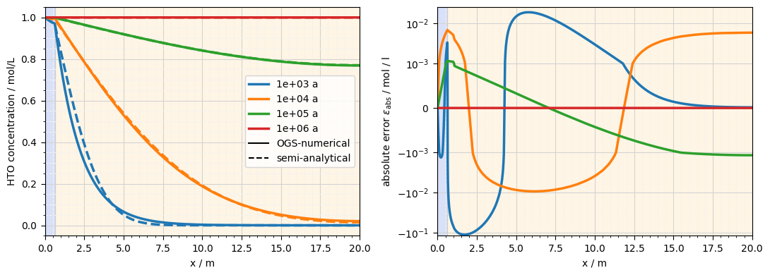

Here we provide a MATLAB script through which we can compute the concentration profiles along the two-layer domain. The following figure illustrates the concentration profiles at $t$ = 10$^3$, 10$^4$, 10$^5$, and 10$^6$ years (see calculated values in SemiAnalyticalSolutionResults.csv).

Numerical solution
Correspondingly, the OGS input files of this 1D mass transport benchmark can be found here.
Then, the numerical solution by OpenGeoSys is plotted against the semi-analytical solution for comparison.
# Run OGS simulation(click to toggle)
name = "1D_MultiLayerDiffusion"
Simulation: /var/lib/gitlab-runner/builds/vZ6vnZiU/0/ogs/build/release-all/Tests/Data/Parabolic/ComponentTransport/MultiLayerDiffusion/MultiLayerDiffusion/1D_MultiLayerDiffusion_modified.prj
Execution took 34.37271308898926 s
ms_MLD = ot.MeshSeries(out_dir / f"{name}.pvd").scale(time=("s", "a"))[1:](click to toggle)
HTO_var = ot.variables.Scalar("HTO", "mol/L", "mol/L", "HTO concentration")
fig = plot_results(ms_MLD, HTO_var)
In the first time step, the semi-analytical and numerical solutions do not agree so well. As the time step progresses, they begin to agree more closely.

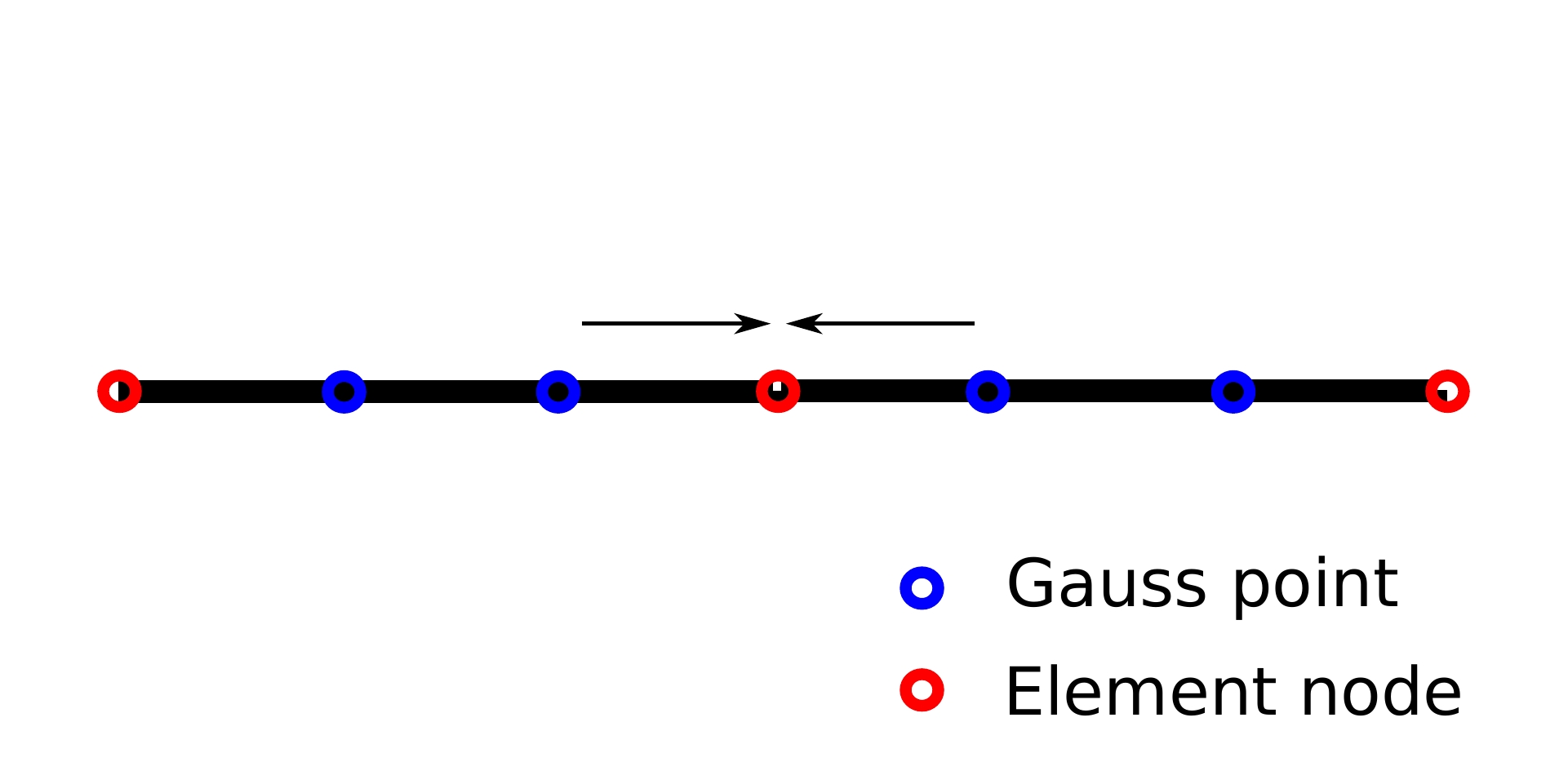

Mass flux calculation
Here is a sketch that shows how we calculate the molar flux at the node.
display(Image(filename="./sketch_molar_flux_calculation.jpg", width=100))
jpeg

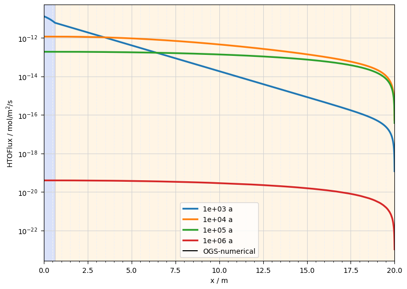

Additionally, we compute the molar flux profiles at $t$ = 10$^3$, 10$^4$, 10$^5$, and 10$^6$ years. The implementation of molar flux output can be viewed at this link.
HTO_flux_var = ot.variables.Scalar("HTOFlux", "mol/m$^2$/s")(click to toggle)
fig = plot_results(ms_MLD, HTO_flux_var)
fig.axes[0].set_yscale("log")
