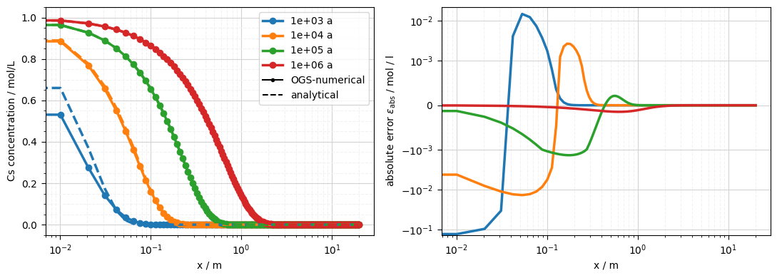

Numerical solution
Correspondingly, the OGS input files of this 1D mass transport model can be found here.
Then, the numerical solution of OpenGeoSys is plotted against the analytical solution for comparison.
# Run OGS simulation(click to toggle)
name = "1D_DiffusionSorptionDecay"
Simulation: /var/lib/gitlab-runner/builds/vZ6vnZiU/0/ogs/build/release-all/Tests/Data/Parabolic/ComponentTransport/DiffusionSorptionDecay/DiffusionSorptionDecay/1D_DiffusionSorptionDecay_modified.prj
Execution took 1.1953377723693848 s
ms_DSD = ot.MeshSeries(out_dir / f"{name}.pvd")[1:]
plot_results_and_errors(ms_DSD, c_diff_sorp_dec)
In the figure above, it can be seen that the numerical profiles and analytical solutions agree well at different times.

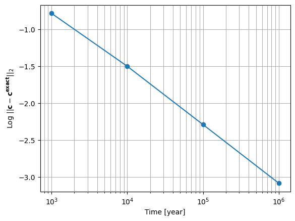

Error estimation
To evaluate the accuracy of numerical solution, the Euclidean norm of the approximate solution error $|| \mathbf{c} - \mathbf{c}^{\mathrm{exact}}||_{2} = \left(\sum\mathop{}_{\mkern-5mu i} |c_i - c_{i}^{\mathrm{exact}}|^2 \right)^{1/2}$ over the entire domain is calculated based on the exact analytical solution $\mathbf{c}^{\mathrm{exact}}$.
c_sim = ms_DSD.values("Cs")(click to toggle)
c_ref = c_diff_sorp_dec(ms_DSD[0].points[:, 0], ms_DSD.timevalues)
l2_norm_error = np.log10(np.sum((c_sim - c_ref) ** 2, axis=-1) ** 0.5)
np.testing.assert_array_less(l2_norm_error, -0.5)
fig, ax = plt.subplots()
ax.set_xlabel("Time [year]")
ax.set_ylabel(r"Log $||\mathbf{c}-\mathbf{c^{exact}}||_{2}$")
ax.semilogx(ms_DSD.timevalues / 86400 / 365.25, l2_norm_error, "-o", lw=1.5)
ax.grid(True, "both")
As the simulation time increases, the L$_2$ error norm decreases rapidly and evenually drops down to 10$^{-3}$.

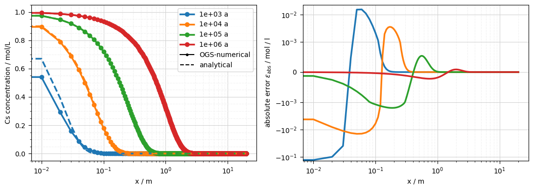

Numerical solution
Also, a 1D mass transport model is established. The corresponding OGS input files can be found here.
Then, the numerical solution is plotted against the analytical solution for comparison.
name = "AdvectionDiffusionSorptionDecay"
    input_file=f"../{name}/1D_{name}.prj", output_file=out_dir / f"{name}_modified.prj"
model.run_model(logfile=out_dir / "out.txt", args=f"-o {out_dir} -m ../{name}/")
Simulation: /var/lib/gitlab-runner/builds/vZ6vnZiU/0/ogs/build/release-all/Tests/Data/Parabolic/ComponentTransport/DiffusionSorptionDecay/DiffusionSorptionDecay/AdvectionDiffusionSorptionDecay_modified.prj
Execution took 8.791585445404053 s
ms_ADSD = ot.MeshSeries(out_dir / f"1D_{name}.pvd")[1:]
plot_results_and_errors(ms_ADSD, c_adv_diff_sorp_dec)
As shown in the figure above, the numerical and analytical solutions at different times reach in a good agreement.
