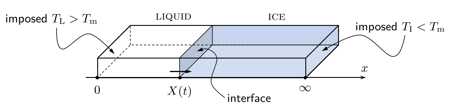

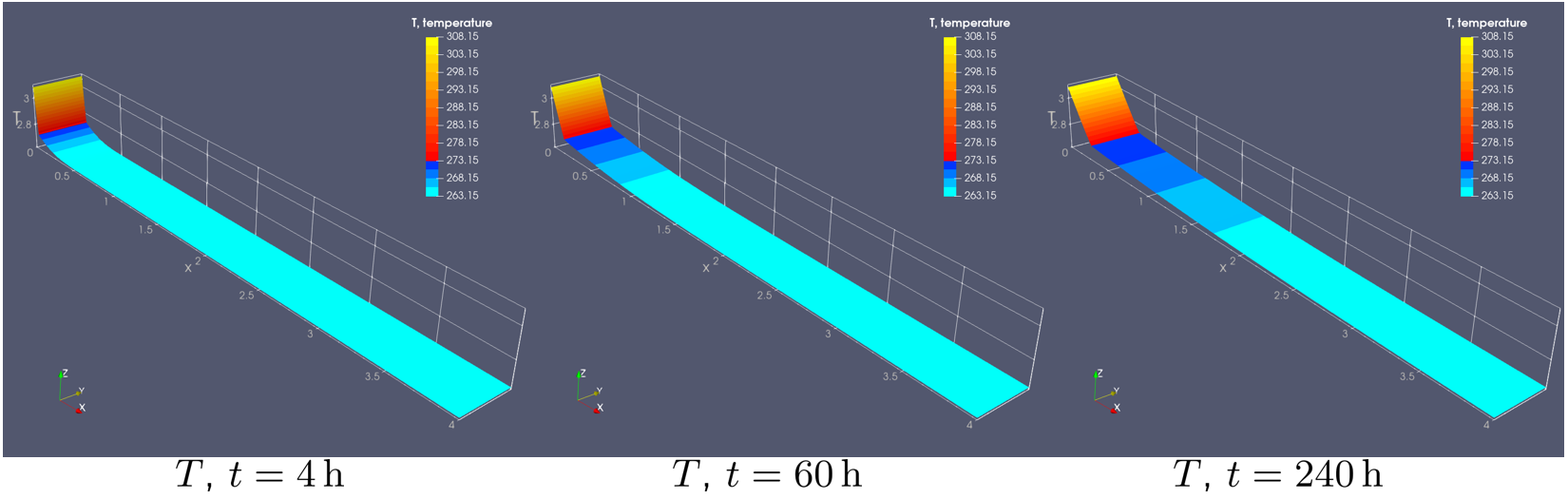

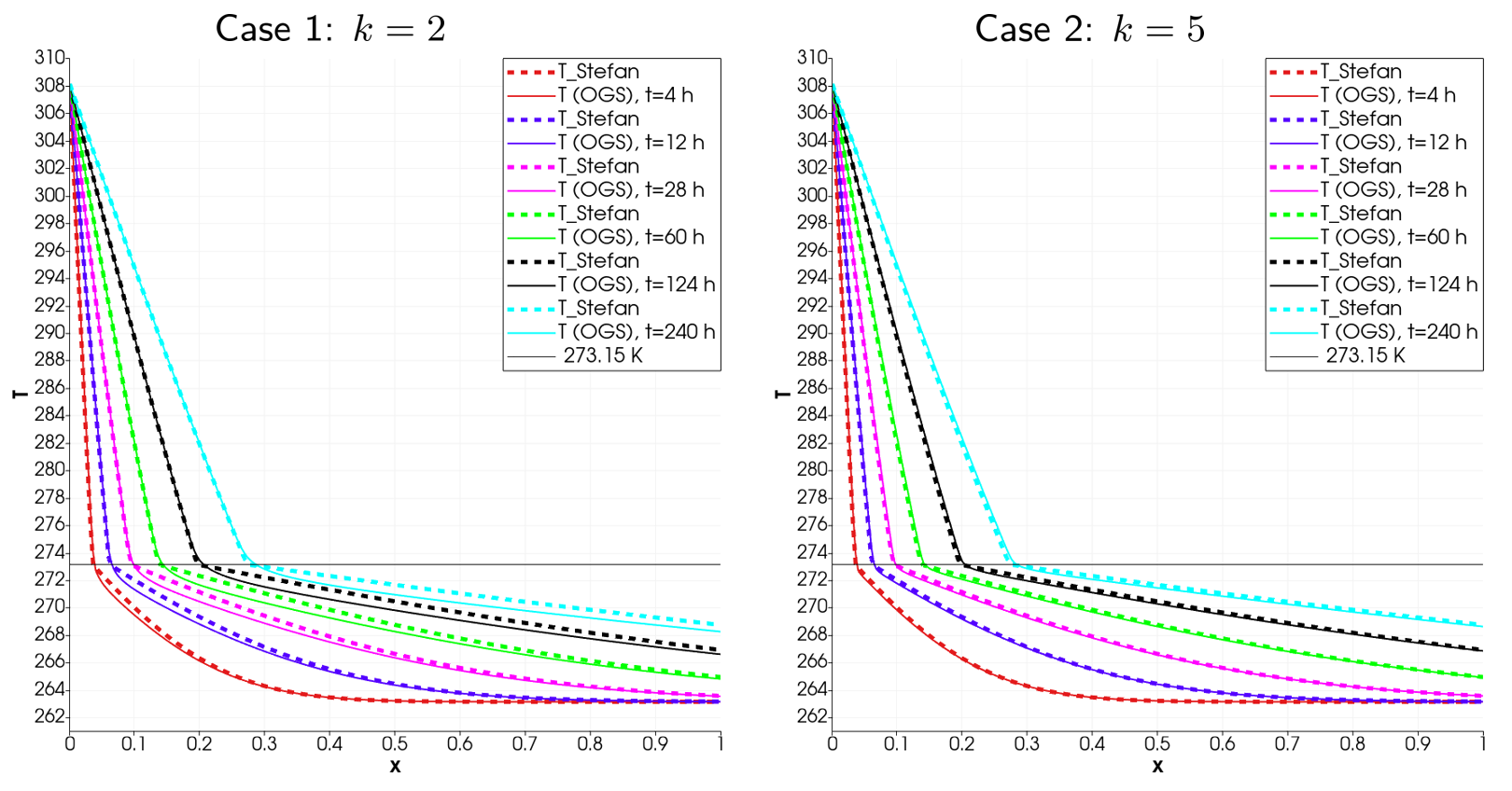

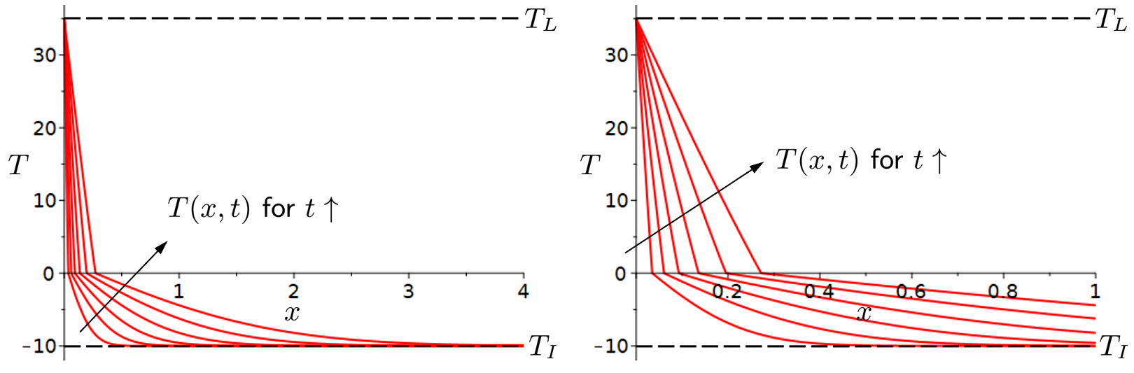

In this note, we consider the so-called two-phase Stefan problem which describes melting of a semi-infinite solid slab (in our case, an ice slab), and for which the closed-from analytical solution in $x\in(0,\infty)$ is available. We apply the IBVP for our T+freezing equation – with the porosity $\phi$ being set to 1 – to model such melting process and solve the problem in OpenGeoSys (OGS-6). This is done in a relatively large but finite spatial interval by extracting the initial condition, as well as the Dirichlet boundary conditions from the reference analytical data. The results obtained in this interval at various time-steps for the two modeling approaches are compared.
The detailed Stefan problem description, geometric setup, material and model parameters used in the related OGS implementation can be found in this document this PDF. The figures below are taken from this documentation and serve for illustrative purposes to give a hint about the modeled process and simulations outcome.
