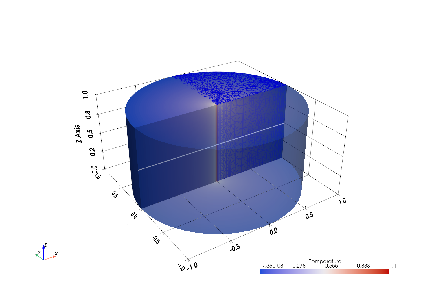

The Poisson equation on cylindrical domain of height $1$ and radius $r=1$ is solved. In the following figure the geometry, partly semi-transparent, is sketched. Furthermore, the mesh resolution is shown in the cylindrical domain within the first quadrant of the coordinate system. In the second quadrant the simulated temperature distribution is depicted.

The source term is defined along the line in the center of the cylinder:
$$ \begin{equation} Q(x) = 1 \quad \text{at } x=0, y=0. \end{equation} $$
In the above figure the source term is the red vertical line in the origin of the coordinate system.

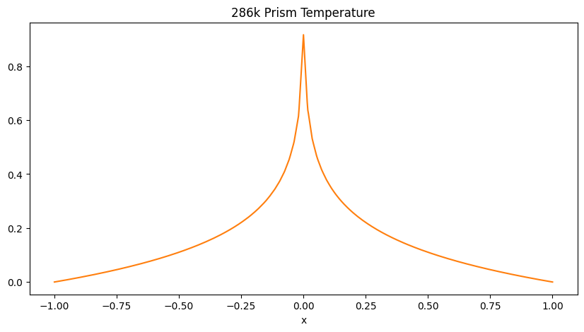

The following plot shows the temperature along the white line in the figure above.
# Extract values along a line in the domain(click to toggle)
# Load results
pvdfile_286k = vtuIO.PVDIO(f"{out_dir}/3D_line_source_term_in_cylinder_286k.pvd", dim=3)
# Get point field names
fields = pvdfile_286k.get_point_field_names()
# Extract values along line
number_of_subdivisions = 801
length = np.linspace(-1, 1, number_of_subdivisions)
z_axis = [(i, 0, 0.5) for i in length]
# Extract timestep
timestep = 1
temp_286k = pvdfile_286k.read_set_data(timestep, "temperature", pointsetarray=z_axis)
# Plot
fig, ax = plt.subplots(1, 1, figsize=(10, 5), sharey=True)
ax.plot(length, temp_286k, label="286k prism", color="tab:orange")
ax.set_title("286k Prism Temperature")
ax.set_xlabel("x")

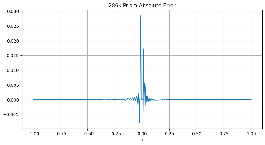

The differences of analytical and computed solution are small outside of the center.
# Combine analytical solution with numerical solution at singularity in (x,y)=(0,0)(click to toggle)
# Create reference for error calculation
# Replace 0 with 1 to prevent division by 0, the respective element will be replaced with the numerical solution anyway
length_replaced = length.copy()
length_replaced[int((number_of_subdivisions - 1) / 2)] = 1
# Replace diverging analytical solution in respective interval below a threshold of 0.01
threshold = 0.01
below_threshold = np.where(np.abs(length) < threshold)
analytical286 = t_analytical(length_replaced, 0)
analytical286[below_threshold[0][0] : (below_threshold[0][-1] + 1)] = temp_286k[
# Plot absolute error
abs_error286 = temp_286k - analytical286
ax.plot(length, abs_error286)
ax.grid(True)
ax.set_title("286k Prism Absolute Error")
ax.set_xlabel("x")

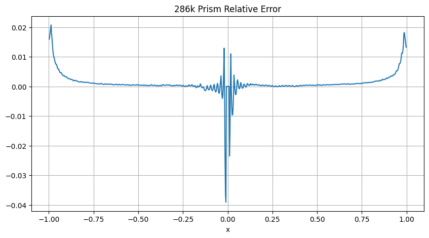

Due to the numerical evaluation of the relative error of the computed solution the error grows in the vicinity of the boundary and in the center.
# Relative error(click to toggle)
# Relative error
fig, ax = plt.subplots(1, 1, figsize=(10, 5))
rel_error286 = (analytical286[1:-1] - temp_286k[1:-1]) / analytical286[1:-1]
ax.plot(length[1:-1], rel_error286)
ax.grid(True)
ax.set_title("286k Prism Relative Error")
ax.set_xlabel("x")

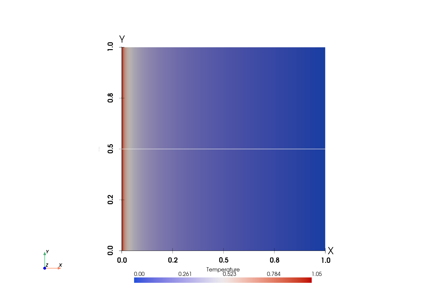

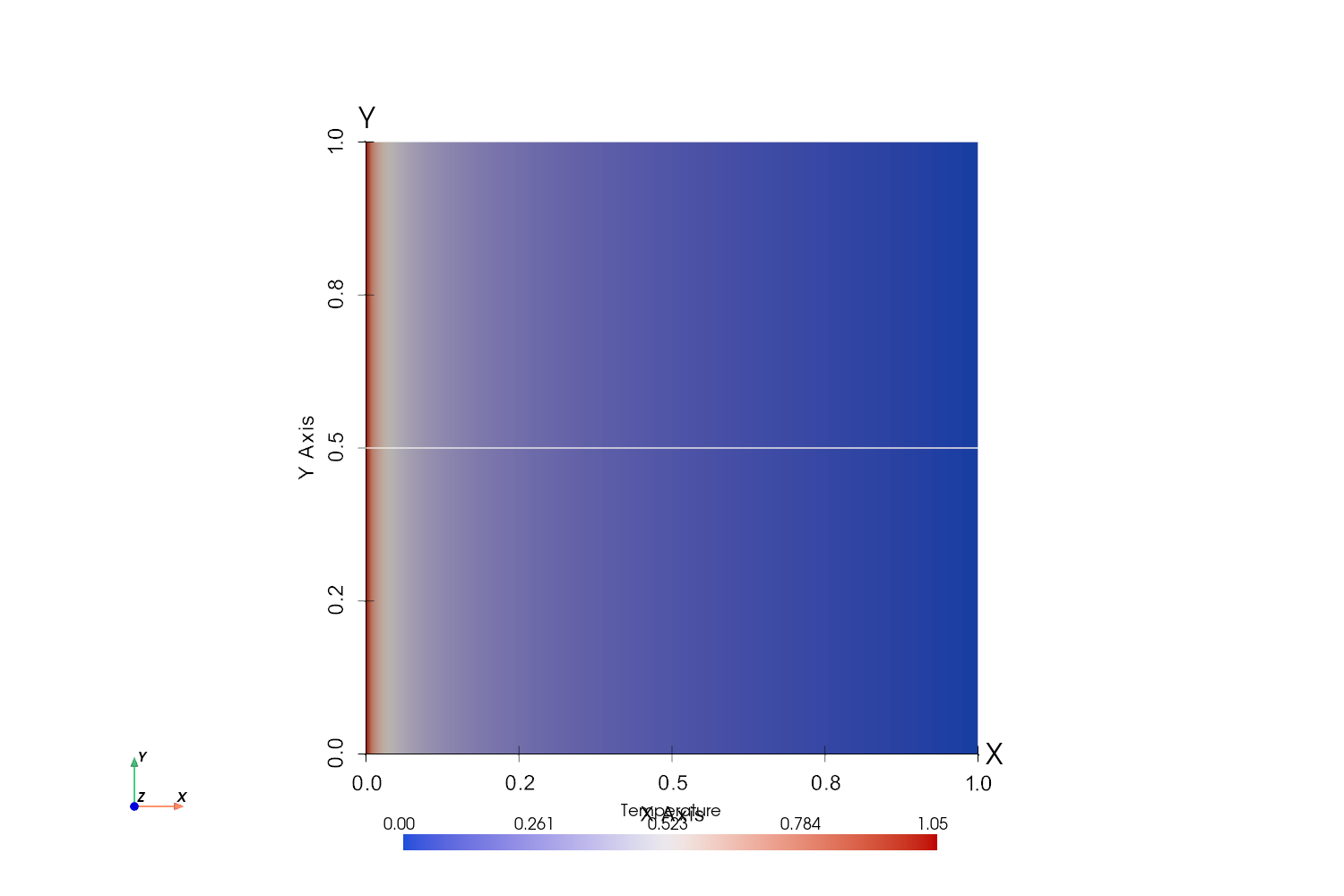

The above figure shows the computed temperature distribution.

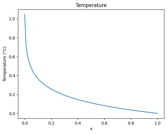

pvdfile_ax = vtuIO.PVDIO(f"{out_dir}/3D_line_source_term_in_cylinder.pvd", dim=3)(click to toggle)
# Space axis for plotting
length = np.linspace(0, 1, 101)
z_axis = [(i, 0.5, 0) for i in length]
timestep = 1
temp_ax = pvdfile_ax.read_set_data(timestep, "temperature", pointsetarray=z_axis)
plt.plot(length, temp_ax)
plt.title("Temperature")
plt.xlabel("x")
plt.ylabel("Temperature (°C)")

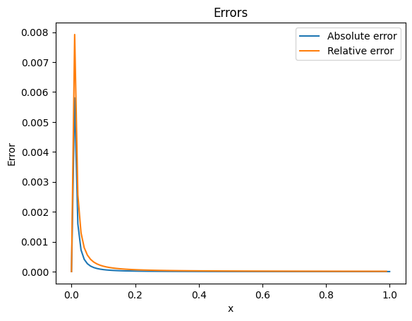

The error and relative error shows the same behaviour like in the simulation models above. Outside of the center, that has a singularity in the analytical solution, the errors decreases very fast.
# Create the reference temperature and combine analytical solution with numerical solution at singularity in (x,y)=(0,0)(click to toggle)
t_ref = t_analytical(length[1:], 0)
t_ref = np.insert(t_ref, 0, temp_ax[0])
plt.plot(length, t_ref - temp_ax, label="Absolute error")
plt.plot(length[:-1], (t_ref[:-1] - temp_ax[:-1]) / t_ref[:-1], label="Relative error")
plt.title("Errors")
plt.ylabel("Error")
plt.xlabel("x")
plt.legend()
