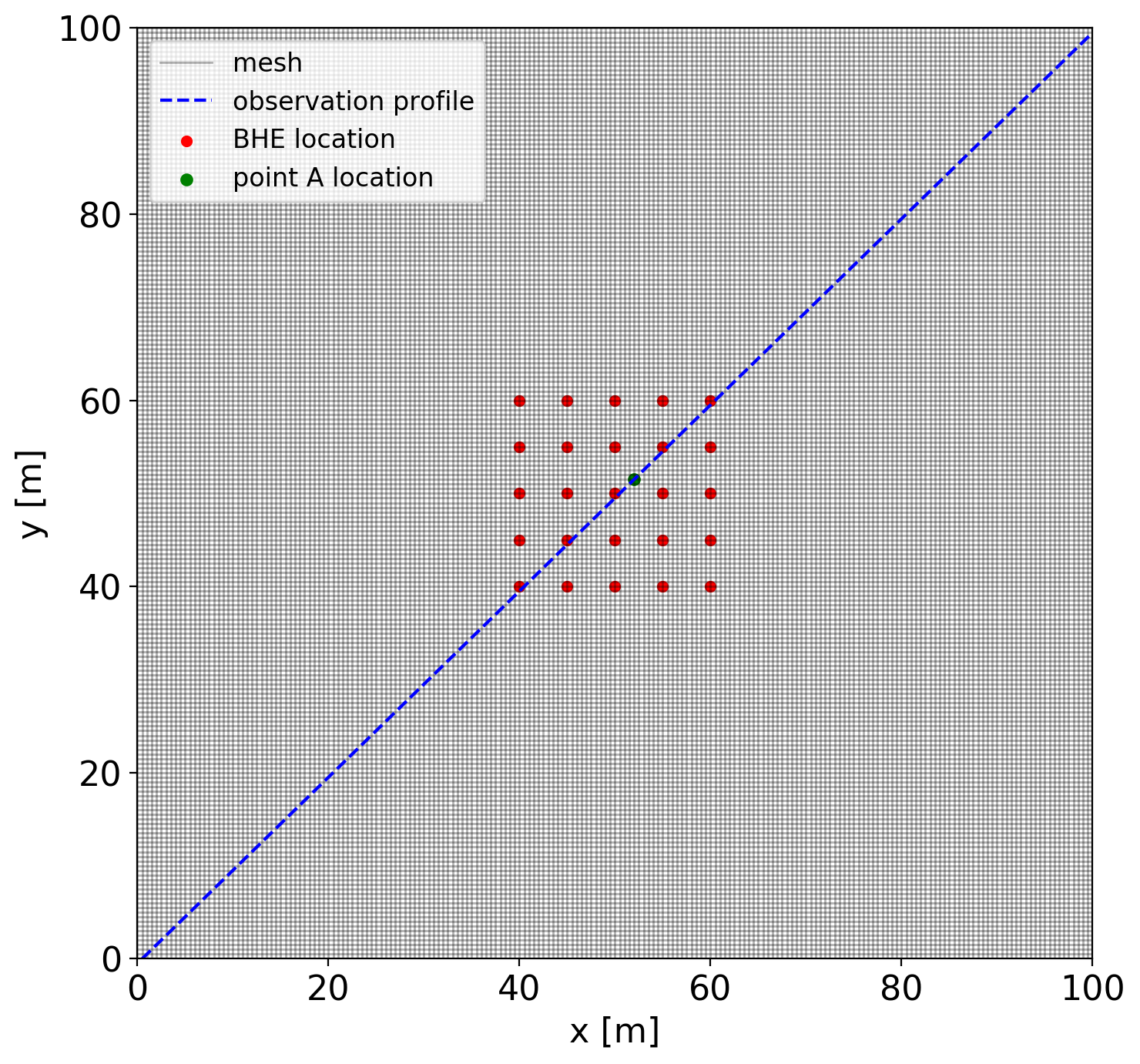

A 2D numerical model was constructed and simulated with the Finite element code OpenGeoSys (OGS). The subsurface was represented by a $100 \times 100~m$ square-shaped domain, inside of which 25 BHEs were installed (cf. Figure 1). The distance between adjacent BHEs is kept at 5 m. The ground temperature variation caused by the operation of the BHE array was simulated over a three years’ period. In the model, a 4-month heating period is assumed every year from January to April, with a constant heat extraction rate of 35 W/m on each BHE. In the rest months, the BHE system is shut down and no heat extraction was imposed. The parameters applied in the numerical model can be found in the table below.
In this model, the quad element was adopted to compose the mesh. The initial temperature of the model domain is set to 10 $^{\circ}$C. For the need of modelling a fixed 10 $^{\circ}$C temperature boundary condition was imposed at coordinate (0 m, 0 m). In the model domain, the locations of the BHEs are identified as red dots as in Figure 1. On each of these points, a sink term was specified in the numerical model, with the specific heat extraction rate as listed in the following table.

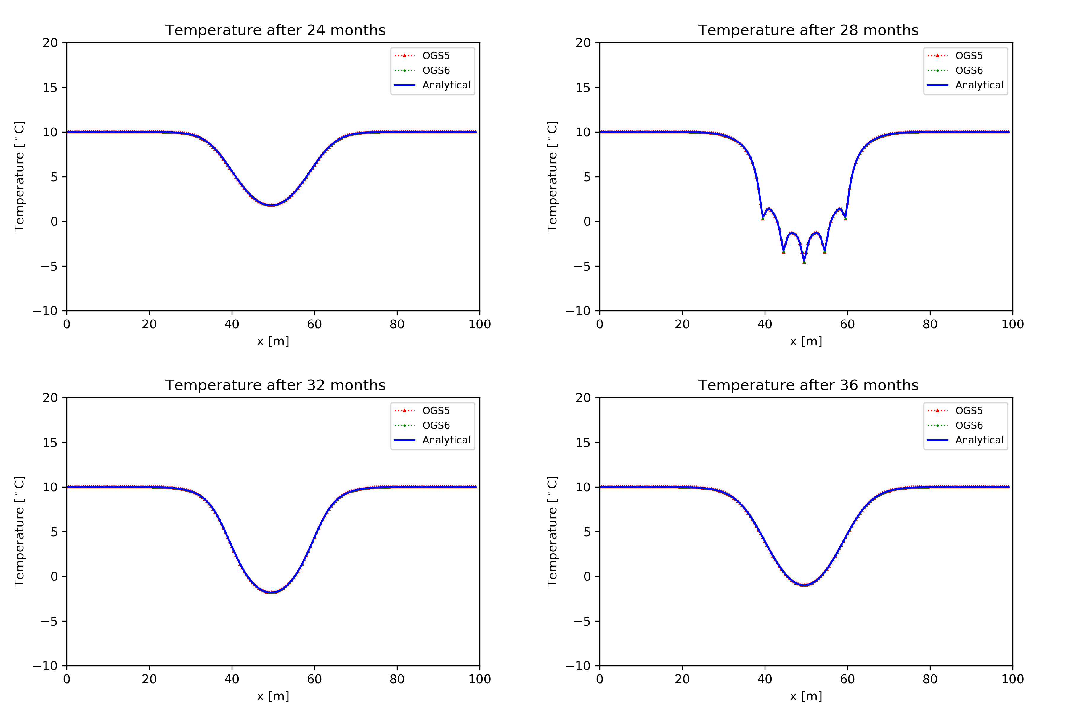

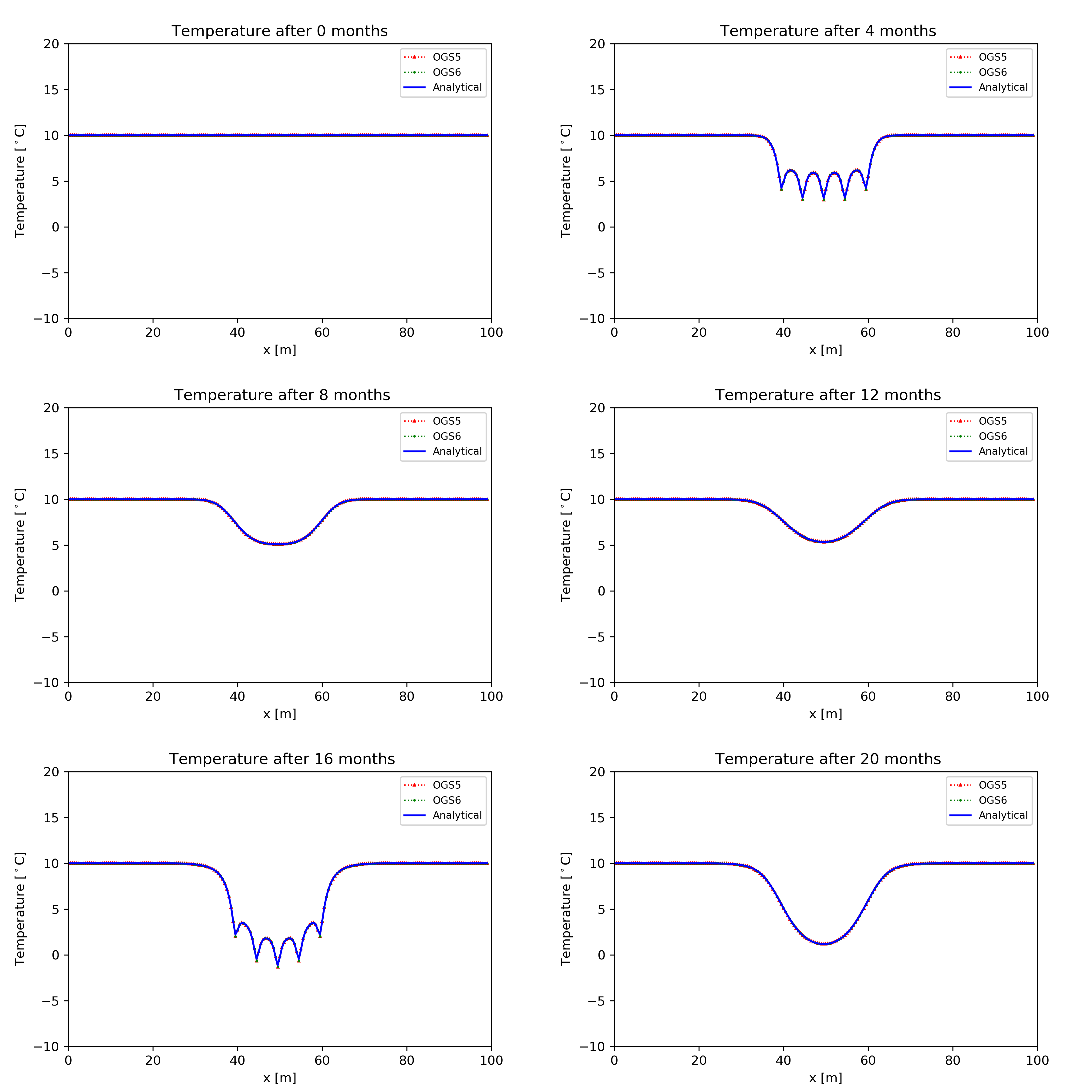

Figure 2 and 3 show the comparison of the temperature distribution along the observation profile (position see Figure 1) using analytical solution with the numerical results from OGS-5 and OGS-6 for every 4 months in the whole simulated time. It shows the numerical solution has a very good agreement with the analytical solution.

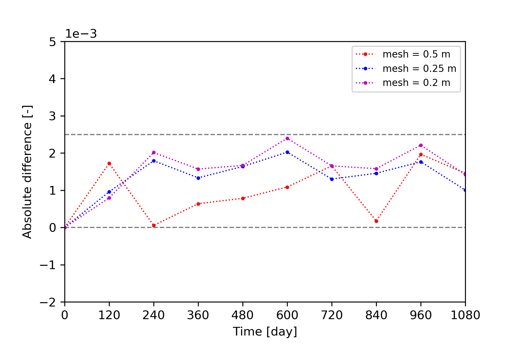

In order to investigate the impact of mesh density on the accuracy of numerical result, the simulated temperature profile at the observation point A (53 m, 52.5 m) was plotted and compared against the analytical solution. Figure 3 shows the relative difference of the computed temperature between the analytical and numerical solution by using different mesh size (2.5 m, 1 m, 0.5 m, 0.25 m and 0.2 m). The results show that the difference becomes smaller when the mesh size is approaching 0.5 m, which is expected as the optimal mesh size mentioned in Diersch et al. (2011). From Figure 4, it can be found that the absolute error of temperature values at point A should be less than 2.5e-3 if the mesh size is kept denser than 0.5m.

The absolute difference of computed temperature along the diagonal profile between the analytical and numerical solution using different mesh size
